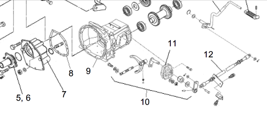

I'm looking to inspect/remove/repair the shuttle gear fork but have never done one of these. Here is a diagram.
Item 13 moves until it stops in both directions. I've adjusted the shift cable several times, even did some grinding on the top handle to allow the shifter more travel.
Temporary fixes. When in gear "all the way" it stays in and doesn't miss a beat. But it doesn't seem to be going in all the way.
Pretty sure the fork (#10) is worn, slipping, bent, liquified, or on fire! No idea, but it seems that if I remove Plate #1, I can access the area to inspect.

The issue I see is that to replace the fork the shafter will need to be removed and will have to slide most if not all the way out of the case. The picture you provided 8s not detailed enough to see what else will need to be removed yo accomplish this. The other possibility is he link that engages the fork beeing worn, the would be a fairly easy fix from the look of it. I would remove the cover and attempt to determine which part is worn/damaged. Additional possibilities include worn dog teeth on the shift sleeve or gears let's hope that is not it! :eek:

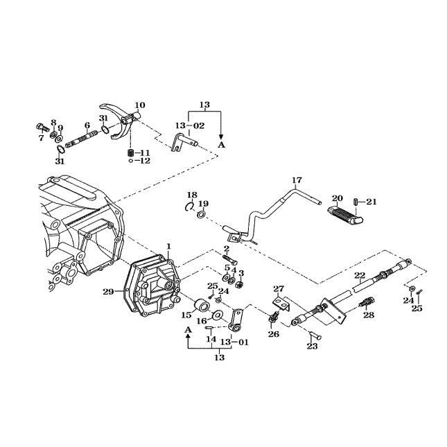

You say the shaft would have to be removed to replace the fork? Sorry, but I really don't have a good idea what it's going to look like until I get in there...new to me.
Maybe this zoomed drawing will help? I'm suspecting Group 10. See the fork? Maybe?
Sorry, not sure why the forum is making all my pics REALLY small? Hopefully it will open bigger.

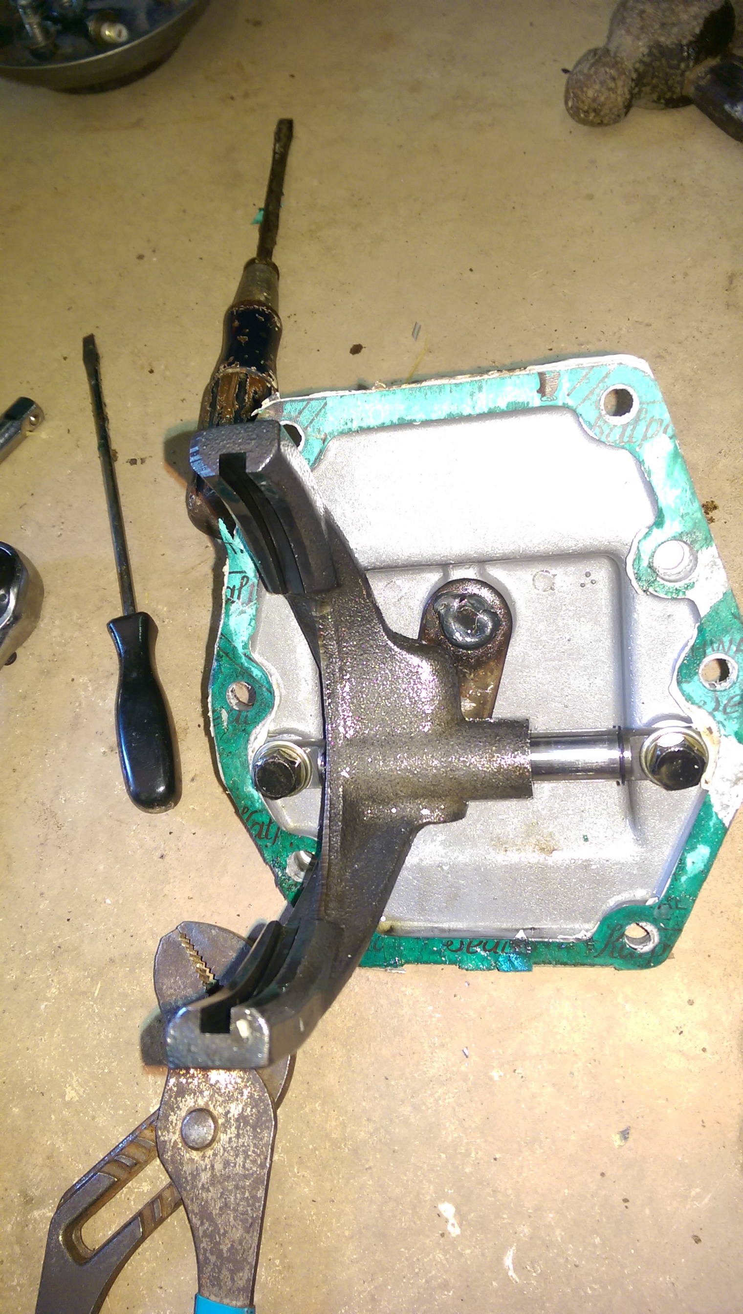

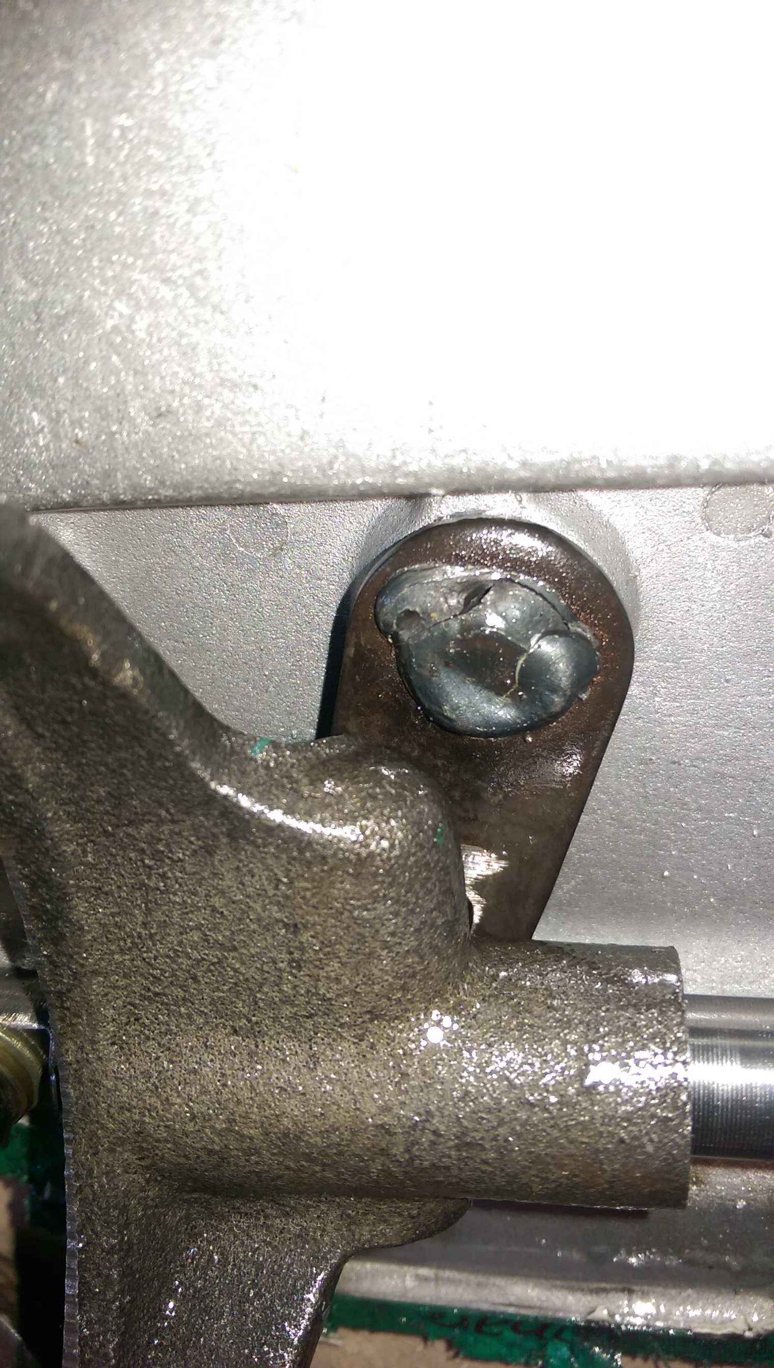

Found crappy weld inside the inspection plate. Going to fabricate a different setup and reweld.
