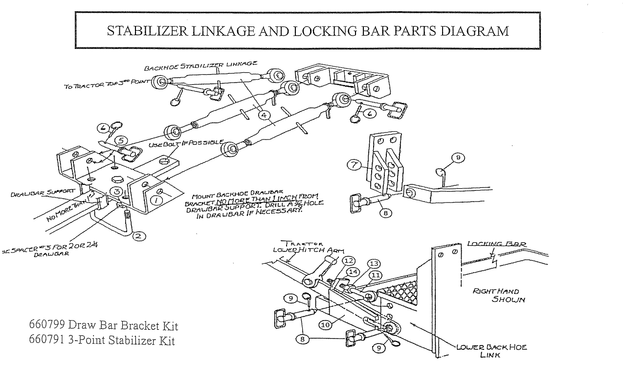

I don't have a picture, but my 3pt backhoe has the normal 3pt hookup, plus a heavy plate mounted sideways on drawbar (the hitch sitting under the back of the tractor that sticks out with a hole in end). There are two adjustable links that go from same area as toplink but instead of going to toplink connection on tractor, they go down diagonally and connect to the plate at the bottom of the tractor..
Page 16 of this manual (http://www.koykermfg.com/images/koyker-manuals/archived/kb600-102505.pdf
