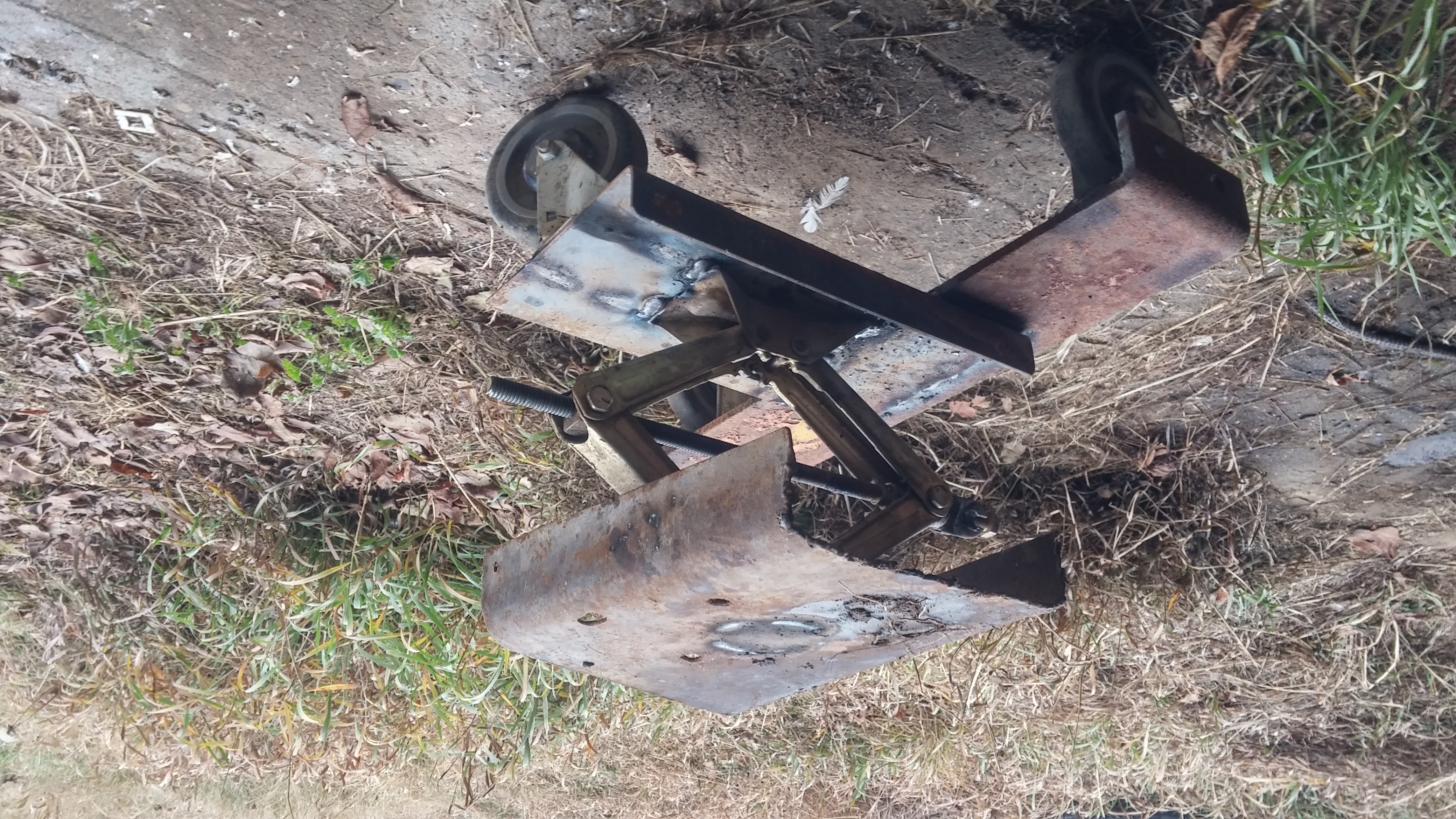

My imagination went into build mode again .I have a transmission to change in my pickup so I decided to build a jack .No test run yet so will wait and see how it works out .

Your picture comes up alright. I like the idea of the hex bolt on the end of the screw.
How does it tilt? Tranny jacks need to tilt two ways.

It was a spontaneous build ,no tilt was planned , if I get lucky it will have enough flex where the top rotates for the tilt

Couple wood shims pushed in under the trans pan will tilt it , I am spontaneous also. I like it , sure beats dragging in up on your chest and knees and working it up there.

YEP!! That's nothing you can't cure with some wooden shingles and a couple of ratchet straps

Thanks for the compliments . I lost the ability to wrestle it by hand about30 yrs ago.
