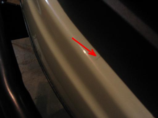

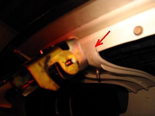

There's a nice size stress crack started on the front of my GT2554 around the latch area of the "high-impact" ABS hood and apparently its been getting worse. The only reason that I finally noticed it was because the crack has finally migrated to the outside front edge where it's visible (see 1st pic). I've never hit anything with the tractor and to be honest I'm not real sure that it wasn't initially there when I bought it since there was other damage done to it during shipping as well.
I only have 42hrs on this tractor and it's less than 1 year/mowing season old. I'm sure if I left it go for this upcoming mowing season it will crack completely thru to the bottom.
Any input would be appreciated!!
Thanks
Troy

I am sure Cub would cover that under warranty.
   / Should this be cover under warranty? #3
I had a crack similar to that on my ( plastic cowl/hood ) and I sanded it and epoxied it and it was gone. It happens when your tractor goes over uneven ground, it flexes and twist and thats what causes it.
If your dealer does replace it, it will happen again.
I'm sorry to give you the sad news but they will flex and twist, cars and trucks do it all the time.

It should be covered under warranty. There was a recall/service bulletin out for the 2006 year 2500 hood latch: the mounting of the latch would slowly fail, allowing the hood's closed position to slowly become higher and higher. This could eventually lead to the exhaust being partially covered by the hood, and possibly melting. I don't know whether Cub's solution was a redesigned latch, a redesigned mounting configuration, or both. But in my case my dealer replaced the hood and latch even though there were no signs of wear. And yes, this was covered under warranty.

The wonders of plastic hoods and why everyone uses them. Sure scratches in them don't rust. Yet it is a rare occurrance to see a used lawn/garden tractor out there with a plastic or fiberglass hood that doesn't have a crack or break or two in it somewhere. Give me metal with a few rusted scratches any day (Ok, those days are long gone, I know, back to reality.)
I'm sure Cub will replace that cracked hood under warranty. BTW, how have you made out with that lifter noise problem TJ? -Fordlords-

Hopefully you can get it replaced under warranty. If not, the secret to stopping any crack (plastic or metal) from speading is to drill a small hole at each end of the crack. That will relieve the stress and stop the crack. You can then choose some way to repair it.

Ya know I would have done that if I would have cought it sooner....
The Cub dealer is ordering the replacement hood for me tomorrow, so it's all good. I'm really glad to see that CC stands behind thier machines.
