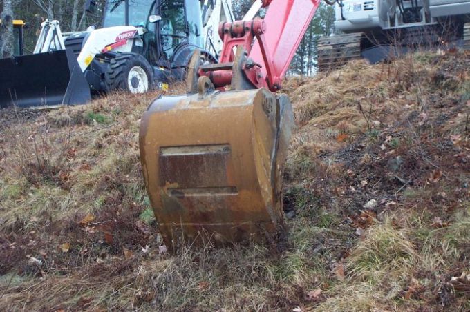

I stopped the other day when driving by an equipment dealer & snapped this pic. This is what I'm thinking of doing on a smaller scale. It'll be interesting to hear what other TBN'rs have & use....

Hi Eric
That looks heavy duty enough to do some serious lifting. Are you considering a hook or an eye? I did a quick search and found this site for weldable hooks.
1st Chain Supply Weldable hooks
Tom

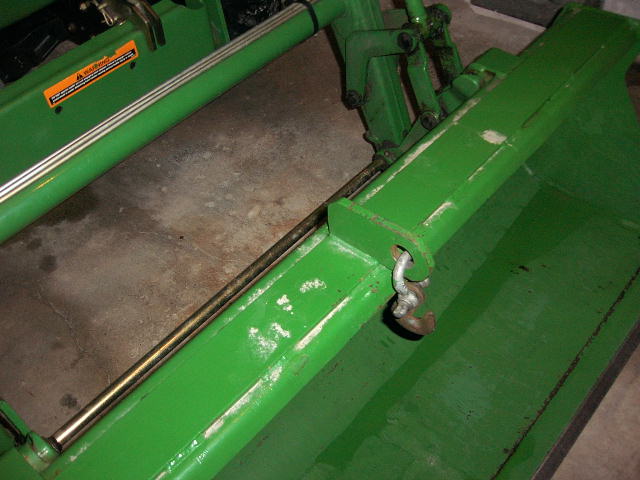

   / Should I weld clevis hook on 48 BH bucket?? #7
I'm thinking "eye". I then would hook a shackle thru the eye & that would give me a chain/cable hook or what have you ??
   / Should I weld clevis hook on 48 BH bucket?? #8
Yes. I tried to post a picture of my loader.
Richard
#9
I like the setup. Looks like you can change it to fit what you need. Did you weld a bar across the flat top of the FEL before you welded the hook?
   / Should I weld clevis hook on 48 BH bucket?? #10
Yes. Flat bar, I think 5" x 60" x 1/4 or 3/8.
Richard
