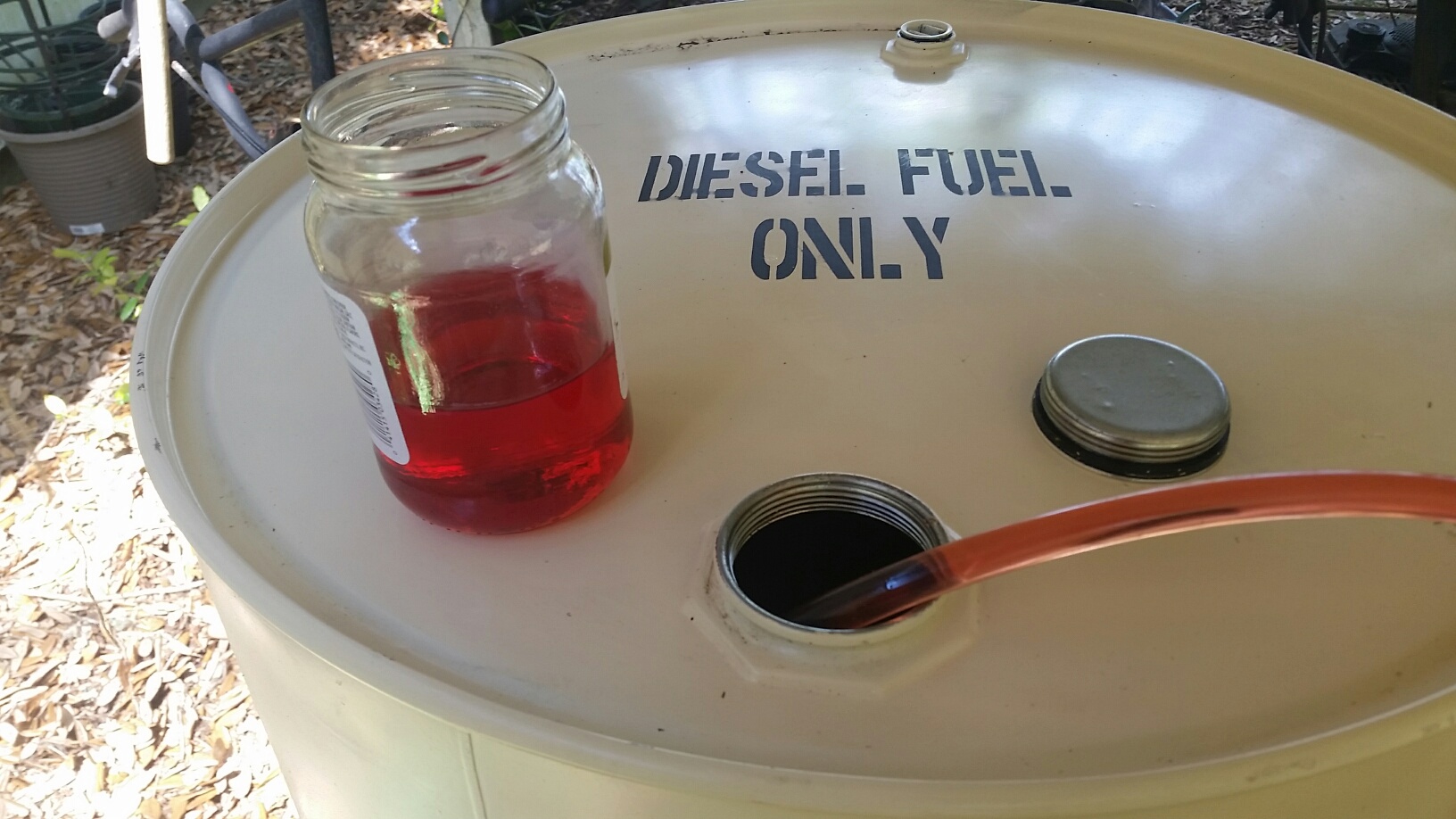

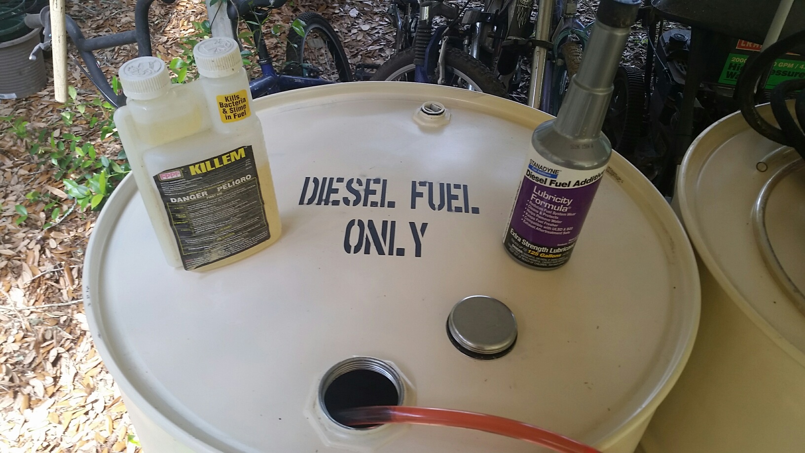

I bought a couple of 55 gal oil drums to store diesel fuel in. They have the typical 2 inch bung and 3/4 inch vent holes with caps. I'm thinking it might be a good idea to keep them vented to prevent expansion and contraction. Ordered a couple of compressor filter silencers with 3/4 male fittings. The drums will be stored outside under a shed. They will get damp from dew and blowing rain. Should I leave them vented or just put the vent in when they are in use?
What are your opinions or knowledge on this? Will keeping it vented promote or reduce condensation in the drums?
The plan on these is to purchase 100 gallons of off road diesel to have on hand and use. I purchased a military surplus diesel generator that is equipped with an auxiliary fuel supply system. It has a bung adapter and pickup tube that fits the large hole in the drums. A secondary fuel pump and float switch senses when the tank drops below a certain level and pumps fuel from the drum to the generator tank. I figure I will use fuel from the drums in my tractor and backhoe to keep it rotated and fresh.
