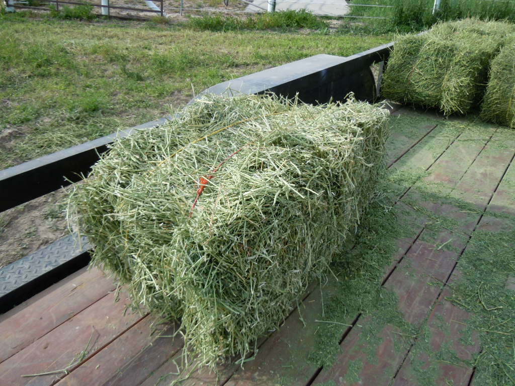

I agree with all of this;
I grow my own hay because I enjoy it. Total cost for me last year was 70 grand to get set up. That includes a new tractor and the barn in my avatar. The rest of my equipment is old and needed a little work but everything works great at this point. I could have bought hay for a couple lifetimes for that much money. But, it is so satisfying to watch the hay grow and the equipment work. I don't plan on stopping anytime soon. You'll have to look at your situation and see if you feel the same.
That little ugly bale is the first one I ever grew, cut and baled with my own equipment. Still makes me smile.:)
