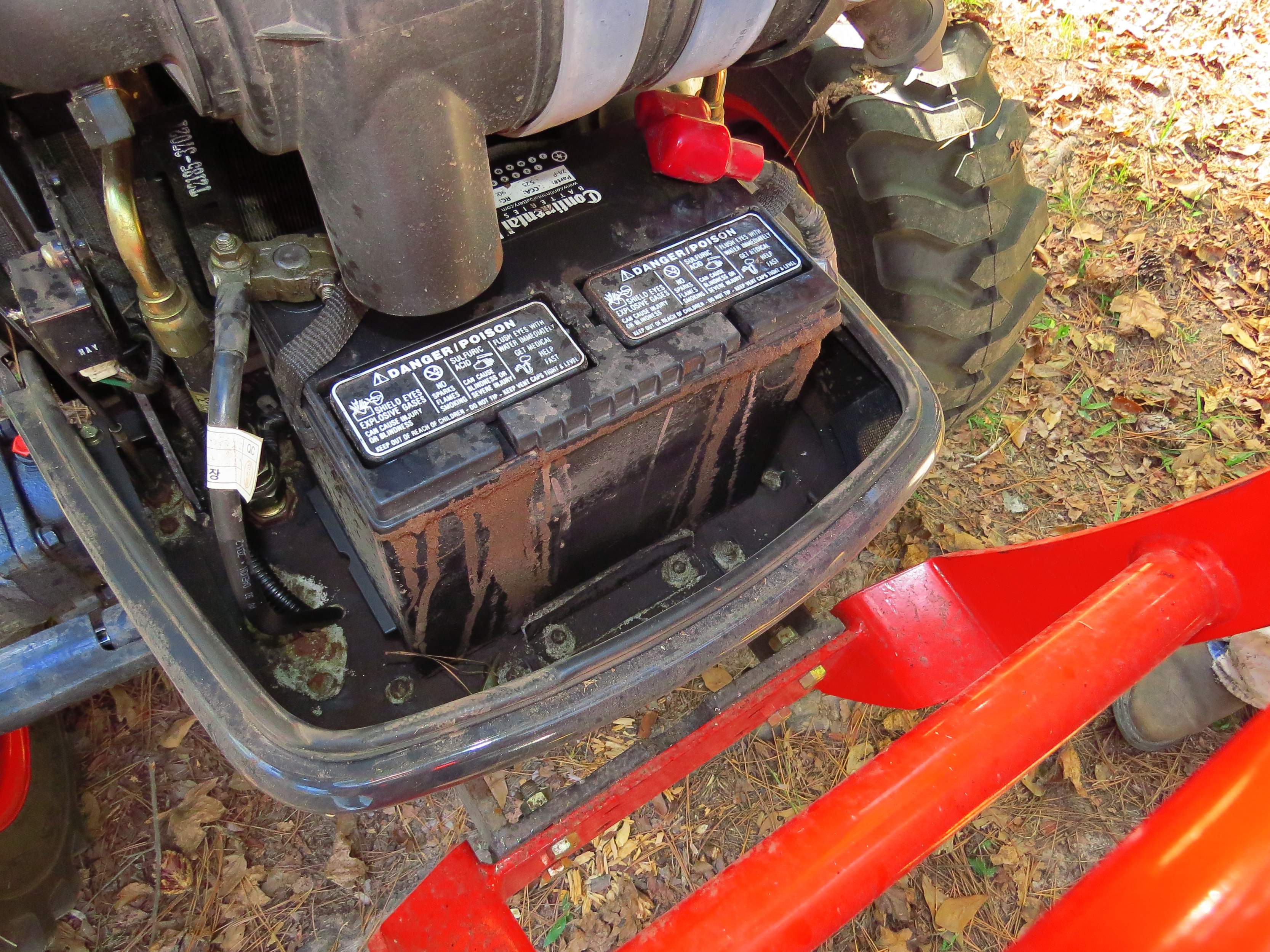

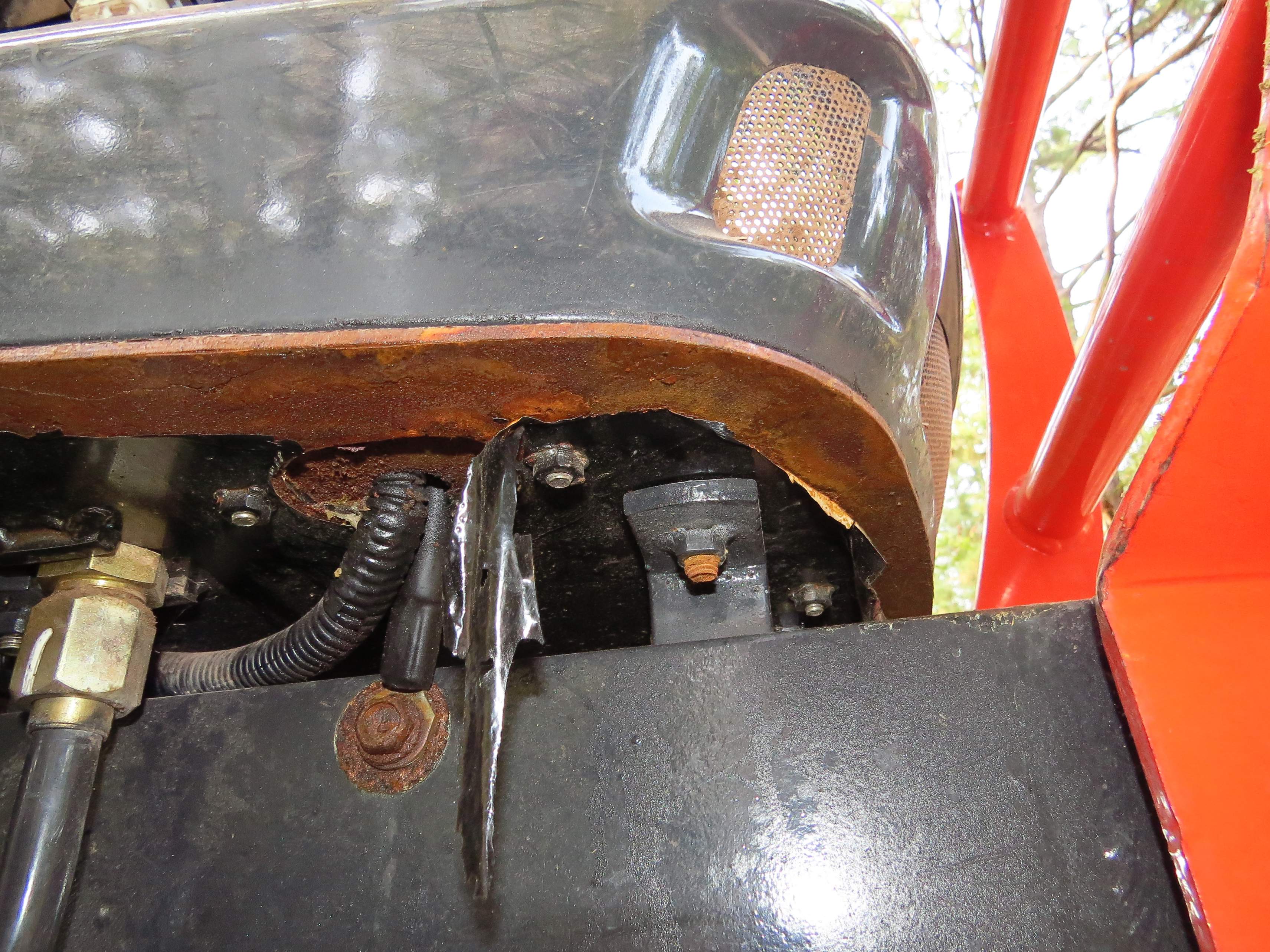

Hi...I wanted to run this by everyone. My tractor is just under 3 months old and about a week and a half ago I noticed corrosion in the battery compartment and underneath the front of the tractor. I sprayed the whole area with WD40, almost a whole can. The acid leak wasn't very noticeable until after I used the tractor for a while and the dust stuck to the acid leaking from a seam at the top of the battery. I took photos a week later (this past weekend) when I had my camera so I could show it to the dealer. My neighbor by my property as well as friends told me the dealer needs to come and get the tractor and make everything right. So I went to the dealer and showed him the photos and he said there's nothing he could do except replace the battery if I bring him the old one. I wasn't expecting that response. He also told me "no manufacturer or dealer would cover damage caused by a leaking battery" and gave me the impression of why didn't I catch this leak sooner. I told him I caught pretty soon being the tractor is 2 3/4 months old and that the battery is the least of my concerns...It's all the damage it caused. I don't even want their battery. I'll research and find a really good one to put in there. I remember when I bought the tractor how the dealer told me about Kioti having one of the best "bumper to Bumper" warranties out there (sucker born every minute?). I'm hoping you guys could tell me what you think? Should they cover this even though it's pretty clear to me they won't? Do you think John Deere or Kubota would have taken care of me had I bought one of them? I really appreciate everyone here. I'm new to tractors by the way and this is my first one. Thank you for reading.

Unless there is a design flaw on the tractor that caused the battery to leak, I would not expect the dealer to do anything about the damage a faulty battery caused other than replace it. I would get it cleaned up and stopped if I were you and perhaps ask for touch-up paint.

Clean-up with Backing soda and water. Replace battery and start up let run 5 minutes and check voltage while running. If still charging at 13.5 and above your VR is stuck and you need a new alternator.

Yep, after cleaning, touch up the paint also before replacing the battery. Then do the checks Murph recommends, and replace alternator if needed. All things the dealer should be doing...

murphy1244 and GolfAddict, I really appreciate the advice! I read about baking soda on here...But I bought a can of CRC Battery Cleaner at the auto parts store thinking that would be better? And soak everything really good. It says it neutralizes the acid but I have baking soda too. I'll borrow a voltage meter and do as you guys told me.
