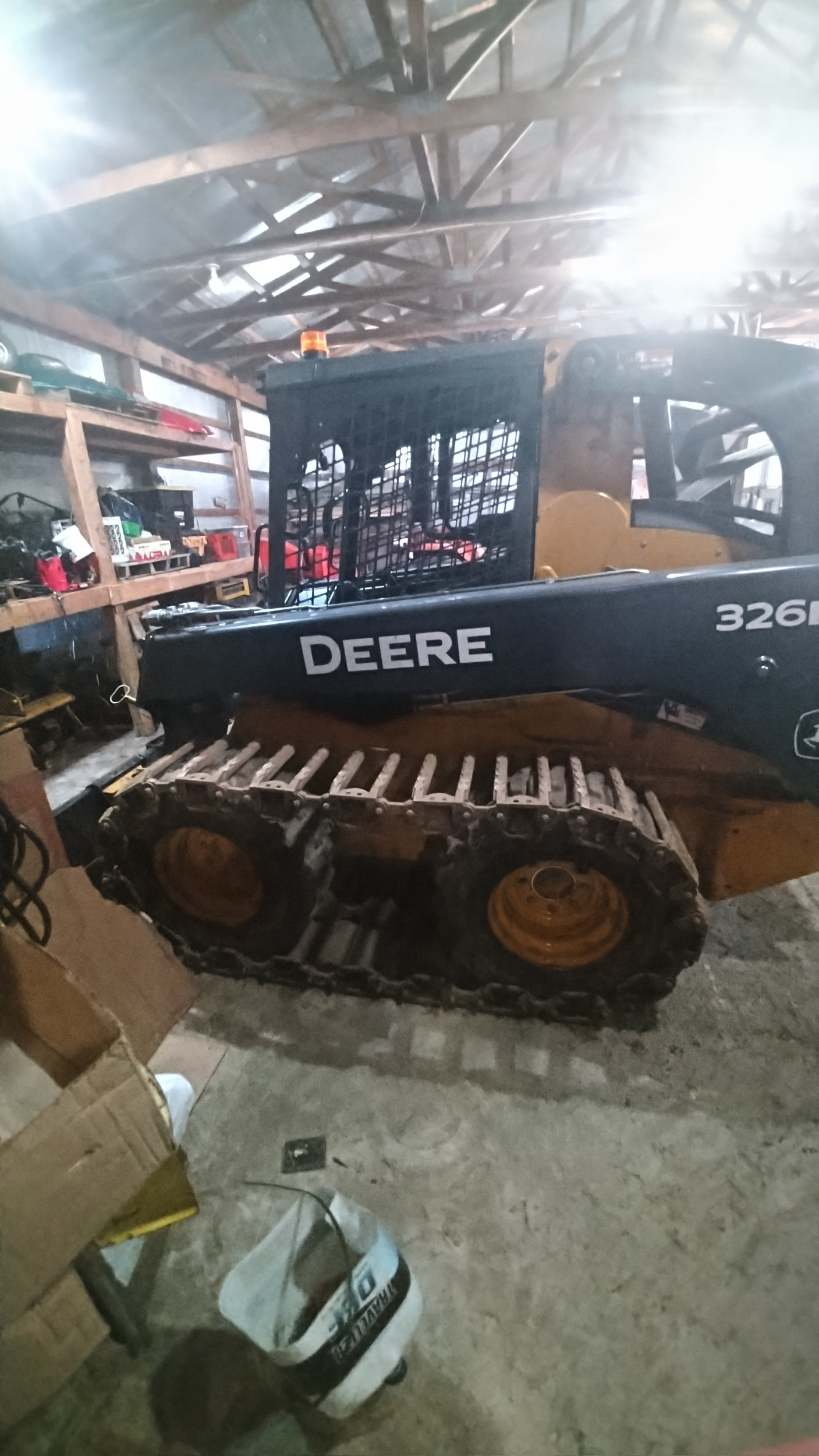

Imo if your going to use the skid steer to clean up a clearcut get a bigger wheeled one with steel tracks. I use a 2013 jd 326e a lot with steel tracks no problems with dpf but it definitely does a little worse on fuel consumption compared to a non tier IV 75hp ctl. Driving a ctl in the woods is really hard on dedicated ctls undercarriages and rubber tracks in my experience.
