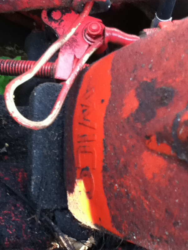

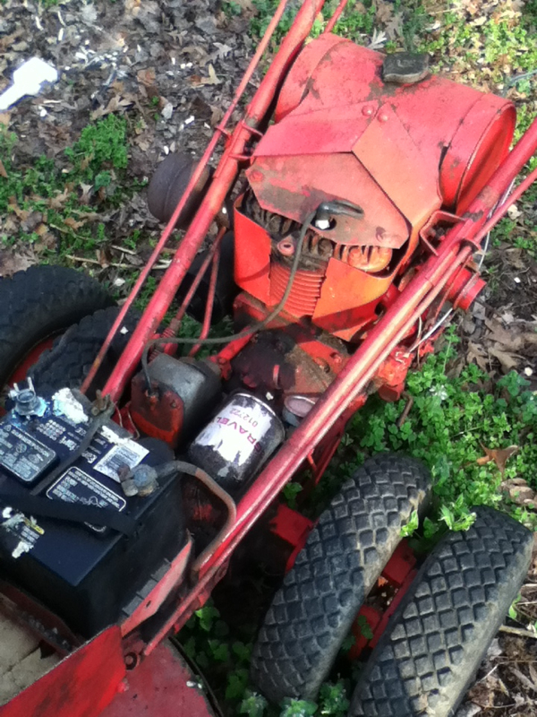

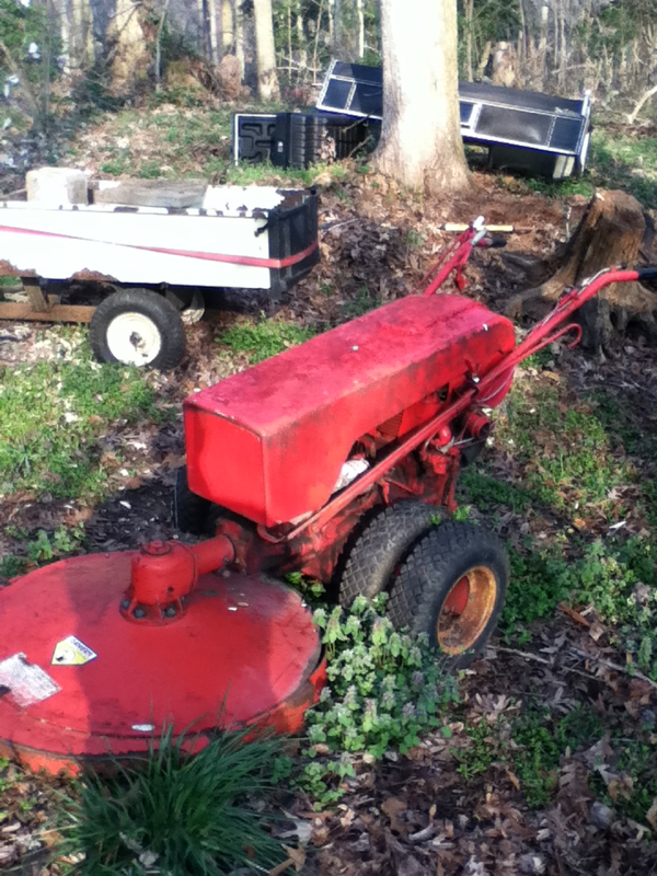

Hey guys here are some pics of the gravely I'm considering buying I don't know what model it is and was unable to locate any today any info is helpful thanks

Also I learned today it has a zenith carb and a wifi magneto does that help?
   / Should i buy?
The Magnito is a wico sorry autocorrect
   / Should i buy? #7
Hi| This tractor is not a pro 12. A true Gravely with last 7.6 hp Gravely engine. Why need new magneto. Inside magneto they are a breaker point. You can clean and adjust point at .015 if coil is good. The magneto timing is very important. If you like mechanic you can have manuals free on internet. If engine is not running may be other trouble . Good luck! Oldmech

Ok thank you do you know what model this is or where I could find a tag? Also I was told it needs the sylinoid grounded. What does this mean? Thanks

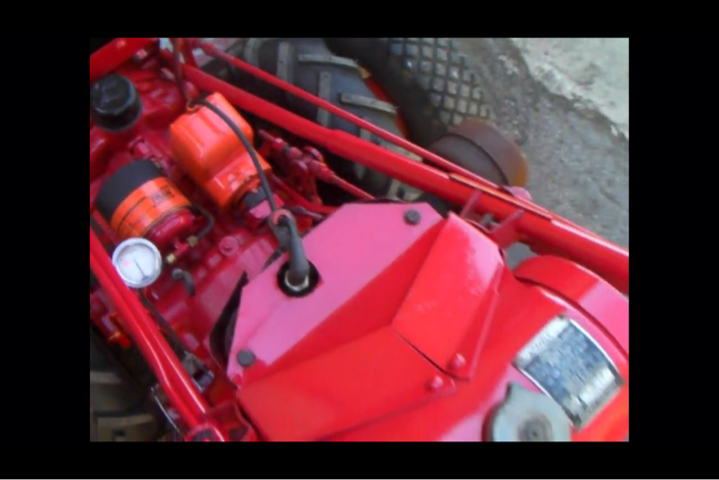

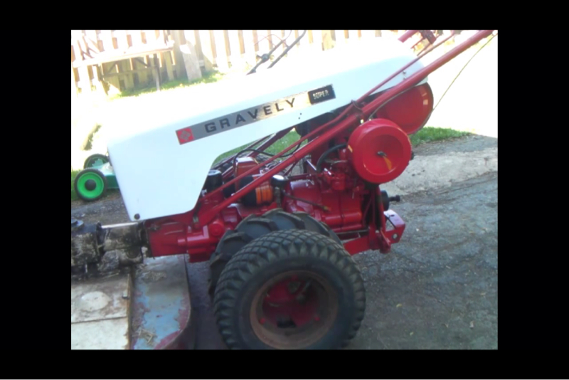

Hey guys today I was watching some YouTube videos of old gravelys. Then I noticed this one look a lot like mine. In the discription it said it was an l series tractor what do y'all think?

This is mine and his side by side his is 1st
