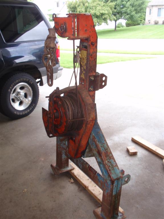

Anything like this one?
attachment.php

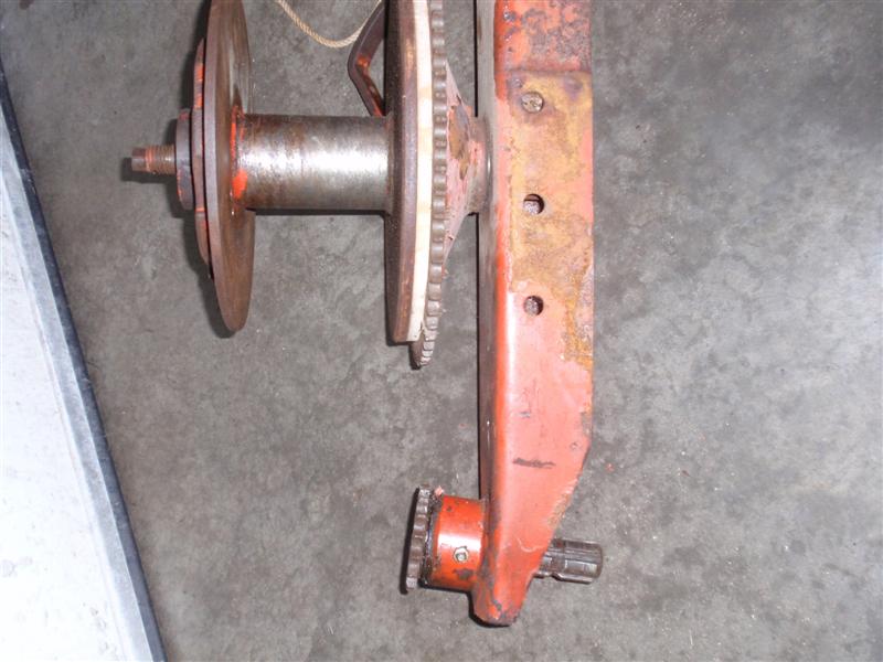

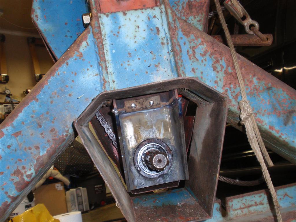

I got this one from a friend who bought it around 1980 for his firewood business. He had bent the main frame somehow long ago. I had to have that repaired to be usable. The welder thought about bending it back, but said it would be better to cut off the bent section and weld on a new one, so that's what he did (plus straightening the bent guard around the reel) for $150.
Before
attachment.php
After
attachment.php
It also needed bearings on the lower shaft, and I replaced the upper snatch block bearing while I had it all apart (given the age). The chain tensioner was worn almost flat, so I replaced that and the friction button for the reel. So $75 in bearings and about $125 in Farmi parts (all still available but pricey) plus probably another $25 in hardware that I replaced for goof measure. All totaled about $350-400. I didn't repaint it as you can see. It's on the long-term lend-lease program as my friend has no tractor or any real need for it any more.
I wouldn't worry about clutch rusting. I would bet 10 seconds of use would make that disappear as it is simple friction material on the reel plate. Check bearings, chain tensioner (the chain just rubs over it), and the frame for straightness. In this case, the fact that the chain wouldn't stay on was the key that said it wasn't right (hard to see without taking the main cover off.
And yes it works great. I have a billion pictures of the teardown, if you are curious about any particular item.
-Dave
