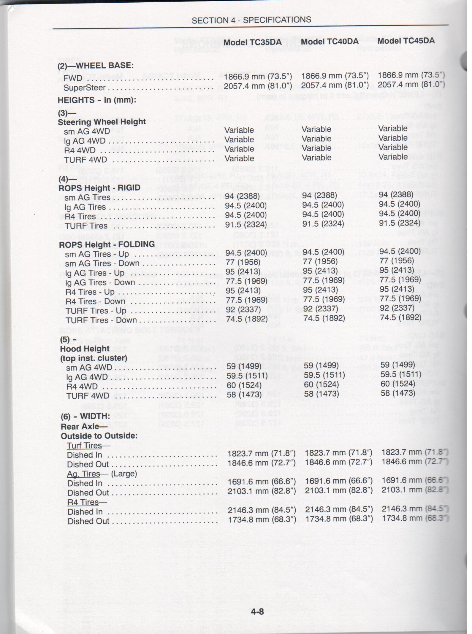

I would need it for skidding and stacking logs. FEL and 4wd is a must. I need it under 6' wide for the woods. Any model recommendations?
   / SHOULD I BUY A TC30 #6
Here are the widths from the operators manual.

xmoto---I have a TC35 NH with FEL that I use for log skidding and log loading for my Woodmizer logmill. This series of NH has a robust subframe that supports the FEL and protects the tractor drive train housing. Go to youtube and search "TC35 log skidding." The wheel width on the TC 35/40/45 is under 6'
