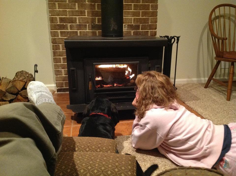

I can't find any identifying marks on it anywhere, but the intake vents seem similar to yours. Two flat pieces that can be moved to block or reveal the intake vents. Here's a picture I took for Facebook a couple weeks ago.
