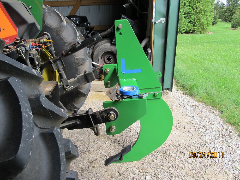

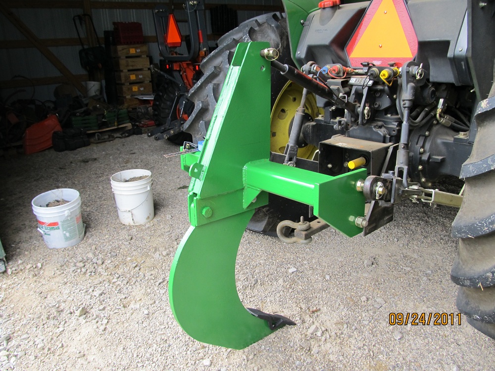

I'm not sure you can do it with a Fred Cain model but I did it on a different ripper that I have. This one of mine is a real beast and I use it with a smaller Kubota in cat I or bigger Deere as cat II. See photo below.
I added a plate to the sides and spaced the pins roughly 5" or 6" apart. By lowering the cat I mounting you raise the implement. You can also get a shorter point for additional effect.
That's a neat idea and you are correct. It wouldn't work on this Fred Cain model...
