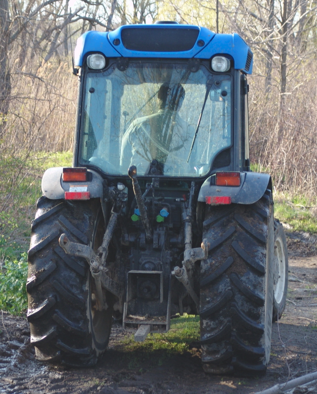

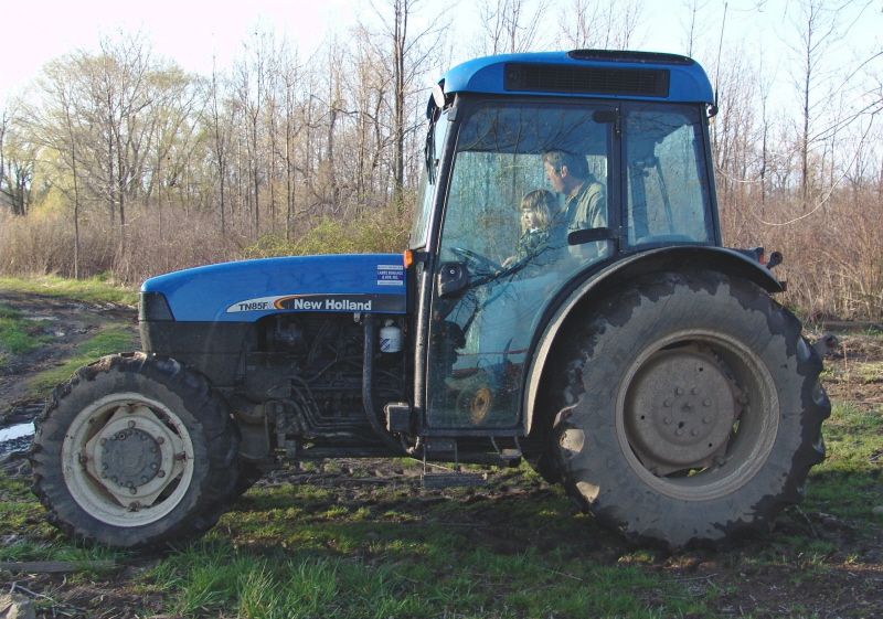

I changed over my browser and now everything seems to work again so I can post some pics. The first pic is the TN85FA from the side and the second is from the back to show how narrow it is.
   / Short review of the TN85FA #5
i opened the first one and went
WOW that front axle sticks WAY out in front....
then i opened the second and....
WOW that sucker is narrow!

The way the front axle sits and as low as the tractor sits it makes you feel like you are driving an open wheel race car. It is a lot of fun to operate and if the numbers work out hopefully I will put a few more hours on it.

Thanks for the feedback. It is an interesting tractor. In fact, I have not seen another that sits so low (good for getting it in my 95 inch doorway) with that much power. I know you should not operate a tractor like this on a slope, but how much of a slope can it take before you start to feel concerned? I took a careful look at your photos, and I noticed there were no telescoping-draft-links. I wonder if these are an available option; otherwise, I would have a rough time hooking up heavy implements.

I do not think the telescopic draft links are available on this style tractor. The lift links are angled out as there is not much room between the rear tires so there is not much room to move the lift arms. What I found is that a 5' or 6' cheater bar will move most implements a few inches and are very handy for hooking up items when you don't have the tele links. The lift arm setup is not the greatest but given with what there is to work with I think NH did a good job on it. I don't remember how the JD setup was to know if it was a better design or not.
