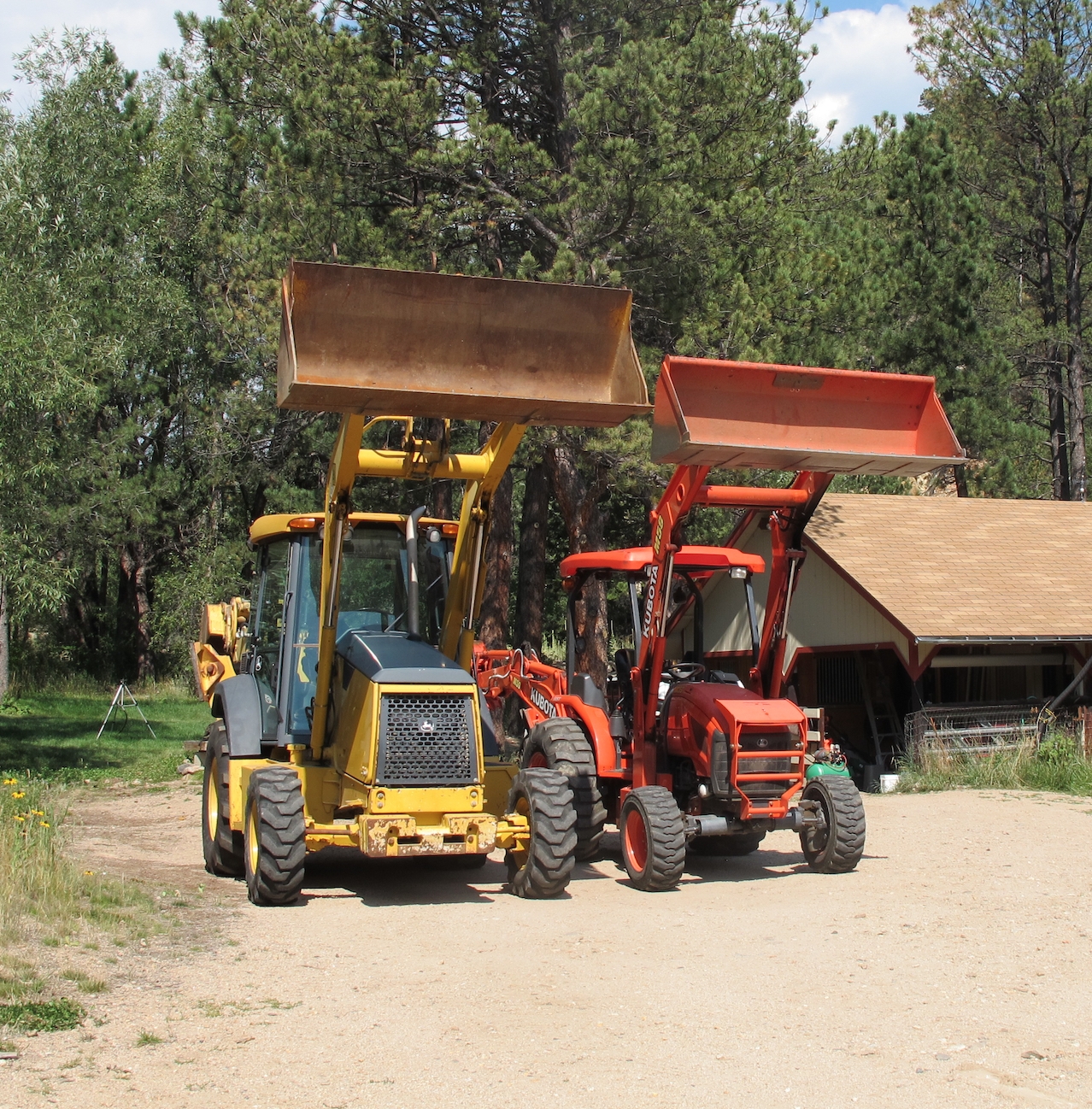

We had the same sort of work to do on our property. After having some experience with CTLs and lots with tractors and TLBs we chose the TLBs. Right now have a Kubota M59 bought new in 2008, and a Deere 310SG bought used 2014.
Both are excellent, strong, & durable. I am older, and like my comforts. the M59 has a thumb and optional 3pt. The 310 has a large cab with heat and AC. Cab is big enough for a dog and buddy seat.
We enjoy doing our own landscaping, design, and building - but just for ourselves and friends. We do other things professionally. So tractors are now just a hobby for us. Being rural folks, we've had about a dozen tractors through the years.
To your questions:
1. Attachments: TLBs generally can use the same attachments as Skid Steers do. In fact the M59 has a skid steer quick attach plate as part of the standard FEL, and decent front remote hydraulic flow. So any attachment that will work on a CTL will work on the M59 as well - with the exception of hydraulic flow rate. More flow rate is available, but needs to be run off the M59's PTO hydraulics.
The Deere 310SG does not have the adapter plate for CTL accessories. It is available, would have to be added. Cost is about 1K. The 310 has huge high flow hydraulics.
2. Removing BH & 3pt. The M59 backhoe can be removed and the Cat. 2 3pt hitch mounted. Takes about 30 minutes doing it without fuss. Hydraulic outlets are the same as on any tractor with rear remotes.... or front remotes for that matter.
The Deere 310SG backhoe is NOT removable. There is no 3pt. It is a purpose built machine, and much more heavily built than the M59. The M59 is the 60 hp Swiss Army knife of tractors, the 310 is twice as powerful.
3. Other Attachments. The backhoe buckets on both TLBs are themselves quick attach type with extra hydraulics. That means a variety of buckets as well as other attachments can be quickly mounted to the backhoe boom. That option is not available with the CTL. Things like posthole diggers, clamshell grabbers, breakers, cutters.... flails...etc.
Backhoes also make excellent cranes for moving things. In fact, we use that feature of the BH more than we dig with them.
Either machine will run most rental attachments.
4. Things Not Thought of: CTLs have better traction, but you sit low and have to get into them by crawling over the bucket. You eat a lot of dust when working.
TLBs have you sitting above the work and looking down. Traction is not as good as a CTL - even though both TLBs are 4wd.
We sometimes hop on and take our TLB a few miles down the road to town or to neighbors. Traveling any distance like that on a CTL is a non-starter.
The M59 doesn't have the power of the CTL. It only lifts 4000 lbs in the bucket, but does have a 6 speed HST.
The Deere has plenty of power for everything. Roughly double the capacity of the M59. Lifts over 8000 lbs.
For getting into or out of a tight spot, either machine can lift itself with its backhoe.
Things not considered... I love the open cab on the M59... in the spring, summer, and fall. Winter not so much. Wish I had bought a thumb for the JD310SG. A BH thumb is so versatile it almost doubles the usability.
Why two? Well, we have a lot of dirt & rocks that need moving. The M59 with its backhoe can load up the 310 FEL bucket. The 310 then becomes our dump truck for moving dirt and rocks while the M59 is the more precise machine for spreading dirt or placing rock walls.
