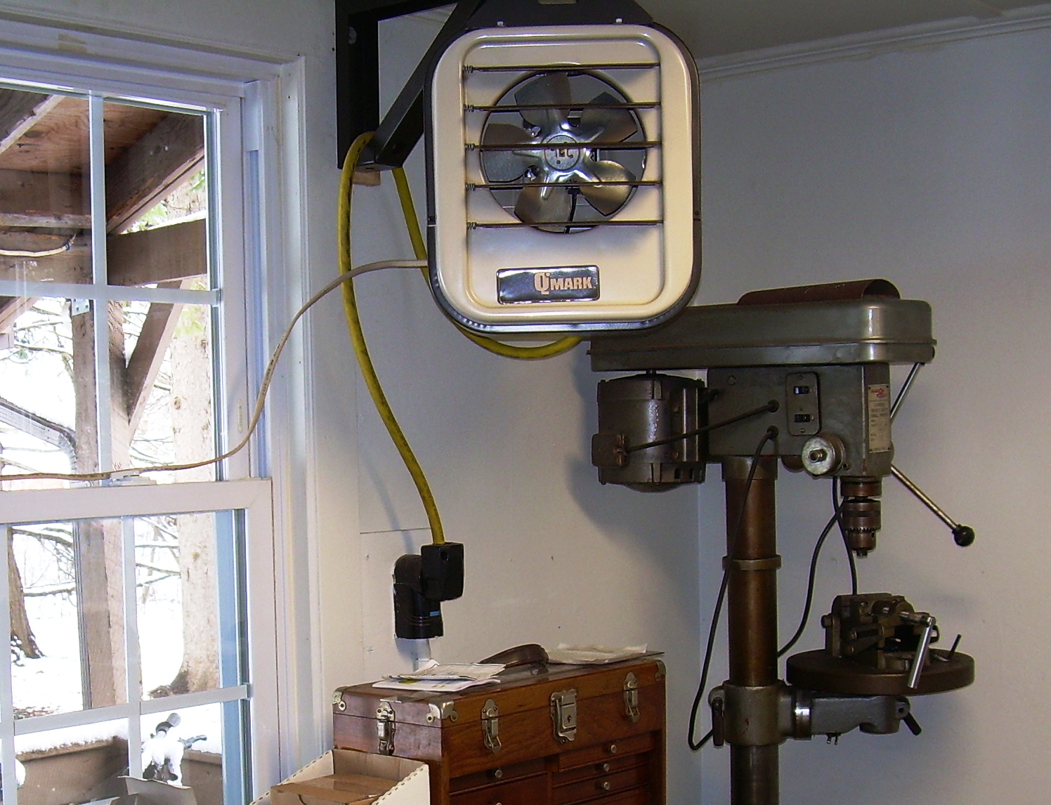

I'm looking for suggestions/input as to heat for a workshop. The shop is 24' x 28' and well insulated including an insulated garage door. I use the shop a couple hours a night a couple of times a week and usually a few hours on the weekend. I'm in North MS so temps in the 20's - 30's are our normal lows with occasional teens and seldom single digits. I was considering one of the electric edenpure heaters (about $400), a cheap walmart electric heater ($70), or maybe a propane heater ($?) using a small tank. Any input would be appreciated. By the way this a tractor related project because the tractor is kept and serviced in the shop.

I would go with a unit heater on propane, about 35,000 to 50,000 btu size. These are fan forced air heaters that are hung from the ceiling. I am assuming your tractor is diesel though. You need to be very careful how you heat a garage because of the potential for vapor combustion.

Rinnai ES38. Direct Vent, sealed combustion, modulating gas valve (10,500-38,000 btu@ 81% eff)and blower. Simple install with only a 3" hole thru the wall for the vent. I have one in my two car under garage with uninsulated block walls. At 0 deg F outside I can go down and turn it on, go have breakfast and be working in my shirtsleeves all day. Quiet too, which a unit heater is not. I have mine so it blows across the garage doors. I can tell you that a couple winters ago I restored an old BMW and with the car up on jack stands, it was nice having that heat coming across the floor while I was on the creeper putting in new floor pans.
Now...a proper disclaimer. I have to acknowledge my bias. I have represented Rinnai in New England for 20 years. I've been in the heating business for 45 years. I heat both my homes with these units and have sold 135,000 of them. My central boiler is now my back-up and my Energysaver has become my primary heat. They are the best heating appliance I've used and recommend them to everyone...even my sister, and if you knew, well...anyway;). They are not inexpensive, but those that I sold in the early 90's are still going strong, so you get what you pay for.

Modine Hot Dawg heater... 60K btu. Install a propane tank and you're good to go.

Just a quick google of those shows them in the $1500-$1800 range. Kind of pricey IMO.
The Hog Dawg heaters are pretty nice and priced reasonably.
Mr. Heater Propane Garage Heater — 45,000 BTU, Model# MHU45LP | Heaters | Northern Tool + Equipment
