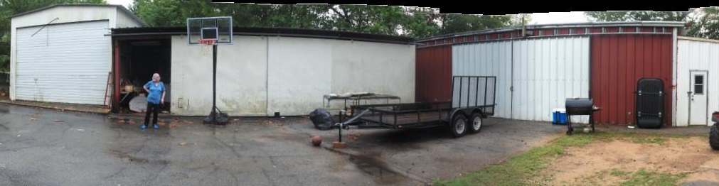

I've got 4 "shops" in Northeast Mississippi
474300d1468271716-shop-ceiling-outside-shops-cropped-jpg
all needing new "ceiling treatment".
The red one to the right of center has a 15 by 40 apartment across the back with the ceiling suffering from water damage before I had the roof replaced. After looking at a lot of ceiling "treatments" I'm thinking of using light colored pine panels or strips, almost like flooring. For the shop on the far right (8 to 10' ceiling) I'm leaning towards white metal panels, it's due to be my "wood shop". The others I don't know if I'll ever get around to putting in "ceilings". But if I put them in my "RV" shed (on the left where I keep my M4700, which is my 4WD recreational vehicle) at 14' high I'd probably go with galvanized.
