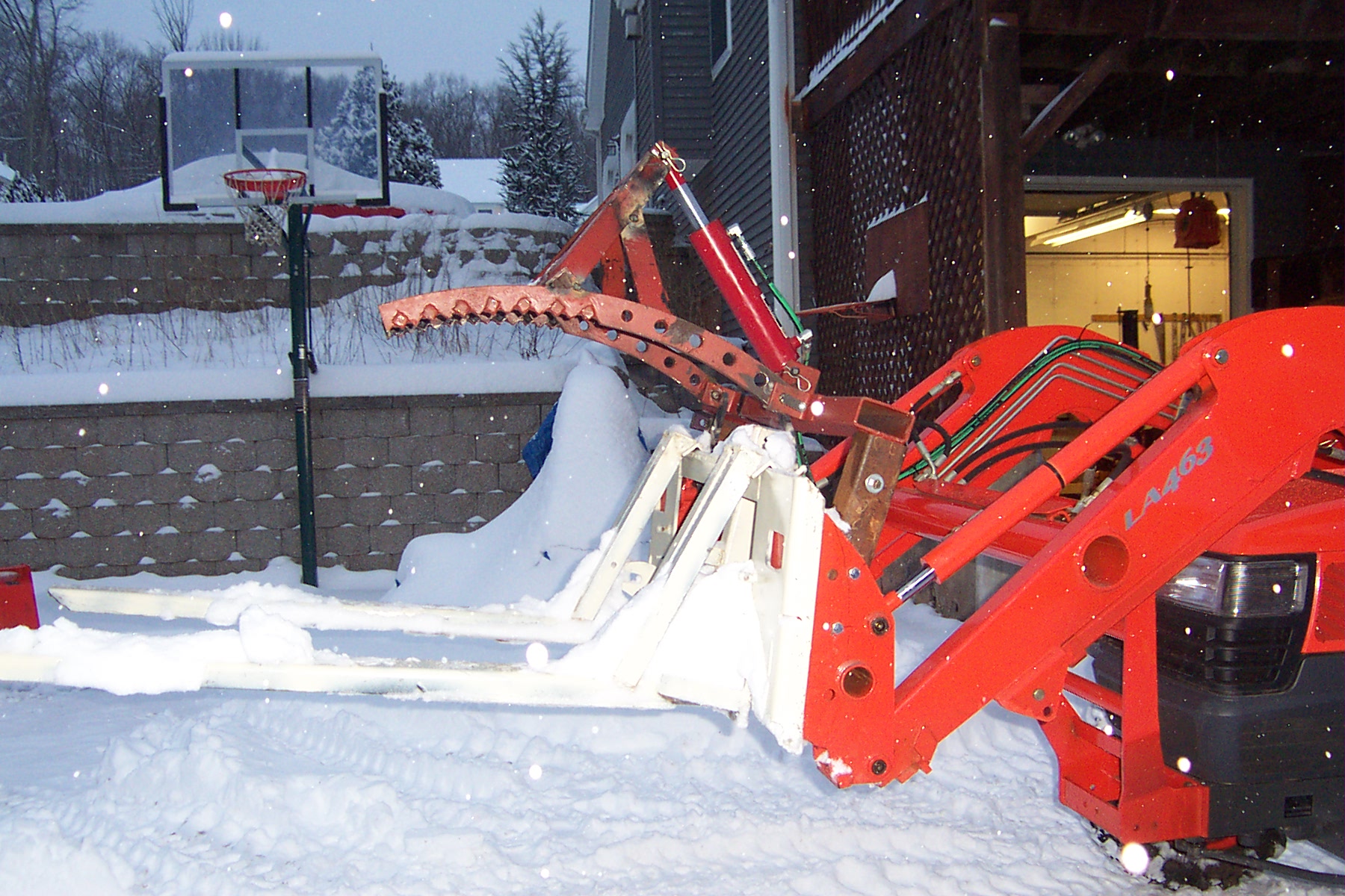

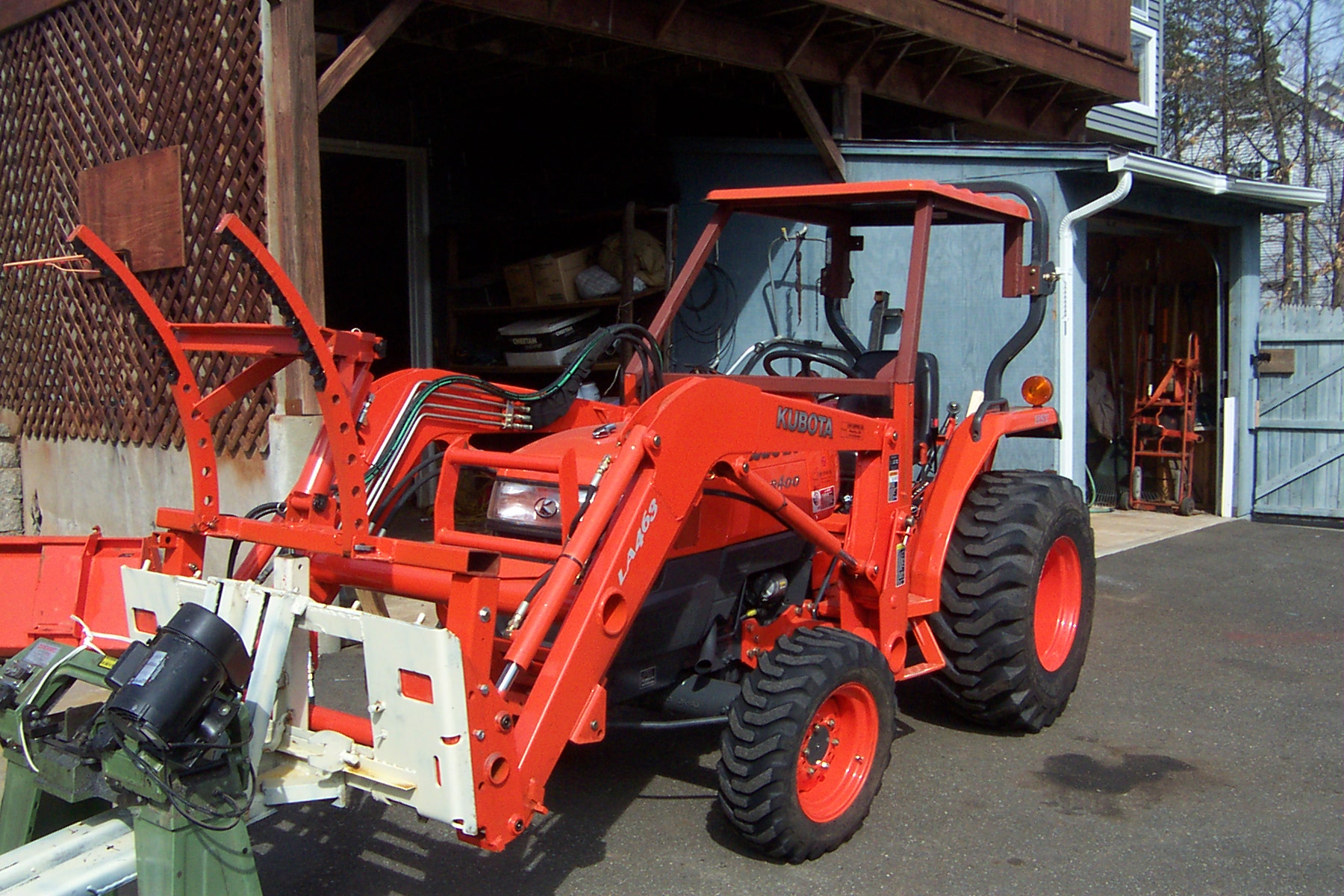

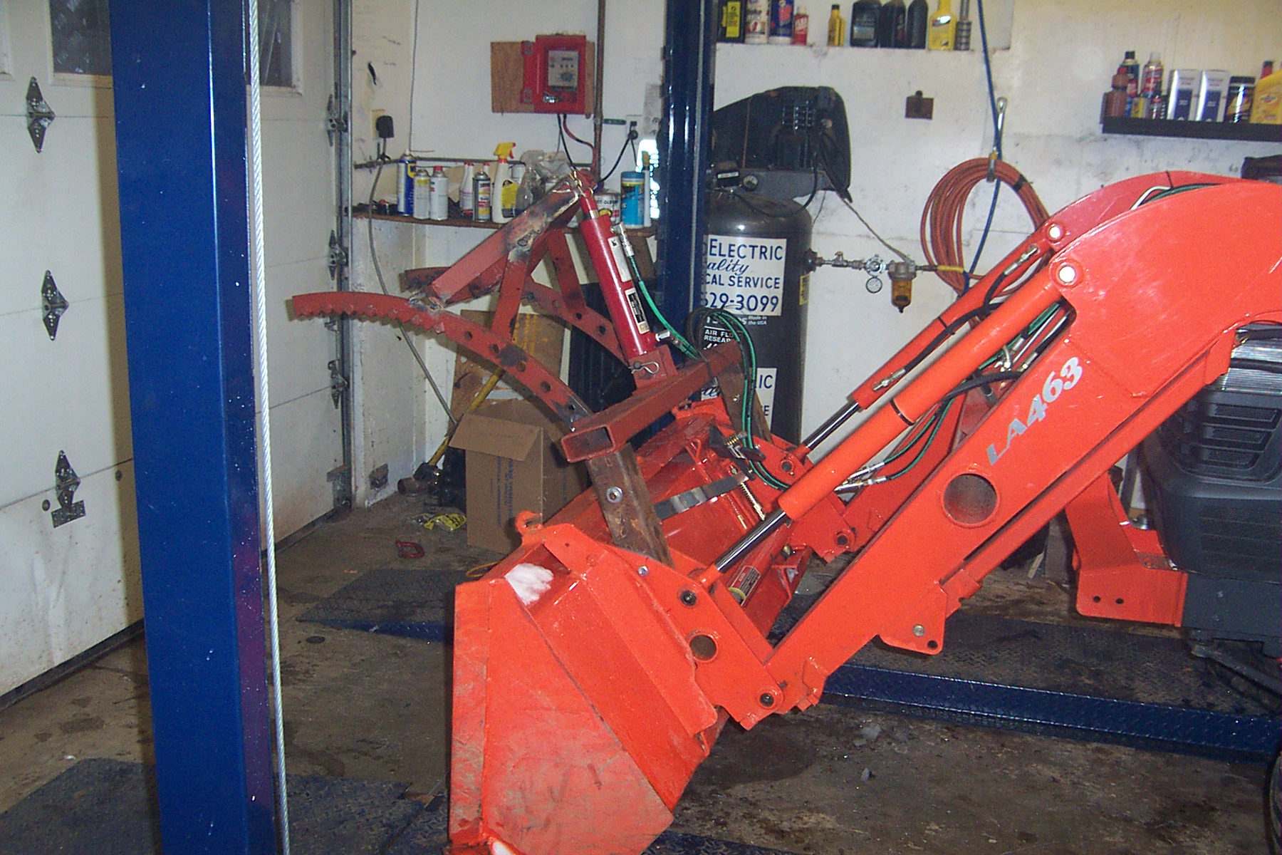

I attached the grapple to my loader arms so I could use it with the bucket or for logs with forks

I made mine by trail and error. I used 1/2" and 1" pvc pipe with a bolt in the pivot point to determine stroke length and placement of the pivot points. I think I came up with 8". My grapple teeth are not as wide as the bucket. I use it for everything from large rocks to brush.
I even pick up my rake, box scraper, snow blade,etc and move them on and off my indoor shelving. No chains or getting off the tractor needed.
I don't see any reason to make them as wide as the bucket.
If the grapple arms stick out to far it will interfer with bucket digging near close objects/or self destruct because of pushing them into unseen objects. They don't have to stick out to far.
If doing it again, I would look into a light weight 4 in 1 bucket. Would it be possible to have an aluminun 4 in 1 bucket?

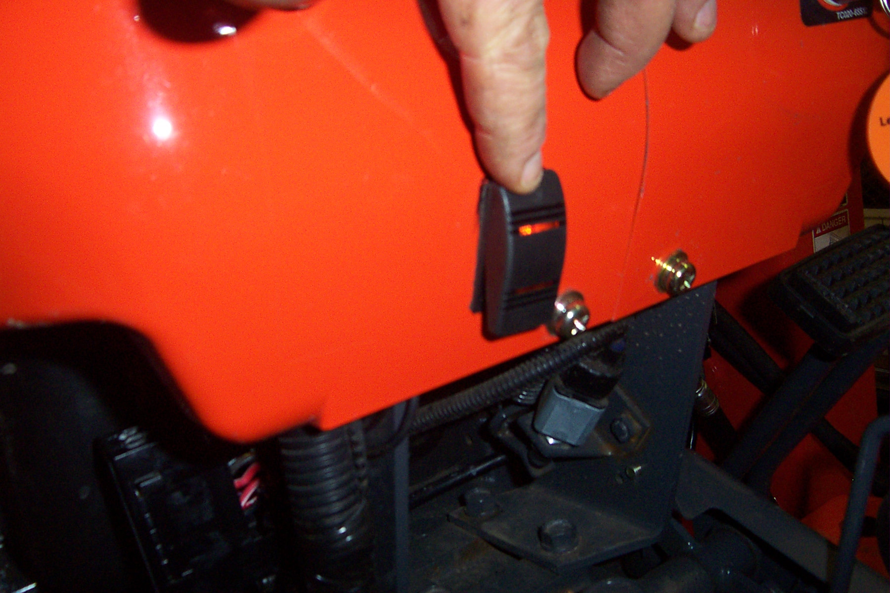

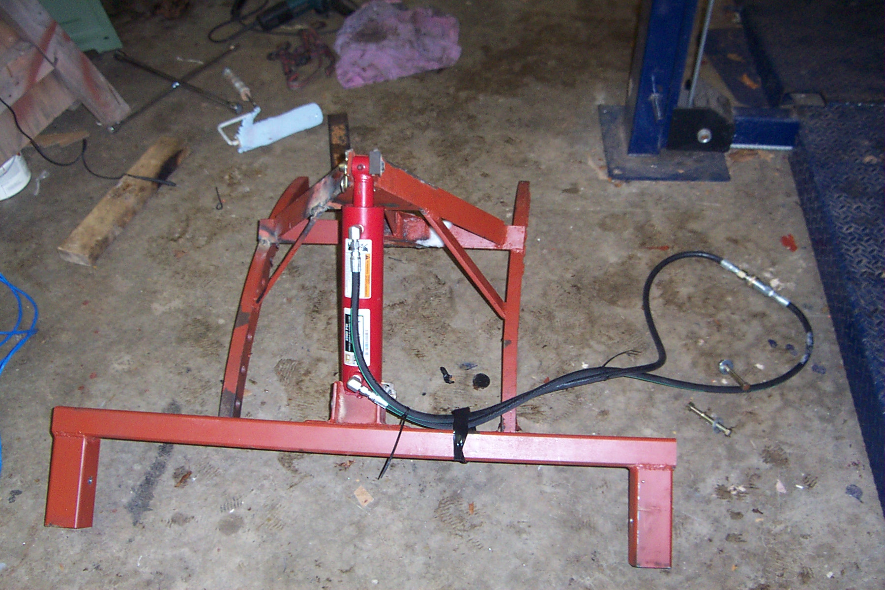

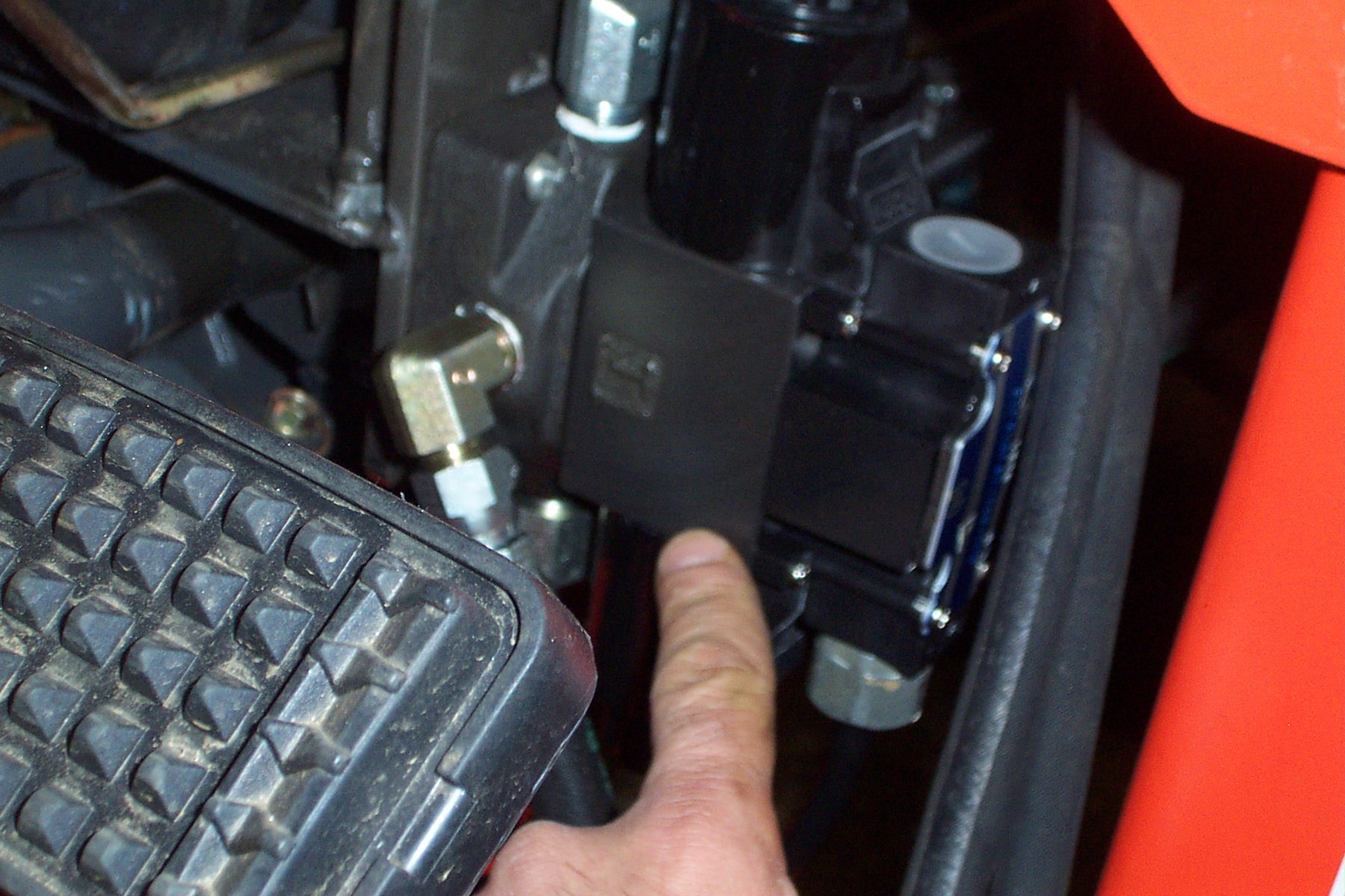

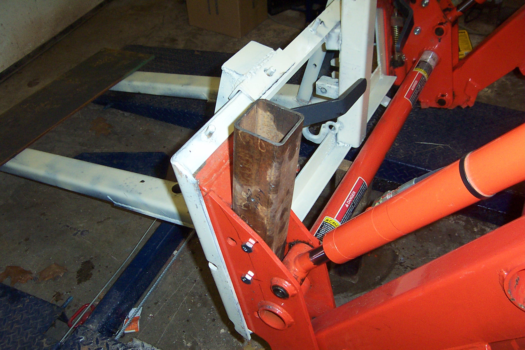

I wanted my grapple to be removeable, but I use it so much, that I just leave it on. I like the fact I can drop my quick attch bucket, put my forks on, then lift my 10' wide work platform, pinch it down with the grapple arms and hold it in place.
I also used electric over hydraulic to operate the grapple, since it was cleaner with just a switch on the dash.
