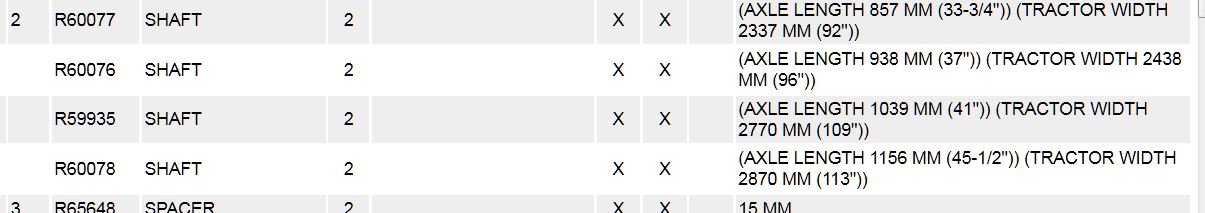

Hi All,
I am new here- brand new in fact as I have been trying to research sizes of tractors on the web and found this forum. MY name is Bob Wright and I work in Uganda for the Presbyterian Church as the construction and maintenance manager of a rural mission station where we run a medical clinic, drill water wells and farm. We have been asked by some Korean friends to greatly expand our farming project to grow sesame seed for export and I am trying to purchase 3 100hp+ tractors and a couple of backhoes to send over here. I have located several used tractors in the US and need to know how wide they are to see if they can fit inside of a shipping container. We can take the cabins off, fenders, tires, etc. as necessary but I do not wantto purchase a tractor which cannot be shipped in a container. The inside dimension of the container is 92" across.
Is there a place which would list the sizes of for example a JohnDeere 4240s, 4040S, etc.
Thanks for your help.
Bob Wright

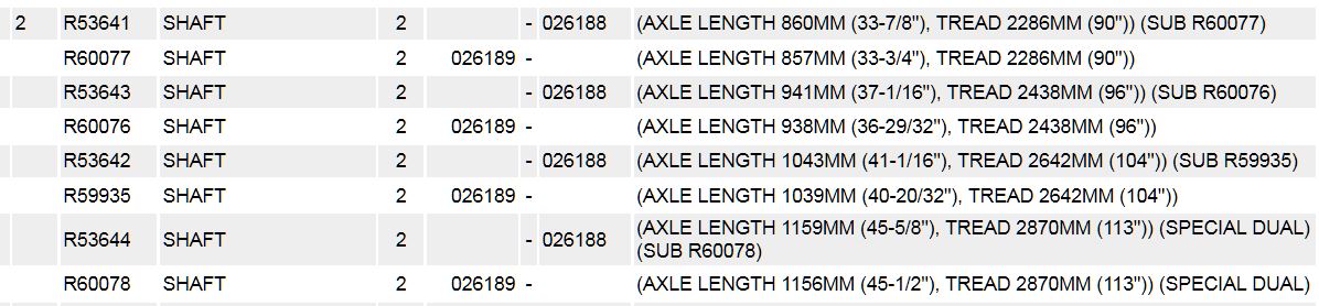

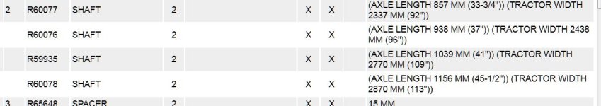

   / shipping overseas in shipping container #7
bobwright
One thing to consider on JD 30,40,50 & 55 series rowcrop tractors spec's as to fitting in a 92" wide shipping container is rear axle length. 1st list is 4230,2nd list is for 40 series IE 4240
