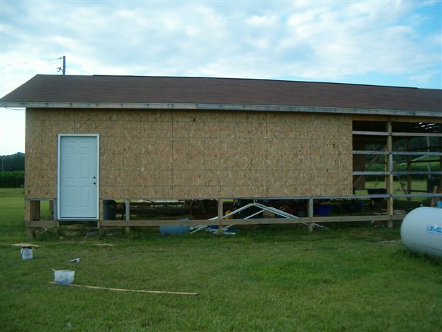

I'm building a 30X48 Pole Barn. I used trusses 2' on center w/ 7/16" OSB w/ very heavy shingles. I completed the roof in late April/early May. I have seen no signs of any sagging. BTW, most of the OSB was up last year with tar paper so it has seen a little bit of snow, though we didn't get much last year. I did use the clips as someone else has recommended. I'm also doing OSB on the sidewalls w/ vinyl siding. I also used clips between the horizontal purlins.
I would've like to have gone heavier grade of plywood up on the roof, but I had budgeted about 8 per sheet for the heavier stuff. By the time I went and bought the 7/16" was up to about $16 a sheet if I caught it at a good time other times it was $19. /forums/images/graemlins/frown.gif /forums/images/graemlins/mad.gif /forums/images/graemlins/crazy.gif
Here is link to my project. Jim's Pole Barn Project - hopefully
I've also attached a picture of the roof after I started putting some of the OSB on the sidewalls.
