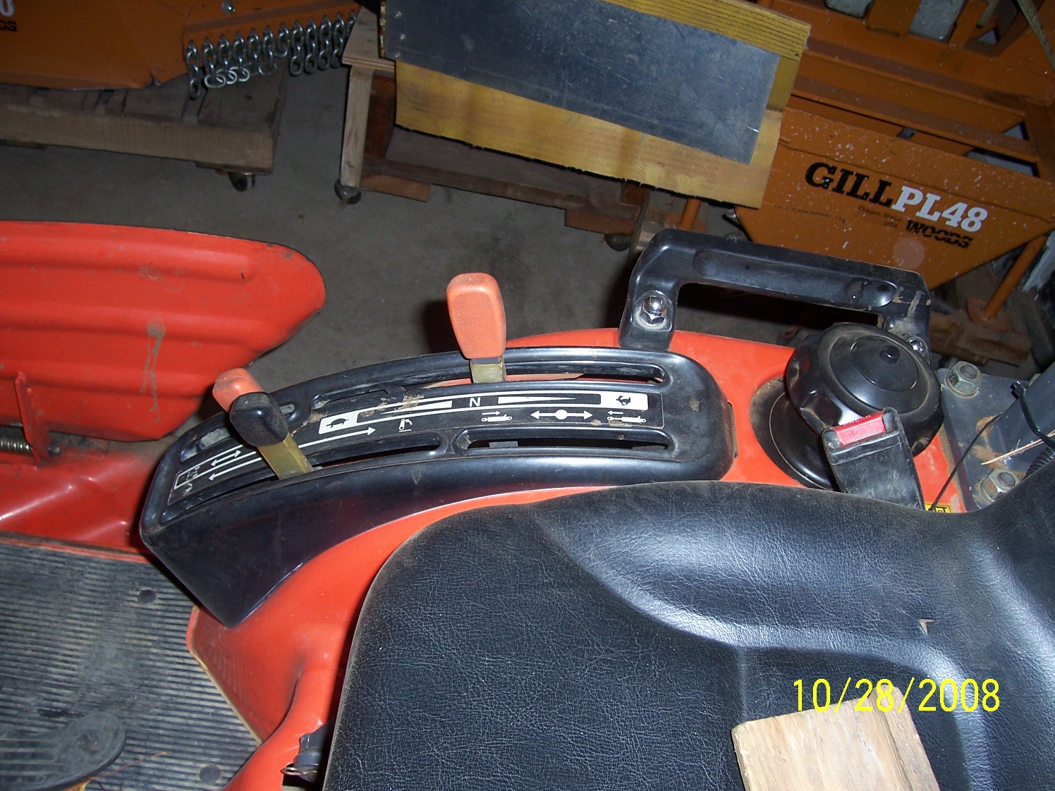

When operating the hydraulic lift on my BX24, I sometimes grab the shifter (low speed to high speed) instead of the correct knob. Has anyone made some kind of lock to insure that it won't shift while under load by mistake?

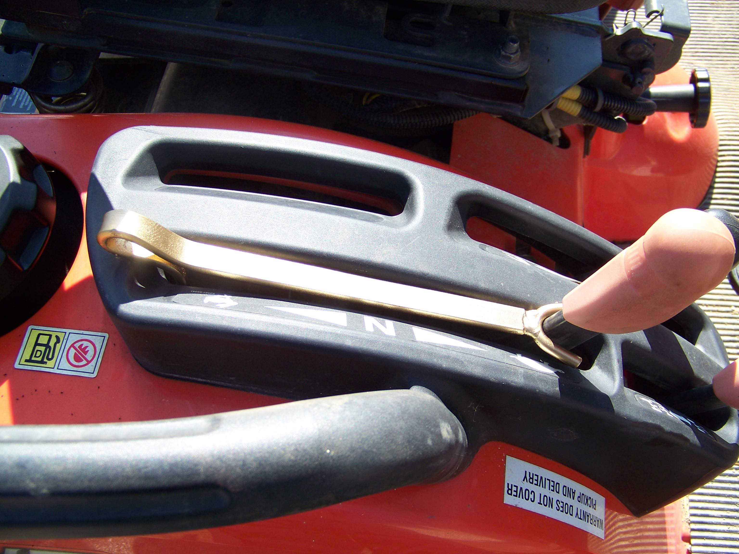

I hope this picture comes through. It is made from 3/16 by 1/2 an 1/4 round steel. It works great.

Pretty cool. Glad you were able to make somethin' work out.

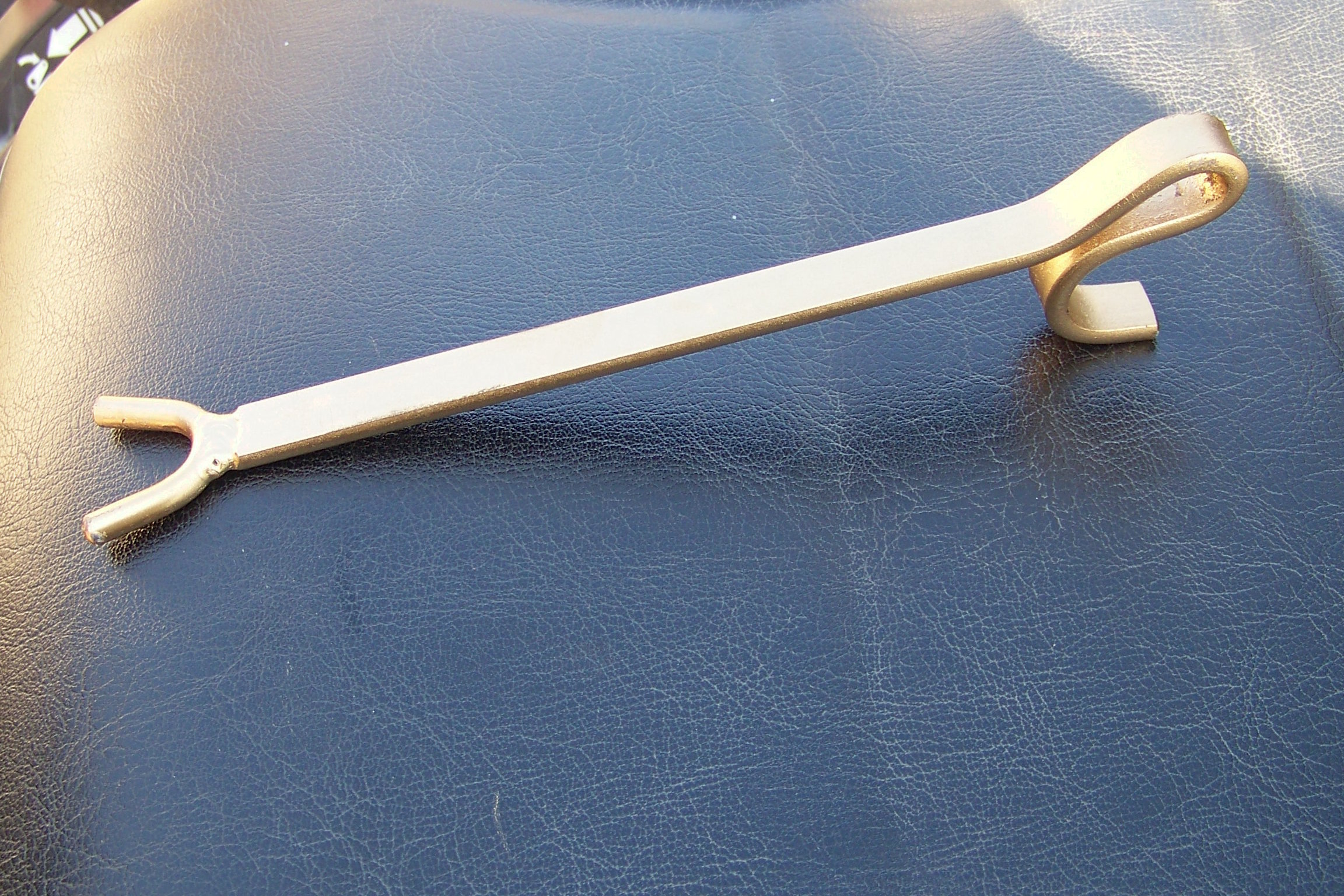

I have been thinking of making the 3pt. lift lever a little longer. Extending it out and angeling it back a little. Something like this would help to.

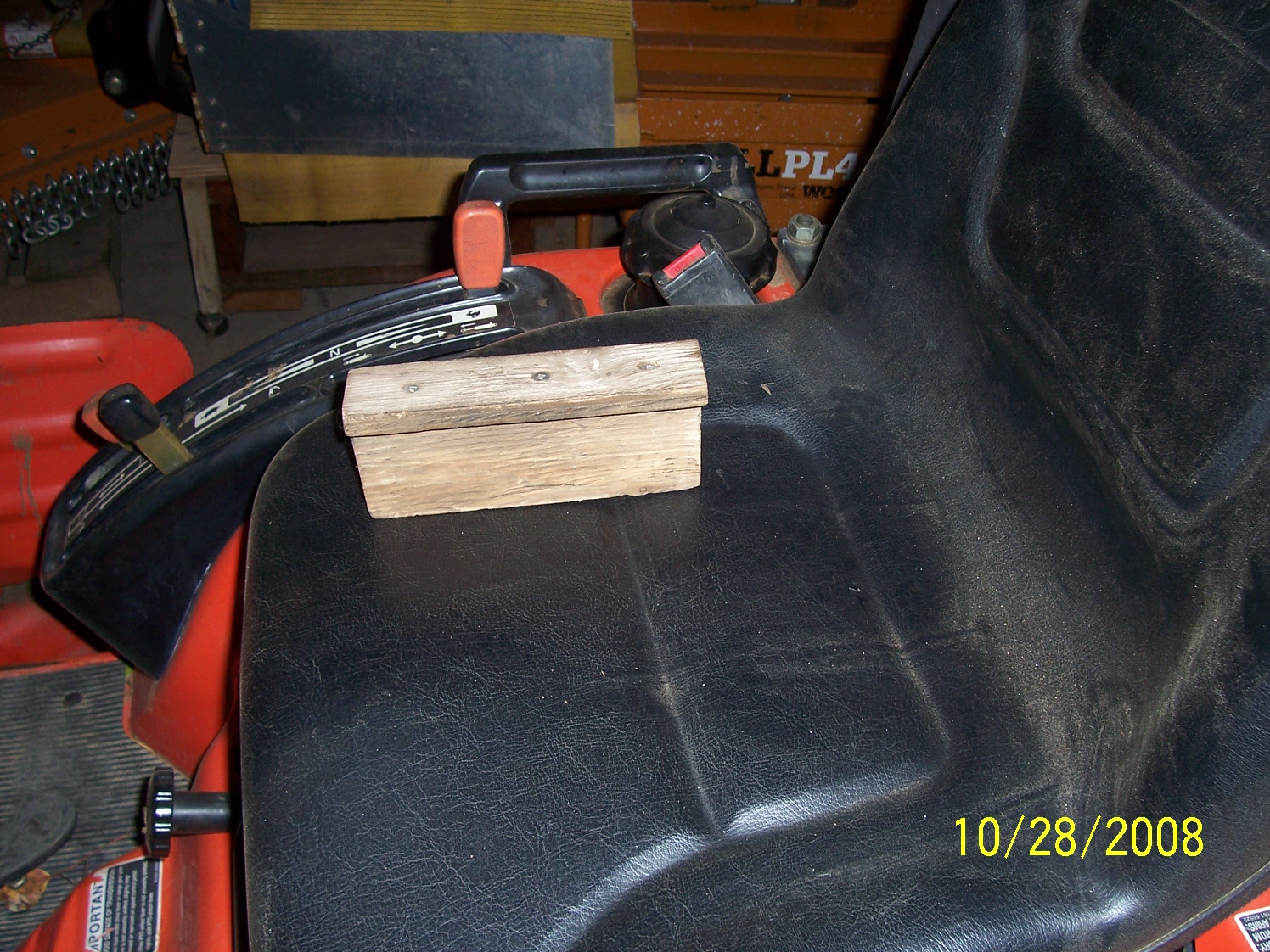

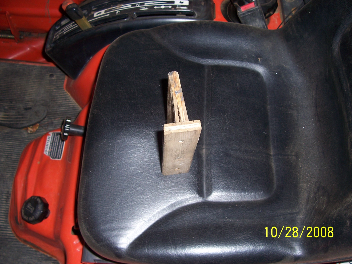

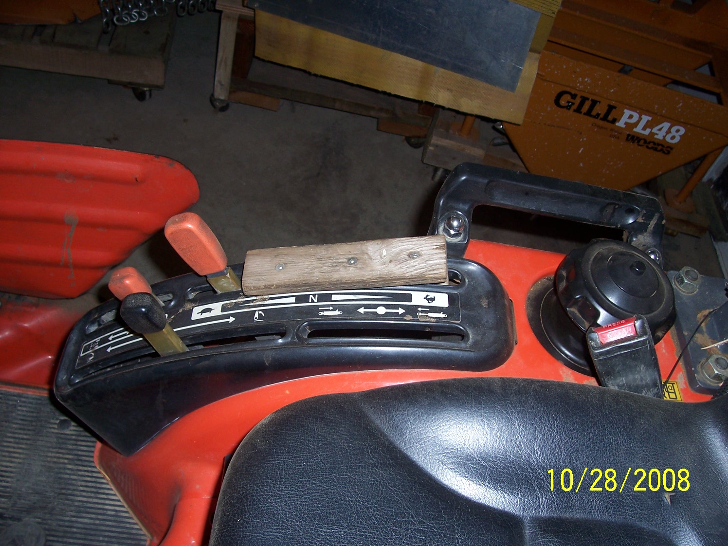

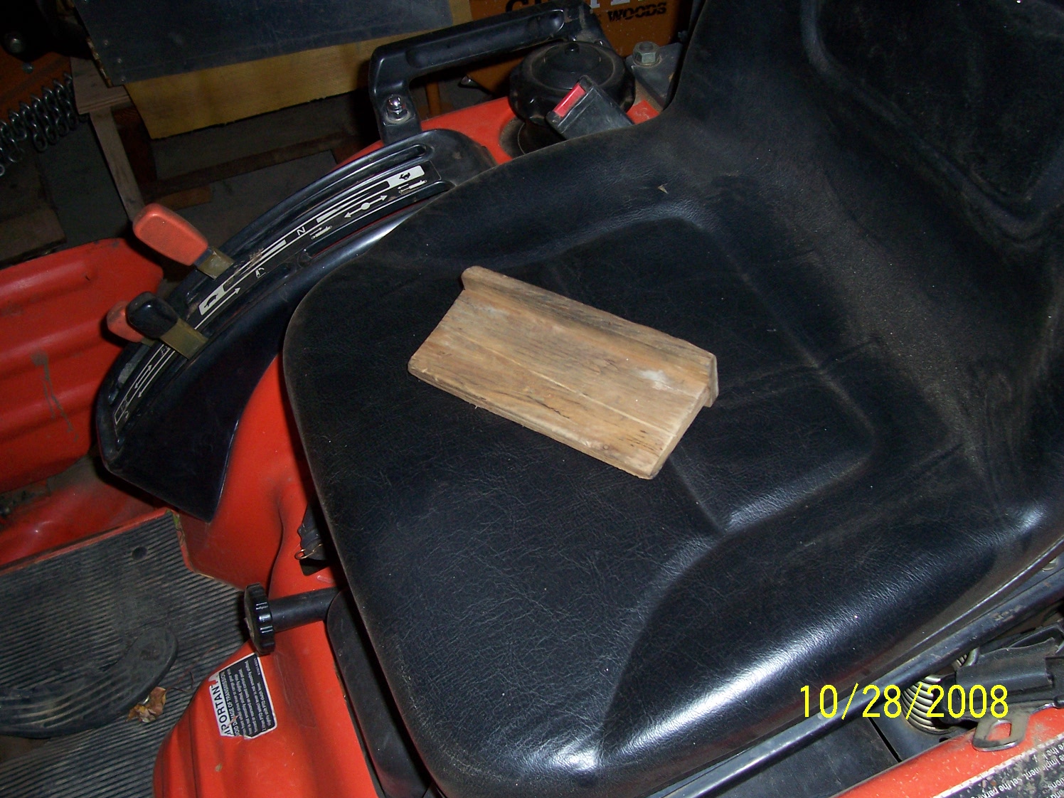

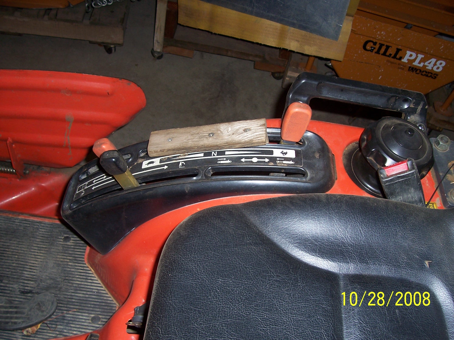

I've attached some photos of a lever stop I made for my BX2200 5 years ago. I don't know if your lever arrangement on a BX24 is the same on the BX 2200. My right side levers are the 3 pt. hitch, the 4wd, & the two speed HST (L-N-H) range lever.
I knocked my range lever into neutral while plowing snow. It took me a few feet of rolling to understand what was happening, but I did hit the brake, stopping before I rolled over the driveway edge.
It is just two pieces of plywood, screwed together to form a "T". You size it to fit your range lever slot.
This only will work for a two range HST (L-N-H). It just drops into the lever slot, you pull it out to change the lever position, then drop it back in. Cheap & simple safety piece of mind.
