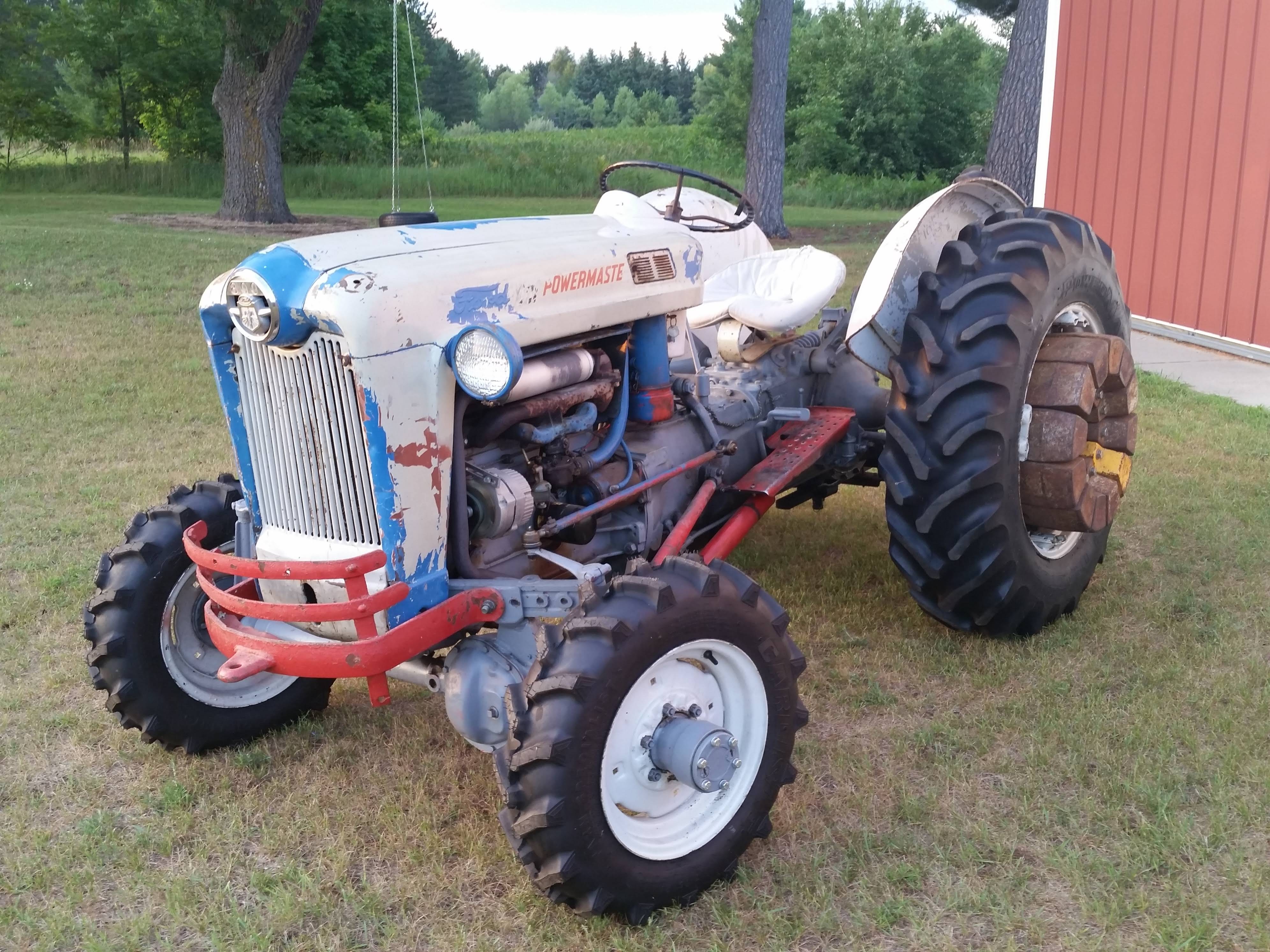

Here is my 1955 Ford 860 with a Sherman Napco front wheel assist. I found the front wheel assist on another Ford tractor and I purchased it. I removed it from the donor tractor and installed it on my 860. 20180714_205724.jpg

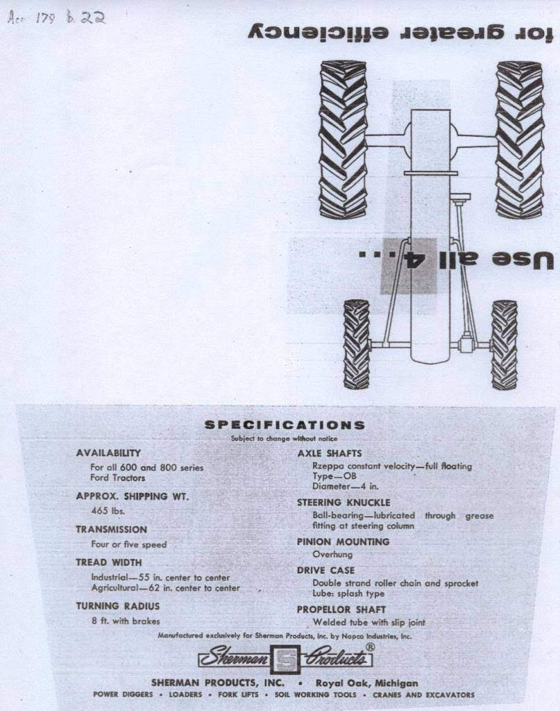

I rebuilt the engine and installed the front wheel assist at the same time and used it to snowblow my driveway for four years. Next plan is to get it cleaned up and painted correctly.

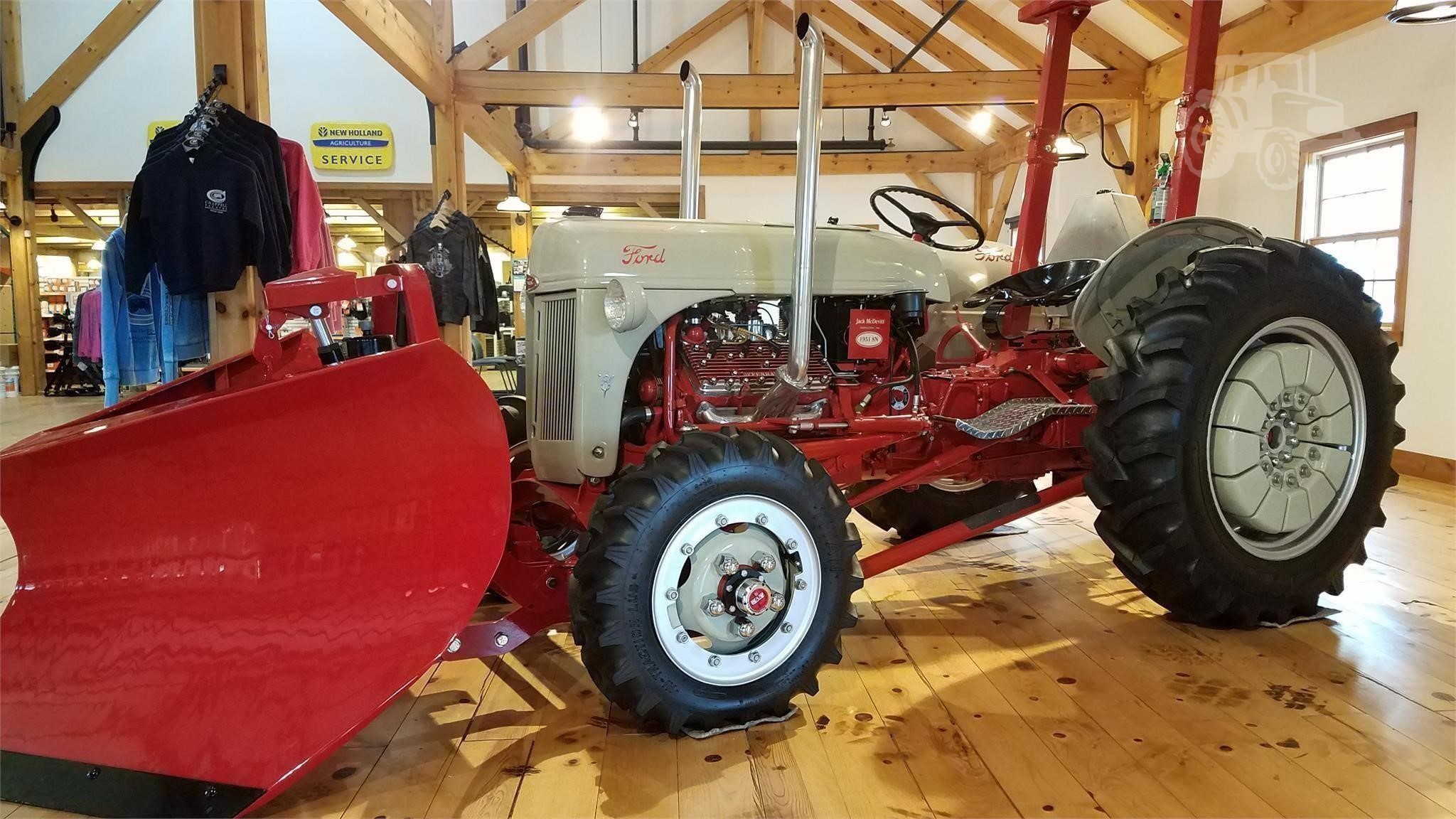

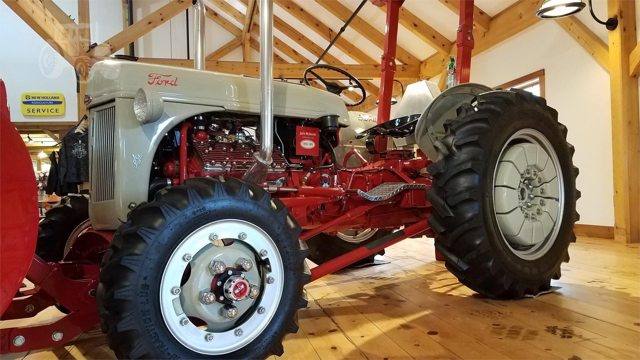

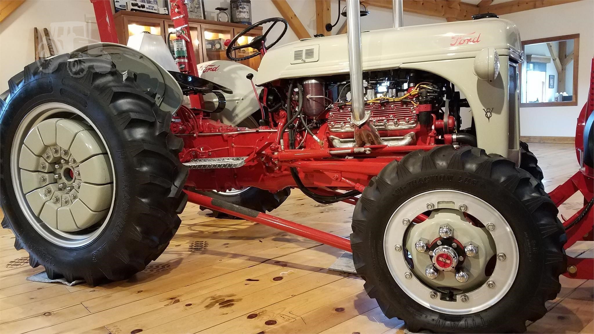

This one has been for sale here in southern NH for a while and you can own it for a mere $25k. A very cool looking tractor but not sure it's $25k cool.
According to the ad it has a V-8 conversion, Edelbrock heads, dual 2 barrel carbs, Elenco 4 wheel drive conversion with locking hubs, Sherman 3 speed aux. transmission, engine driven hydraulic pump for power steering and V-plow lift, Dearborn original V plow, Fisher lift, SS fuel tank, engine oil filter system, 12 volt conversion.
View attachment 571370 View attachment 571371 View attachment 571372
Even has rops ...
I bet it is loud with straight pipes!
