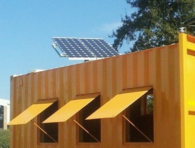

Container on skids with lots of windows on the shooting side.
