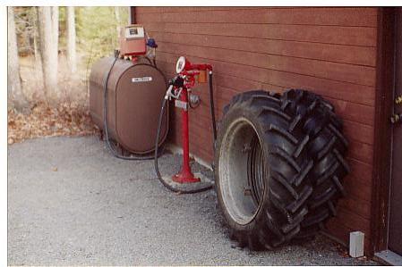

I buy gasoline and diesel in bulk from my local Agway Energy dealer. I prefer Non winterized blends, so I usually order a years supply in August. I stabilize gasoline with Briggs & Stratton stabilizer which lasts twice as long as others. I stabilize & winterize diesel with Stanodyne Performance blend. I have had no problems at all in 13 years of this method of fuel storage. The gasoline tank is the 275 gal. above ground type and the diesel is a below ground 550 gal. Both tanks are fitted with Gasboy electric pumps, but hand pumps work very well. The pedestal mounted pump in the photo serves the burried diesel tank.
