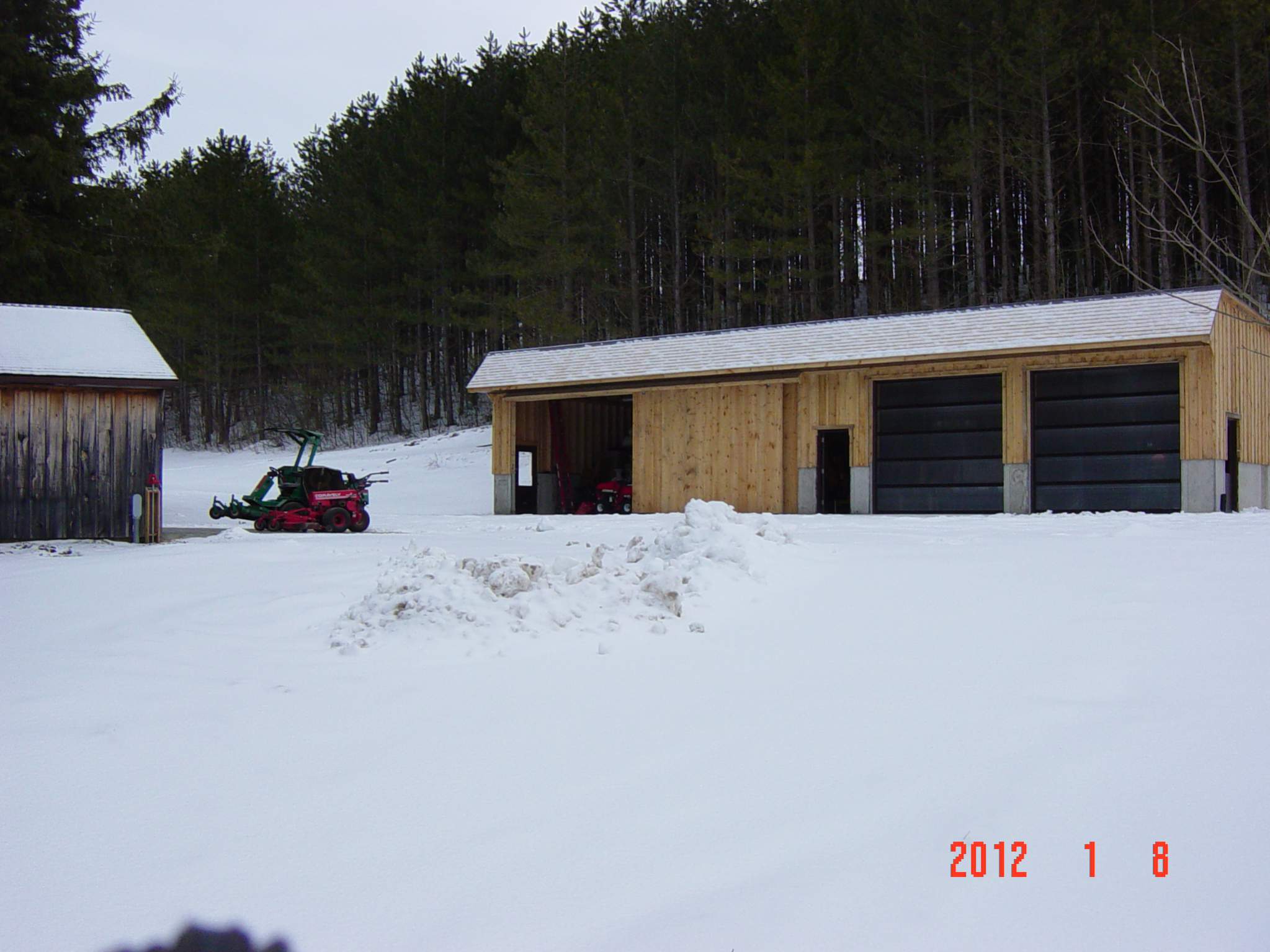

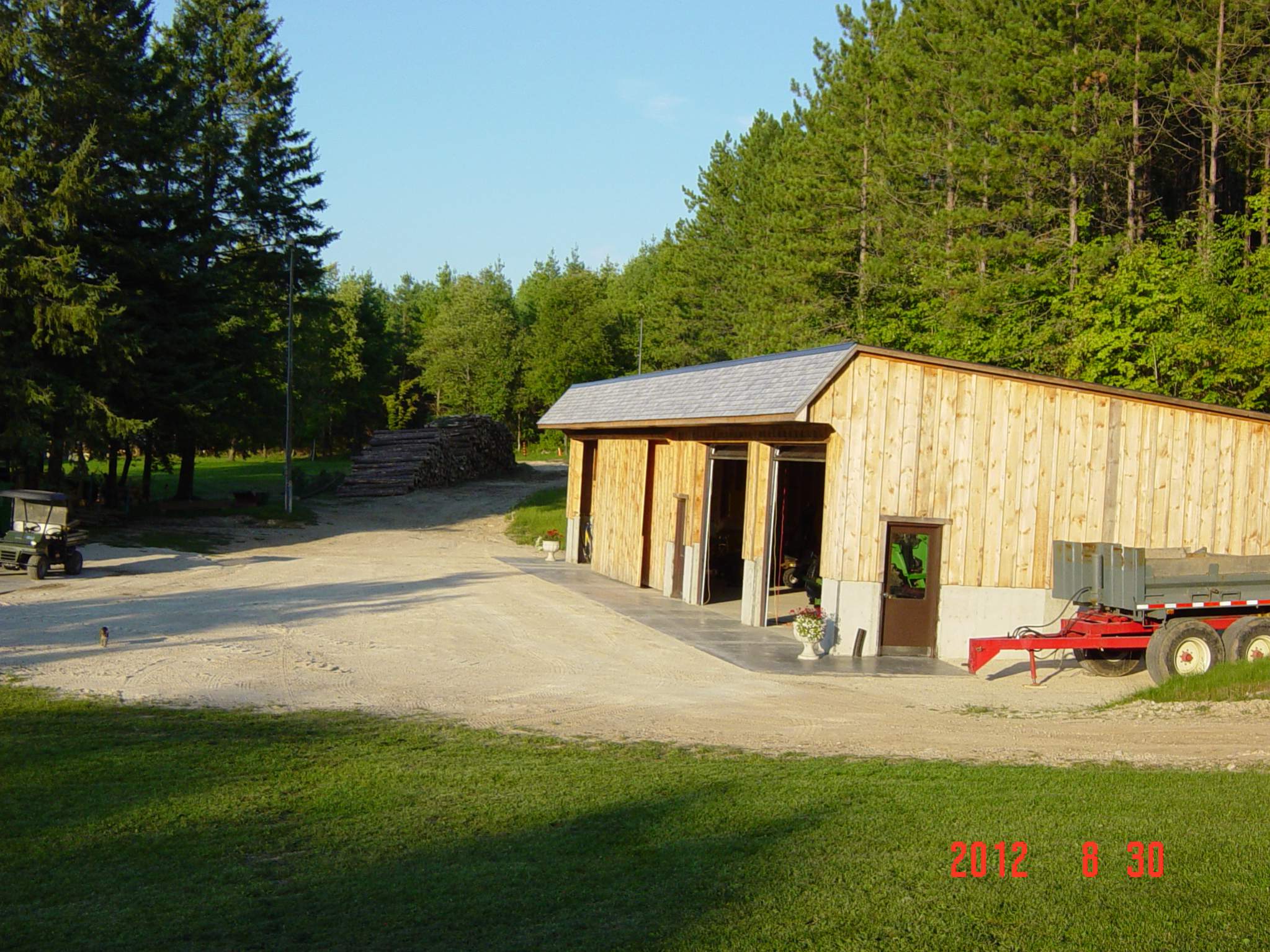

I live in heavy snow country and recently built a 80 foot long drive shed with a classic shed roof. I don't really like this style, but I wanted a thirteen foot drive in height but without the overpowering look of a huge high roof on top of that just on account of the location. So the pitch is very modest, but with engineered trusses, I met code for the area and then spaced them even closer. I don't want to be told anything about unprecidented weather or snow amounts when the roof fails! Having said that, I am still a bit nervous! DSC03034.jpgDSC03313.jpg

I would stay closer to 4 to 1. will handle heavy rain better with less blowing up under the shingles. Less ice damming backing up under the shingles.
1.5 to 1 is close to flat.

I live in heavy snow country and recently built a 80 foot long drive shed with a classic shed roof. I don't really like this style, but I wanted a thirteen foot drive in height but without the overpowering look of a huge high roof on top of that just on account of the location. So the pitch is very modest, but with engineered trusses, I met code for the area and then spaced them even closer. I don't want to be told anything about unprecidented weather or snow amounts when the roof fails! Having said that, I am still a bit nervous!View attachment 413807View attachment 413808
You will probably need a couple of friends to help you get the snow blower up on the roof to clear it.
