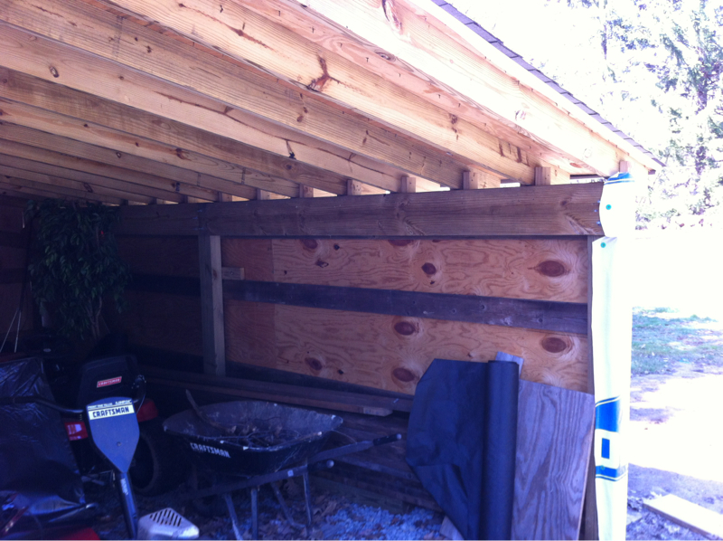

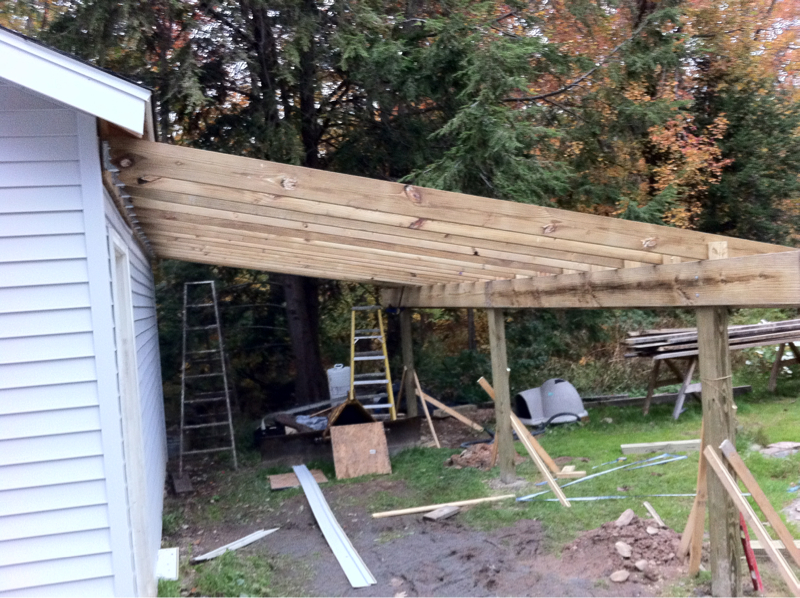

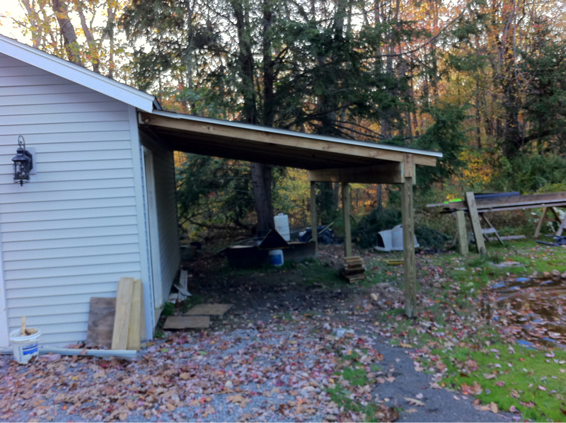

I put a shed up last year about the size your planing.Went with 4x6's post and 2 x6's for the rafters 16 in on center.Used 2x10's to hang the rafters.No problem with the snow load even thought we only had 2 good snows.I live in Pa in the Poconos so not as much snow as you get.Here are some pictures.
