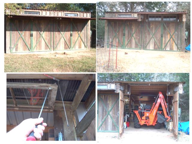

I needed an extra 10" in height on the entry to the tractor shed. Used old windows and door hinges and a rod to raise and lower the windows and a rod to slide the window latch. Works great. Now I can get some more seat time. /forums/images/graemlins/smirk.gif

That's so slick it makes WD40 look like glue!
I like the way you think. /forums/images/graemlins/grin.gif
   / Shed entry raised with hinged windows #3
Yep, good thinking, Don.
   / Shed entry raised with hinged windows #4
Great idea - I'm going old window shopping.
   / Shed entry raised with hinged windows #5
You can always use cheap shed windows. They are usually single pane glass, unlike windows for houses.
