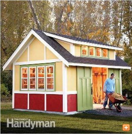

i'm looking at adding a 200-400sf shed (Say between 12x16 and 16x24) next summer to store "off season" stuff like snowmobiles and dirt bikes.
I can buy one assembled on site for a range of about $6,000 to $12,000. But I have no idea how much the lumber would be if I built one from scratch.
Are there plans with a Bill of Materials I can get quoted? Something typical like this?
   / Shed - Buy, buy a kit, make? #2
The pic is almost identical to the 12x16 I built at my old house. I overbuilt it, as it was framed like a house. I also did a 10/12 roof pitch with a nice storage loft. I had it trimmed in Azek. I wish I could tell you how much I had into it, but it was nearly 10 years ago. If I venture a guess I'd say I probably had around $4000 into it. It seemed to be a good size until I started putting things into it. I'd say go as big as you can afford.

A simple pole barn is very easy to build, and for the 6 to 12k for the one pictured you could build a giant pole barn. Like Happy Gilmore said; "big as you can afford". I built a 36'X36' garage years ago thinking it was big enough. Now I'm looking into building a 42'X75' pole barn. If I would have added another 24' to the garage I think it would be enough for all the toys/tools I keep getting.

I would build it if you have time and tools! It's fun and cheaper and you will have a stronger, better shed and can customize. The last one I built was 12 by 16 ft. I would stick with 4ft or 8ft increments and then you end up with virtually zero waste when it comes to plywood, joists, etc. A little layout/planning on build is great to minimum waste/cost.
I found some heavy office doors and a throw away window to keep the costs down. Built it with typical 2x4 frame construction. T1-11 siding (or whatever it's called). Built a stick framed roof (4/12 or 5/12 can't remember) with cross members higher than sill (if that makes sense) and put cedar shakes to match my neighboring house. Keep the pitch reasonable and minimum overhang to minimize materials. Don't have to go that fancy for roof for sure. Also make the door extra wide and tall as you can. Built a nice gentle ramp to drive stuff up into the shed. Built it on blocks so there was plenty of air circulation and if I ever had to move it. Good luck! A great project! :thumbsup:

I would build.
Never liked kits. Always wanted to do things my way.
As for price, depends on how fancy you get. You putting posts in the ground? or building on skids? Are you buying the "shed" trusses? or just using rafters.
I'd venture a guess that you wouldnt have more than $1000 in lumber. Another ~$1000 in all the metal and trim. Then its just the doors and windows that you want.
