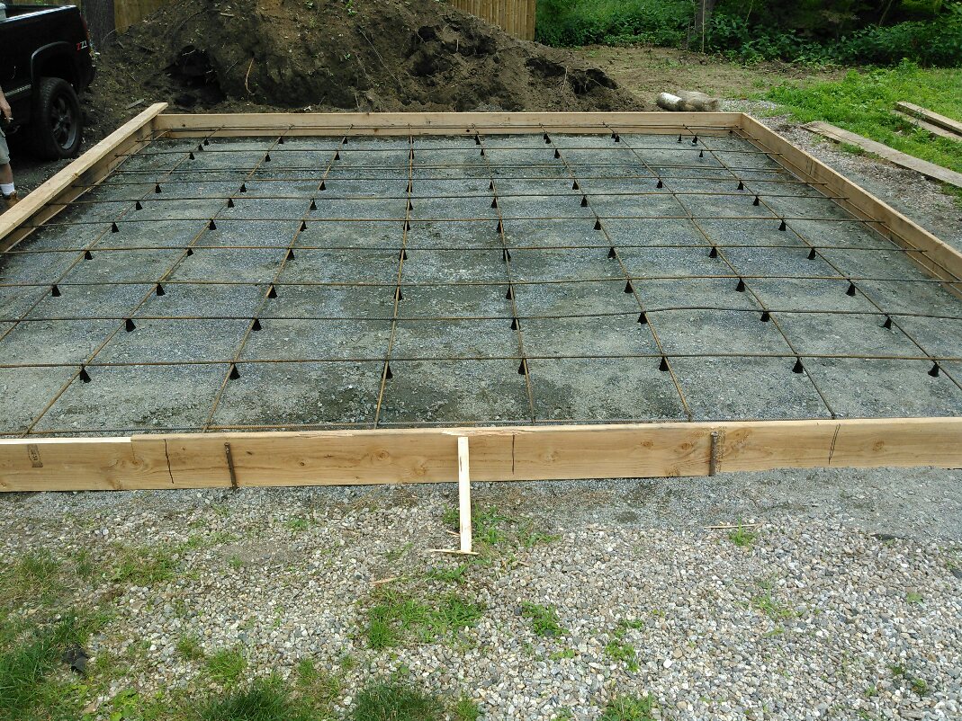

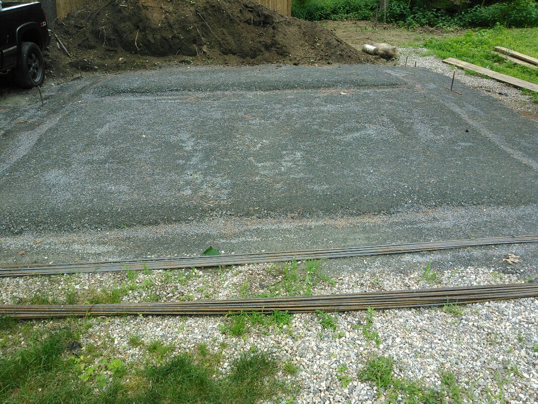

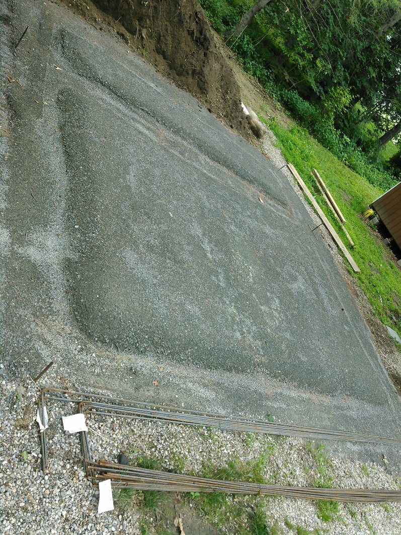

Well after looking at so many other posters and there projects on here i figured i would try to post my current "part time" project. I'll start with a little back round. This shed i am building is for a really good friend of mine who gives us a hand on other projects. As a Christmas bonus i offered him cash or to build him a shed of his choice. He buys the material and we build it. I think you guys can figure out which he selected. His old shed was finished. The total foot print will be 20'x20', of which 14'x20' will be the shed and 6'x20' will be his covered wood storage area.
I didn't get any pictures of the excavation :( sorry. We started by removing all the organic matter/ crappy material. (Thats the pile you can see in the back round) To bring the pad back up to grade we need 50 yards of process. Yes guys it was compacted in lifts.:laughing:
This is a couple pictures of the process in place ready for the forms.

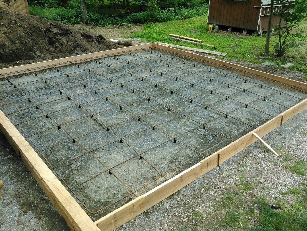

Now a couple pictures of the forms set and the rebar.
Tomorrow morning we are pouring the slab so i will try to get some pictures of that.

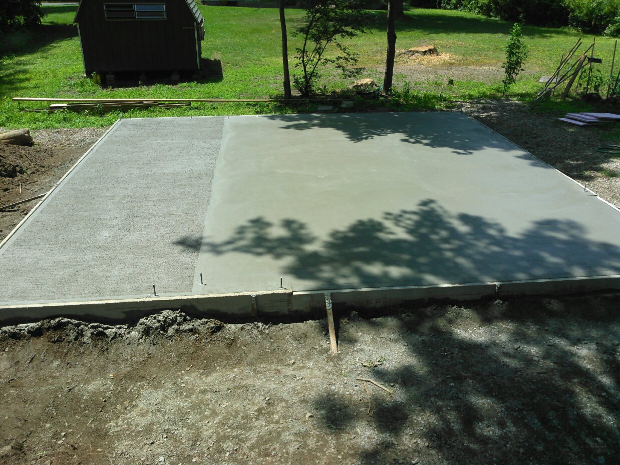

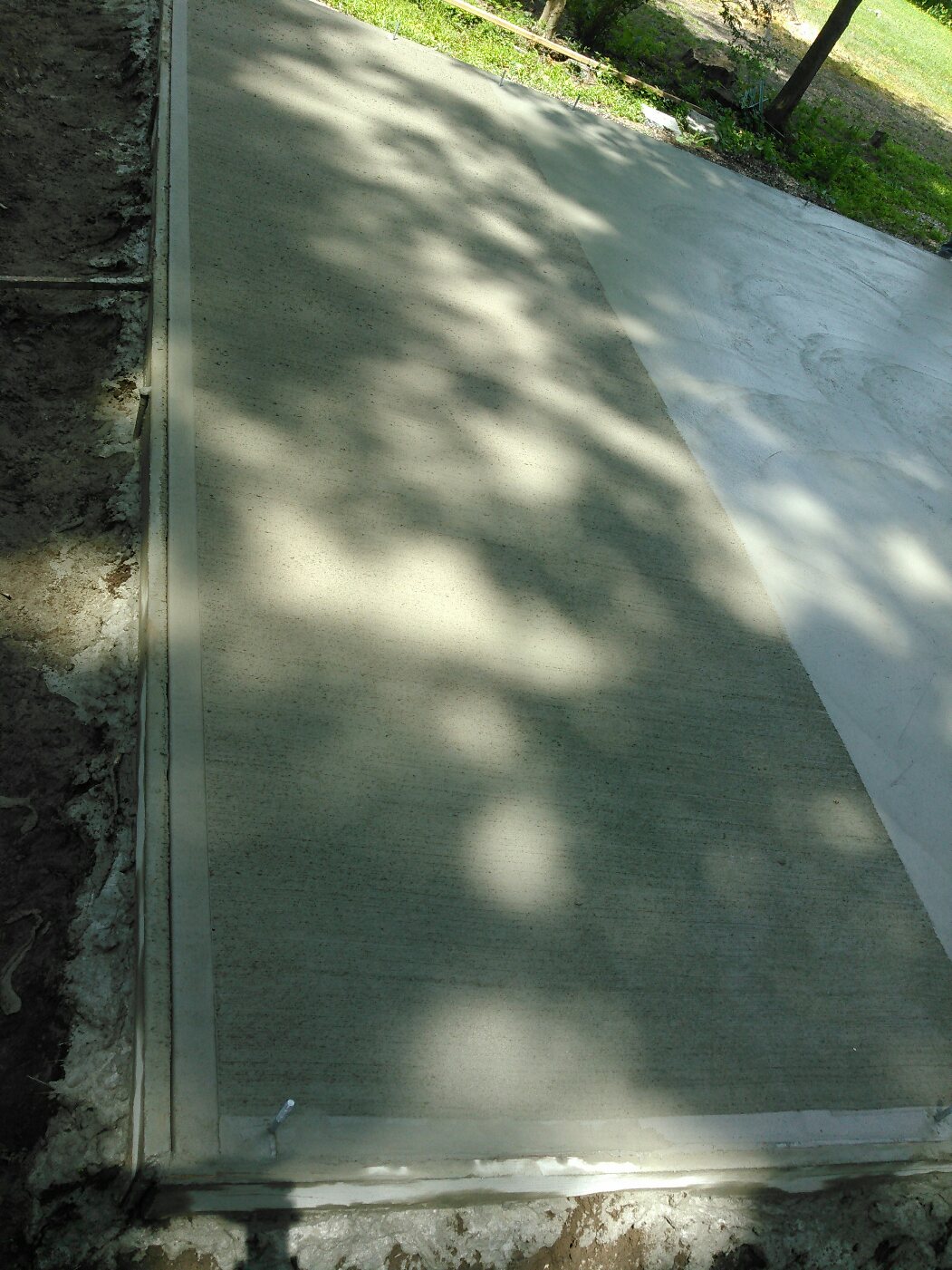

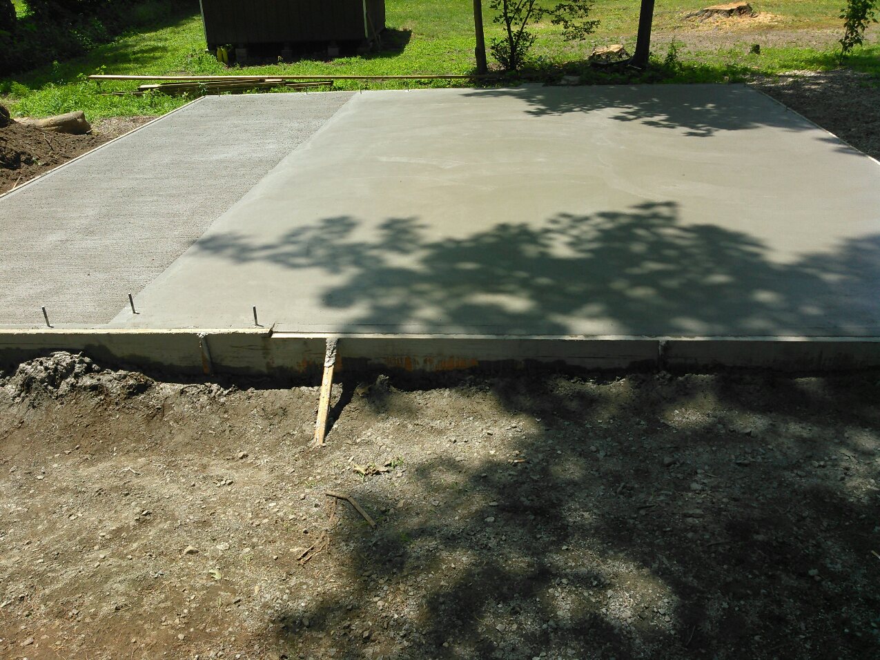

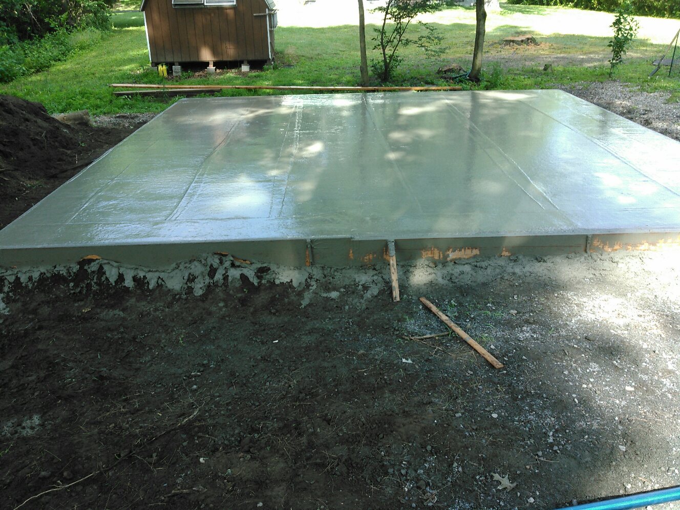

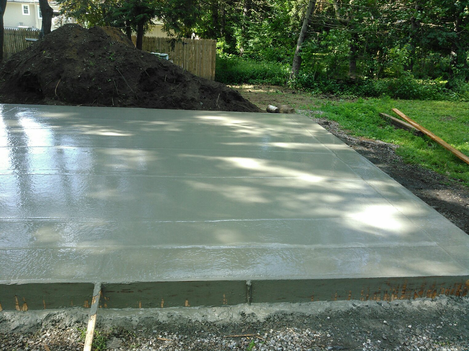

Today was time for the pour, I wasn't happy when the driver showed up and he told me he had a 5 slump already on the truck i would have liked to been around 4-4 1/2.It made it a lot less work for us but not what i was looking for. Once we start pulling the concrete about 2' in i notice about a baseball clump of fiber so i pick it up and chucked it behind me. We pull about another 2' and again another baseball size clump of fiber so i pick it up and looked at the driver with it in my hand.:eek: . He knew i wasn't pleased at that point. We keep pulling and more and more clumps i would say about 6 in total that we saw. :muttering: I asked the driver what the **** is going on. He told me he was pulling out of the plant with the load and they forgot to put the fiber in so they called him back and added the fiber after the fact. So my thinking is in order to try to get the fiber to mix " well " with the load they added water which is why the mix was so wet. Guess its the last time i use them.:punch:.
Ok now onto the pictures:
This is after the first time we hit it with the bull float

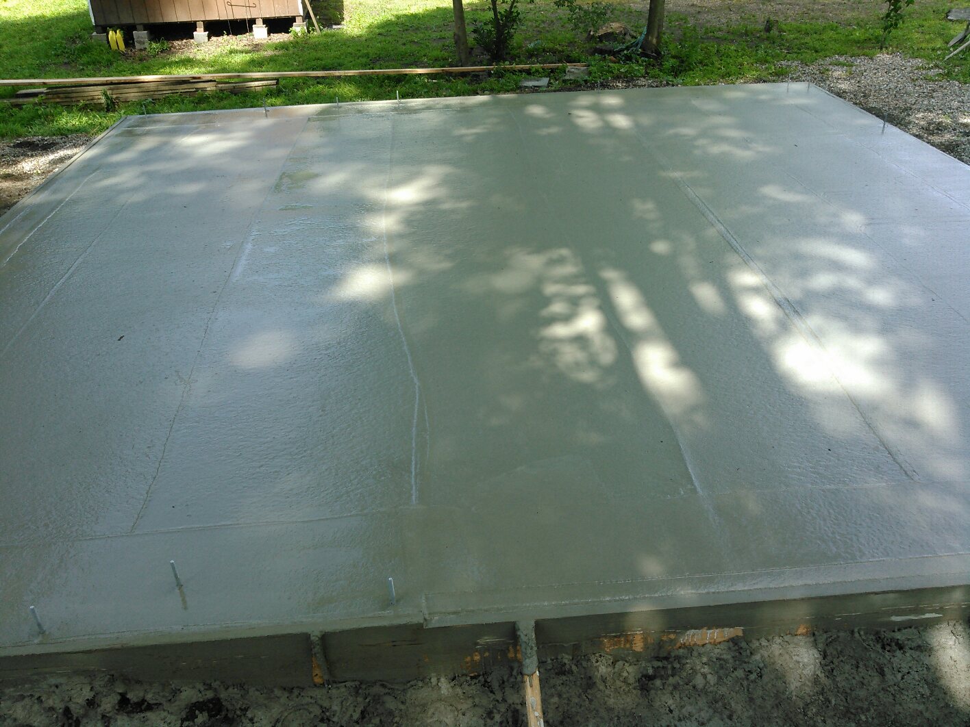

This is after the second time with bull float which we followed by adding the anchor bolts

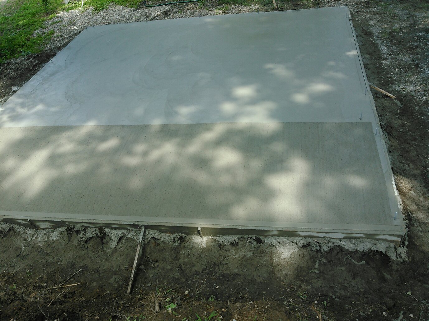

Now after the first time we hit it with the trowels and added the broom finish for the covered wood storage

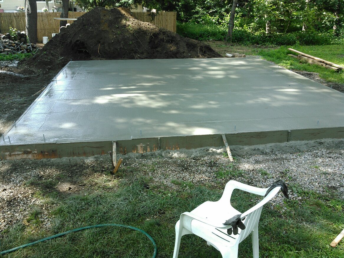

Final trowel finish and now complete
We finished up by covering the slab with plastic.
All is all it turned out well and very pleased with the results

Very nice. Love seeing the rebar on chairs. In my opinion, that is the only acceptable way to do it!!!
I've gotten lazy on using the anchor bolts when pouring and just drill them after I stand my walls up.

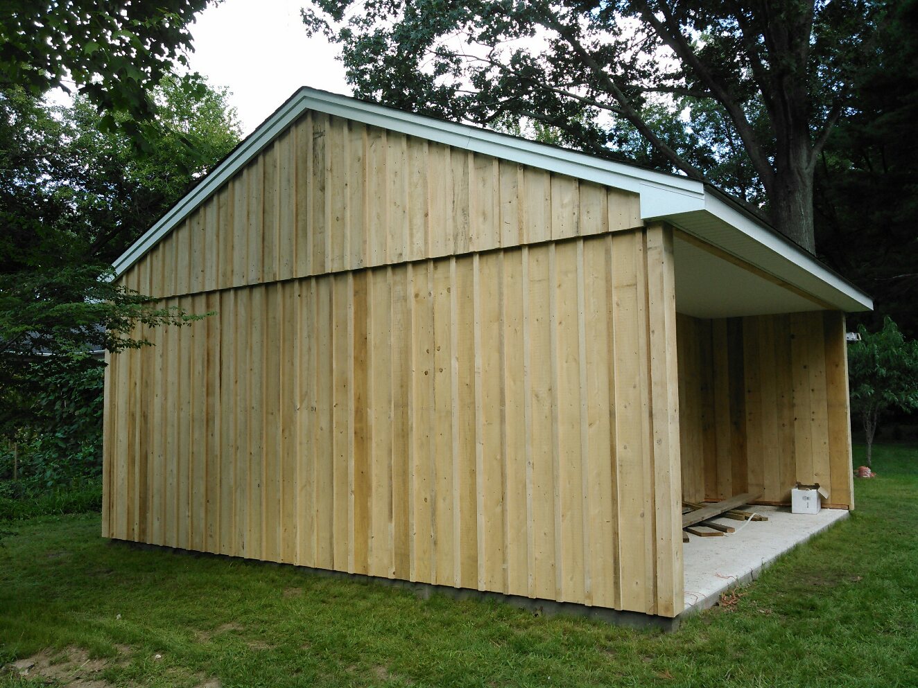

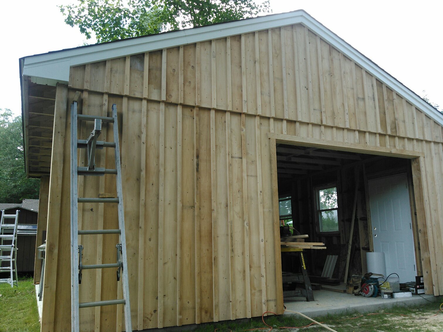

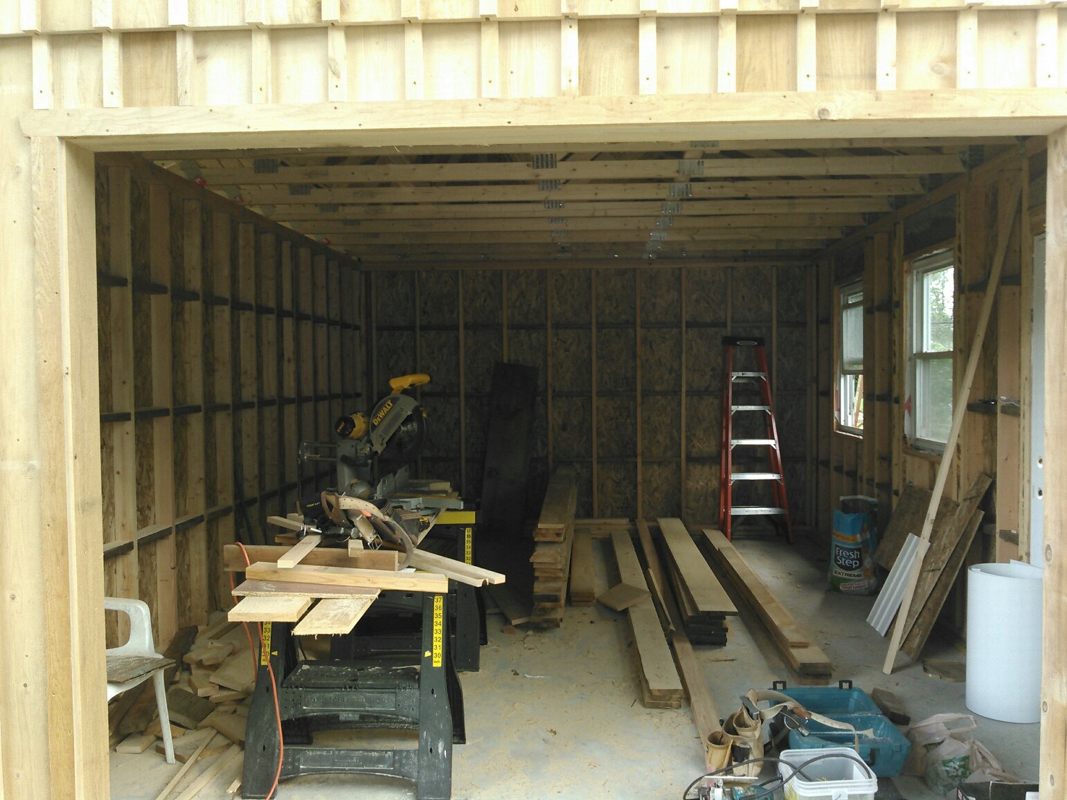

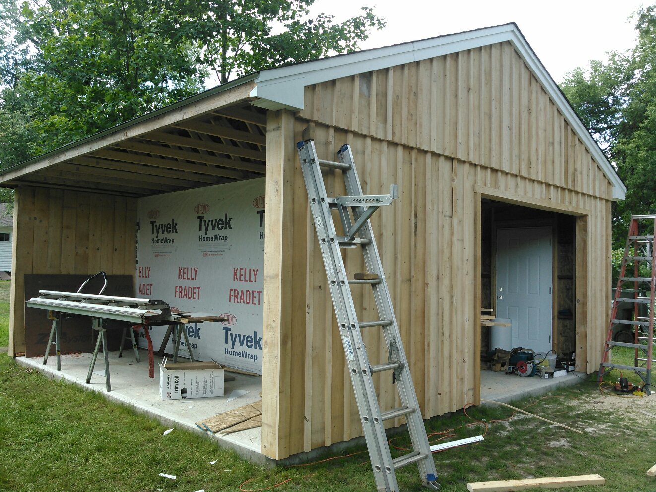

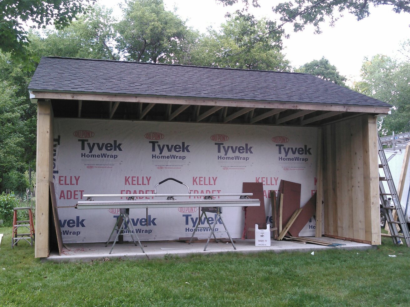

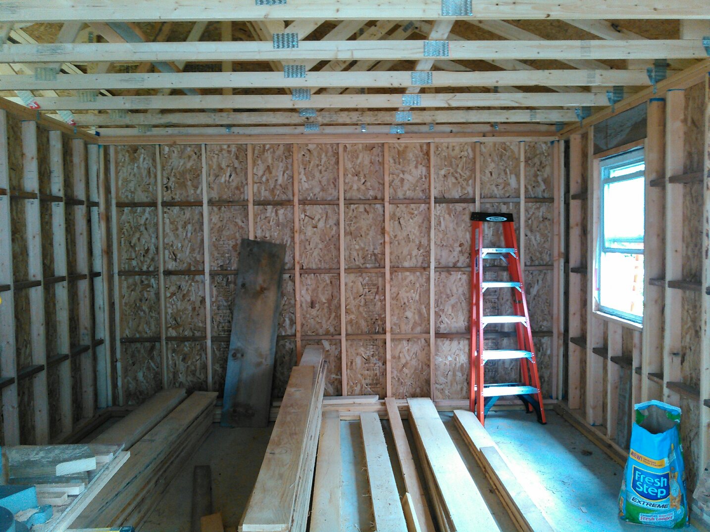

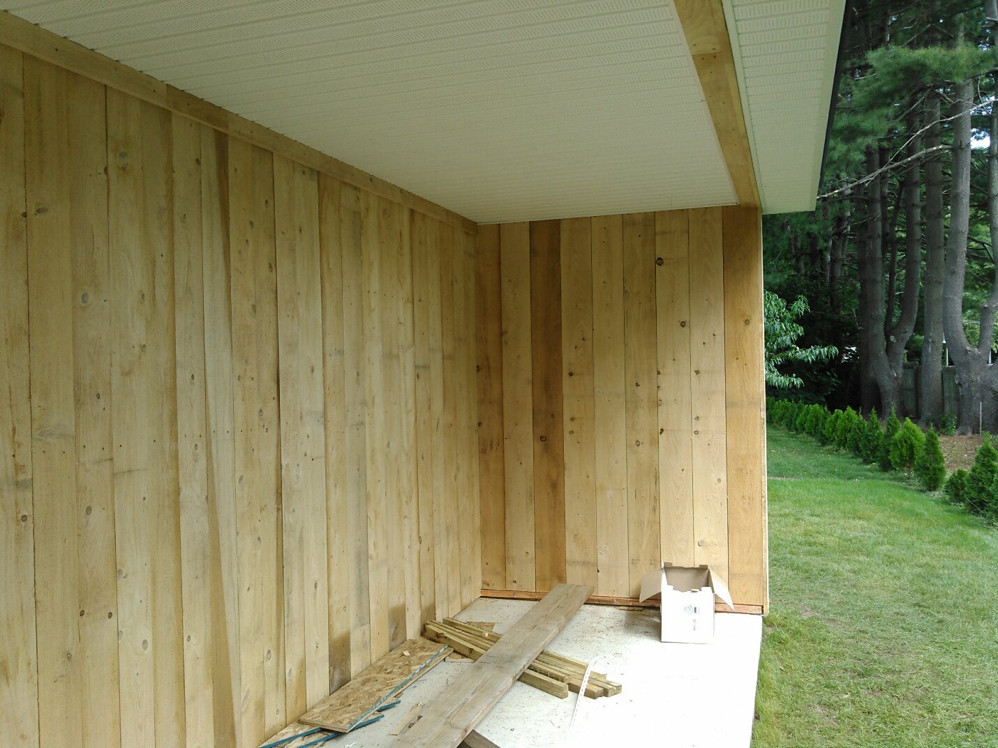

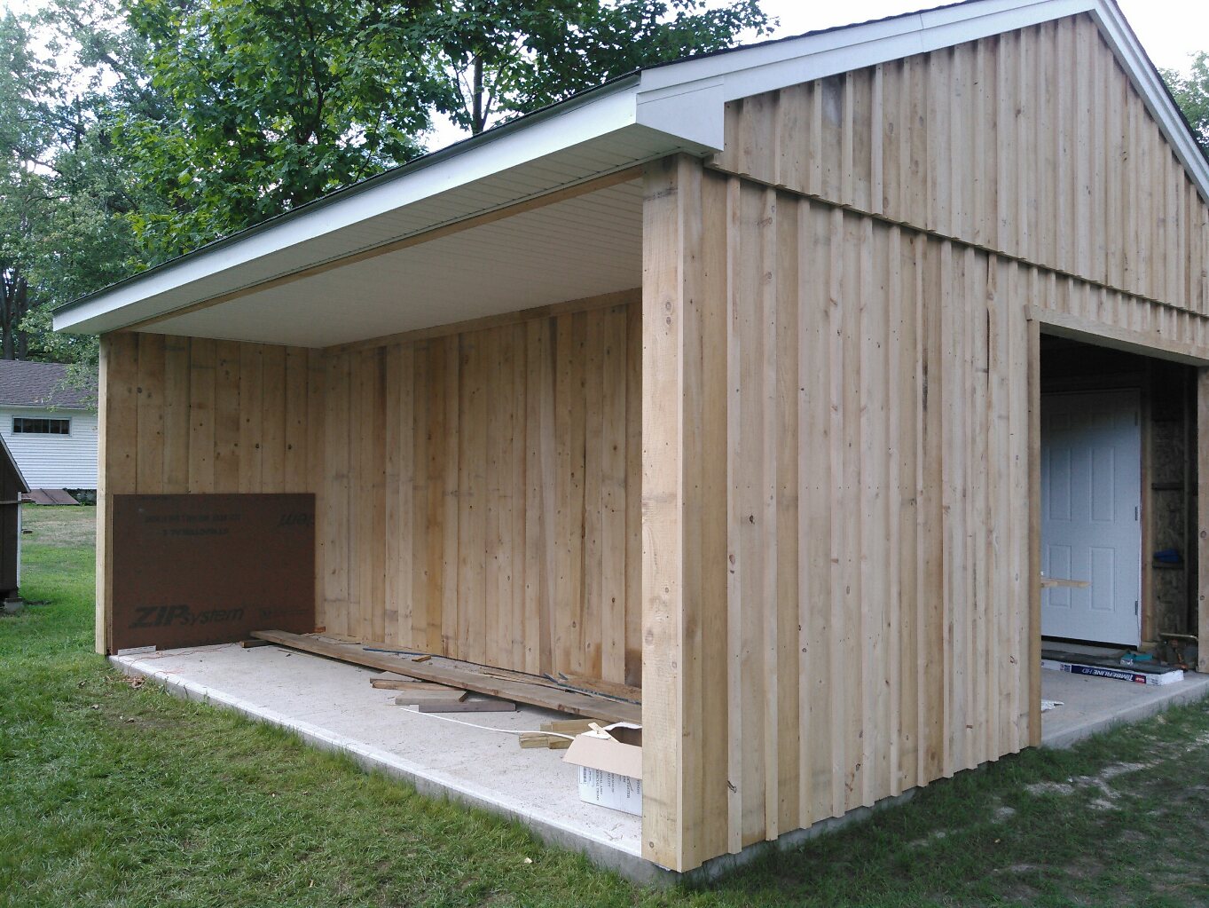

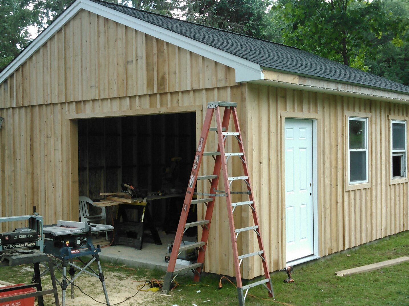

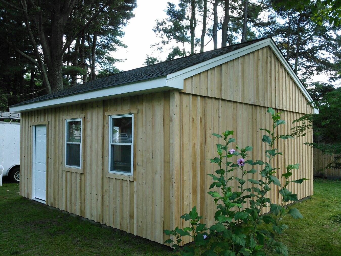

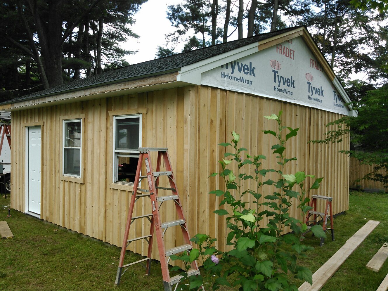

Ok time for an update, we had a few days free up so we have been able to get some work done on the shed. We should be finished with the siding and aluminum trim tomorrow. We are using hemlock rough sawn for the board and batten. I forgot what a pain in the butt it is to install you need alot of blocking to be able to attach it. The hemlock was just sawn about 2 weeks ago so it was nice and green. Now you can clearly see which area is for wood storage and which is the shed. Hope you enjoy the pictures.KIMG0236.jpegKIMG0237.jpegKIMG0238.jpegKIMG0239.jpegKIMG0240.jpegKIMG0241.jpegKIMG0242.jpegKIMG0243.jpegKIMG0244.jpeg

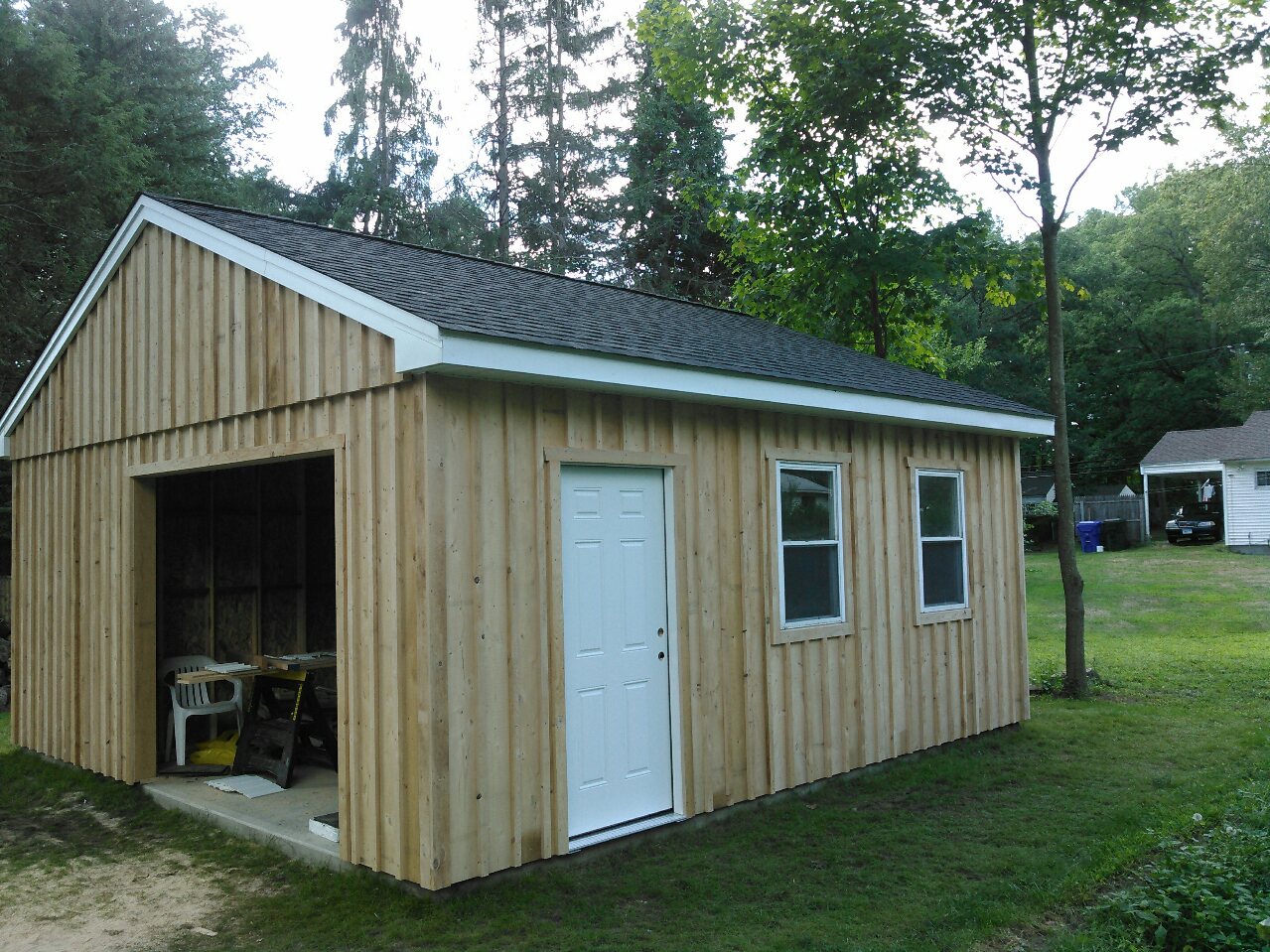

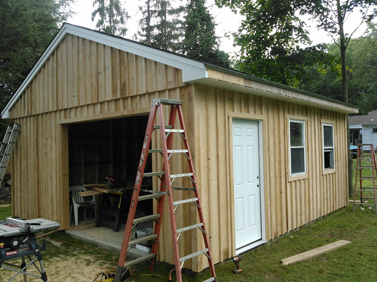

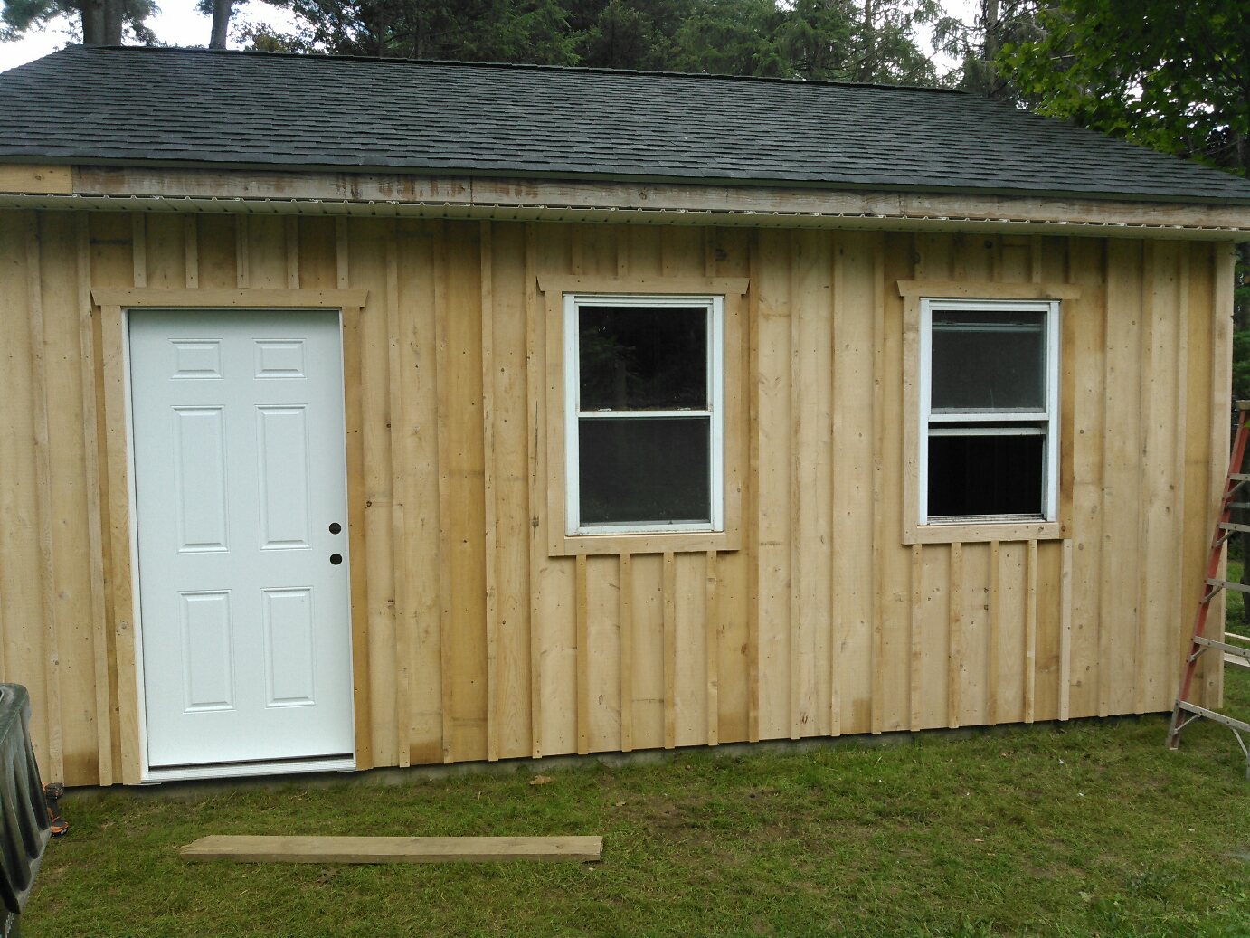

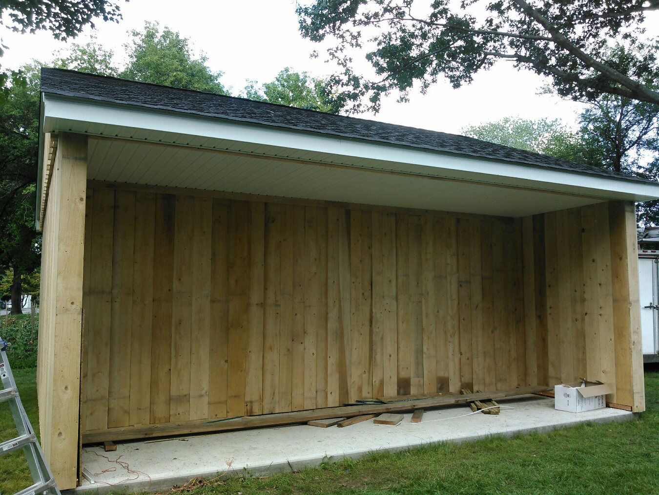

Its finally done siding and aluminum trim wrapped up today. Just need to install garage door and gutters. I don't think it will be able to be stained this year with the wood being so green.

Very nice! And the hemlock is naturally bug resistant so hopefully it will last a long time!
/ Shed Build #16
Beautiful. I've never worked with hemlock, but I sure do like the way it looks!!!!
