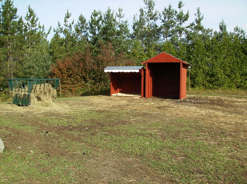

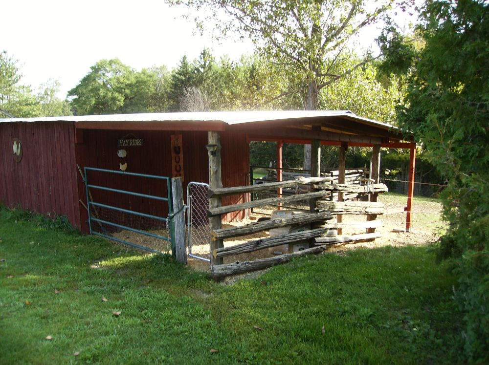

Here's some more weekend projects.
1. We made a "car port" type addition to the Donkey shed. It's 12 wide by 25' deep and had multiple gates so we can isolate animals if needed.
Our ground is all rocky so the BH was great to dig holes for the posts and level the area out so the grade was more even.
2. Hay shelter. I made the run in shed previously but was sick of wet hay. So, I made a shed to go over it. I pulled the hay feeder out to paint it yesterday but it fits great and there is just enough room all the way around for the animals to get in there. Used the BH to dig a trench (shallow) and the shelters are both attached to buried heavy timbers.

Nice sheds -- when you say buried heavy timbers were they treated in any way? I have been using flat rocks for woodshed foundations and the like and am thinking about buried six by six treated for the back of one shed.

You said you buried timbers.. could you explain some more info about that ?

Regarding the timbers. I took Pressure Treated 6x6's and buried them under the front and back walls. Then I spiked the bottom plates (PT 2x4's) of the walls to them. I figure that is not bullet proof but they will really settle into the dirt (and freeze there in the winter). The top edge of the timbers is flush with the surface height of the soil.
The little lean to in the photo has been rolled over 2x by the wind in bad storms but just barely (before there were timbers). The timbers should give enough anchoring to prevent any more problems. If the wind is so strong that they are not enough, then I'm out of luck because probably not much would help with little sheds like these. I will spike some heavy steel bar such as rebar through the timbers to give extra anchoring but I have not got around to that yet.
With regard to the hay, the sheep and goats pull so much of it out it's very frustrating. It was worse when we had the few cows, but the waste is awful. We have tried darned near every type of feeder and short of flake feeding small square bales (which is quaint but a pain) I have at least 25% waste. It's not really waste as I compost it but still it bugs me. I hope the small shed will reduce this as the animals can't really spread it as much and they have to mostly stand to eat vs lay down in a nice hay bed. We'll see if that works but already I'm finding less soiled hay on the ground and that I re-feed or give to the poultry in the aviary.
