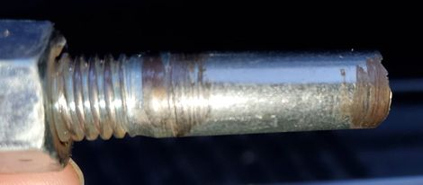

The original bolt has wear and damage at both spots where the holes would touch the bolt Is this normal wear? Notice how the PTO shaft has wearing on the front of the hole on one side, but on the other side it is at the back of the hole. Is this normal?

I am including photos of the original bolt and images of the PTO shaft and Gear Box shaft holes from both sides. Your advice and wisdom is appreciated.

Sounds like there is either a high spot on the rotary cutter shaft itself, or the pto shaft has a burr or something in it that is preventing it from sliding all the way back to let the hole line up.
I had the same issue when installing a new pto shaft on my old bush hog. I had to get out a file and some sand paper to knock down the high spot on the bush hog shaft before I could properly seat the pto shaft and get my new shear pin in place

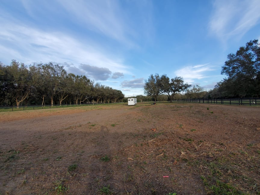

Reposting 2 photos, now labled and images of the absolute worst pasture anyone has ever had to mow.... it's a wonder I don't roll my tractor or break a shear bolt every time I've mowed it.

I know many rotary cutters use the same gear box for drivelines with a slip clutch and those with a shear bolt. When a slip clutch is used a Grade 8 bolt is substituted for the normal softer shear bolt. This is what you have going on. I had a friend who had a rusted slip clutch and broke the Gr8 bolt on his rotary cutter. Good thing it was not the gear box. My boss had a rusted slip clutch and took out both blade gearboxes on his 8'.
To me those pastures look like a dream to mow. Nice and smooth and flat and square.
