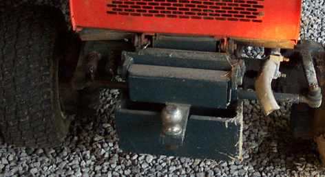

HWP,
I have got a F3060 and I love it. Was wondering if you have tried or heard of putting some kind of a simple hitch on the back to pull a fertilizer/spreader or a lawn sweep.
Thanks, Jerry
   / Sharpening Tiller Tines
Hi Jerry
Yes I have a hitch, it bolts on to my suitcase weight carrier. Two bolts and its on or off. I use it to pull my utility trailer, spreader and aerator. I took a picture to attach but I need to reduce it to 100K and I don't have the software loaded to do that just now. I'll post a picture later.
Howard
#9
Attached is a photo of the hitch setup on my machine.
