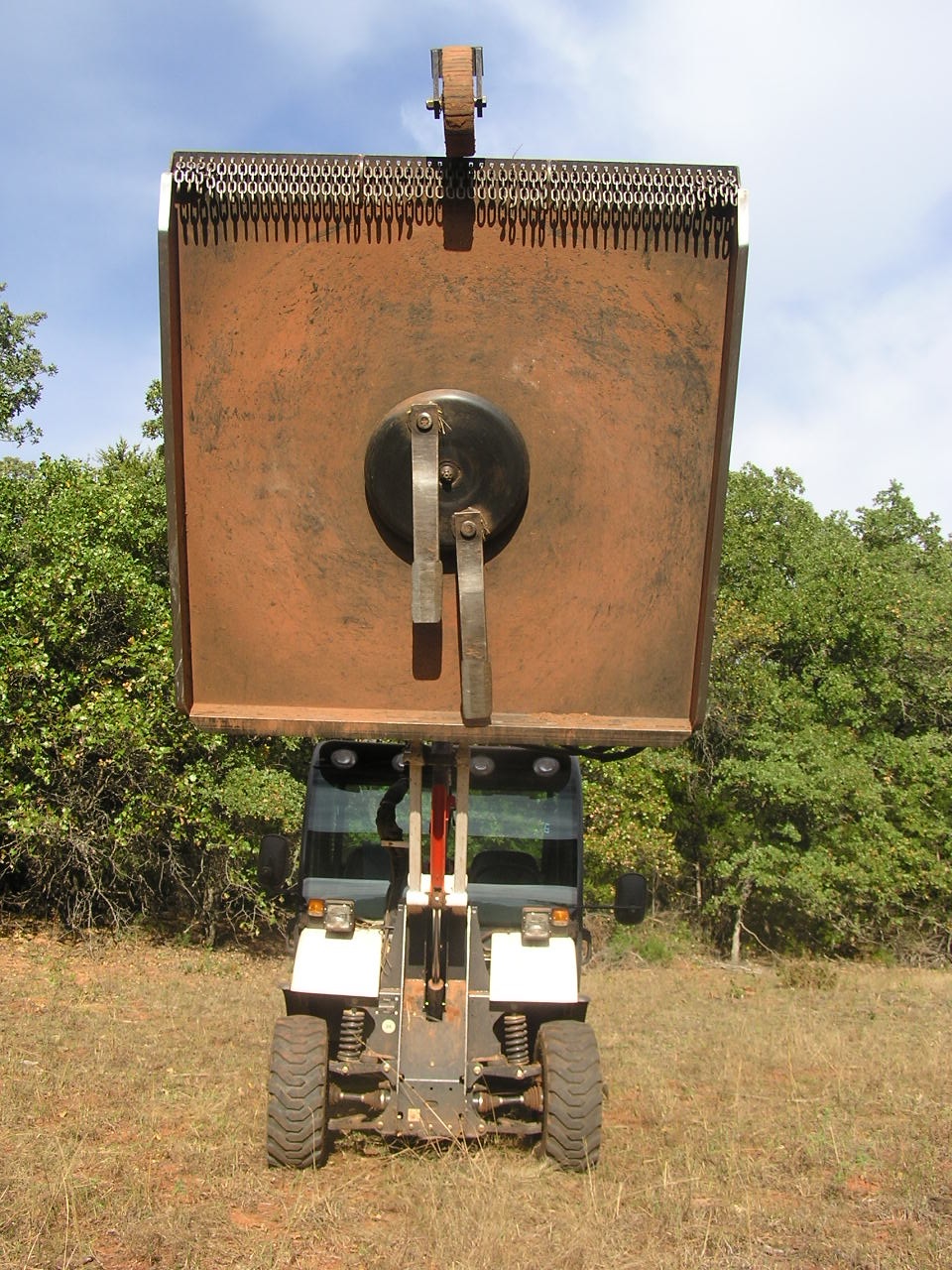

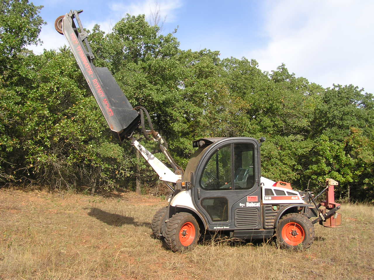

What position is your shredder in when you sharpen blades?
We have two different units. I prefer to stand one on the 3 point and the other on its side.
How do you sharpen your blades?
I just hit them with a grinder trying to follow the same angle / bevel as they come with while extending the cutting edge a pinch more each time I sharpen them.

I sharpen the blades on the tractor. I use the top-n-tilt to raise the bushhog to maximum height and then put heavy duty jack stands under both sides in case the hydraulics leak down. As the previous poster's video indicated I use a board and a c-clamp to restrict movement while I grind the blade back to its original angle. I try not to grind too fast to avoid overheating, and try to use about the same amount of grinding time on both sides to maintain balance. I also inspect for cracks and discard both blades if I find any indication of splitting. If the blades need a lot of work, I will remove them to a vise for grinding and then use a scale for balancing, or buy replacement blades if I think they are too worn.
I lost a friend from being pinned under a bushog while sharpening the blades. Trust me! Farm machinery can, and will kill you, if you don't respect it, always think safety first.
