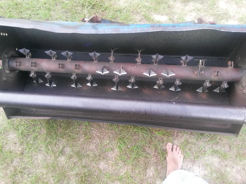

I have a very used Ford-917L 48" flail mower. I use it 90% to mow an acre of mixed bahia and nut grass. I've kinda half way sharpened the 39 blades a few times, and it seems to help a little; but this time I've decided to take each blade of, sharpen it, and make sure they are tightened down real good. My question is how sharp to you try to get them?
How much can you grind them down before you replace them?
Do you guys with flails actually like them, cause mine seems to mix the poor quality of cut of a bush hog, with the weak cutting power of a finish mower.
Edit: my complaint is mostly it seems to only knock the seed stocks over more than cut them. In heavy grass I have to go over at least twice to really get it cut.

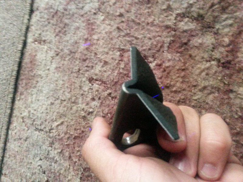

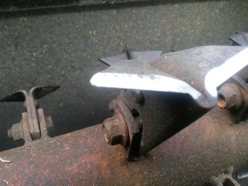

ARE YOU GRINGING THE BOTTOM EDGE?????? it looks like it. you have to grind the top edge.
   / Sharpening blades
Really? Are you sure that's right. I'm not saying your wrong, I just assumed that when looking at the geometry, the bottom would be where you grind.
   / Sharpening blades #7
When new the steel blank is stamped with the mounting holes and separated/sheared
from the continuous steel blank then ground and then bent to create the bend for the
mounting holes to create the scoop/shovel end from what i remember of it.

Well... I feel really stupid... after sharpening all the blades; adding #00 grease, and tightening the belt banjo string tight, still cut like crap. Adjusted hight of cut; even took the roller off to get lower cut. Still cut like crap. So... I got to looking at it again... then I watched the belt pulley turning, and realized the blades/duck feet/scoops/whatever where actually all on backwards....
I don't know if I put them on backwards after sharpening or if they had been backwards for last 3 years. I think I put them on backwards; and the new tight belt and sharpening is what helped vs couple months ago, but I'm not 100% sure.
   / Sharpening blades #9
I didn't see anyone else mention it, but the mower sure is missing a number of blades. A blade should be mounted to each of the tab pairs. The mower will not cut cleanly and evenly in that condition.
   / Sharpening blades
I can't seem to see my own pictures; but maybe I had some off to sharpen when I took the picture. It does have all the blades, but thanks. I thought it holds 39, might be 40... 4 rows of 10.
