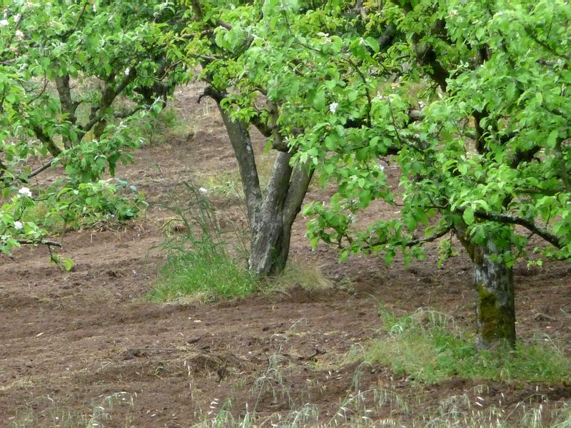

I agree that cutting first is the best general advice. But this is a special application where the mower wouldn't work well. I will use the little tractor and 5' tiller to finish up the tight spots where the 70hp tractor won't fit. I just took this picture.
The big tractor did fine going East/West but the North/South aisles are so narrow that he just made a single pass per aisle. I need to finish it up to look like the last picture below.
Following are photos I posted last year of the same process. The tiller turns weeds under much better than the disc, but as sixdogs noted it loads up. The worst part is tough blackberry vines that need to be knocked down so the harvest crew doesn't find them growing all through the trees.
I have a tiller cleanout tool that works pretty well. I took a hooked linoleum knife and hammered a piece of light conduit onto its handle so I can reach the center of the tiler from either side.
So back to my question, has anyone ever sharpened tines to improve the slicing action? I've heard of farmers sharpening disc pans before discing but I wonder if the tiller would dull so soon that sharpening is pointless.

I think your right, it will dull so fast, it would be pointless.

Tines wear thinner and shorter with time, fast enough. Makes me pause to consider taking any metal off them intentionally. Agree with the others that the edge would be beat dull very quickly anyhow.

Cal ...When I first got my 1400 tiller all patched up and working I used a 4" grinder and sharpened the tines ...after about a days use they were back to the way they looked before all that work. I see no difference today with the "dull" tines.
