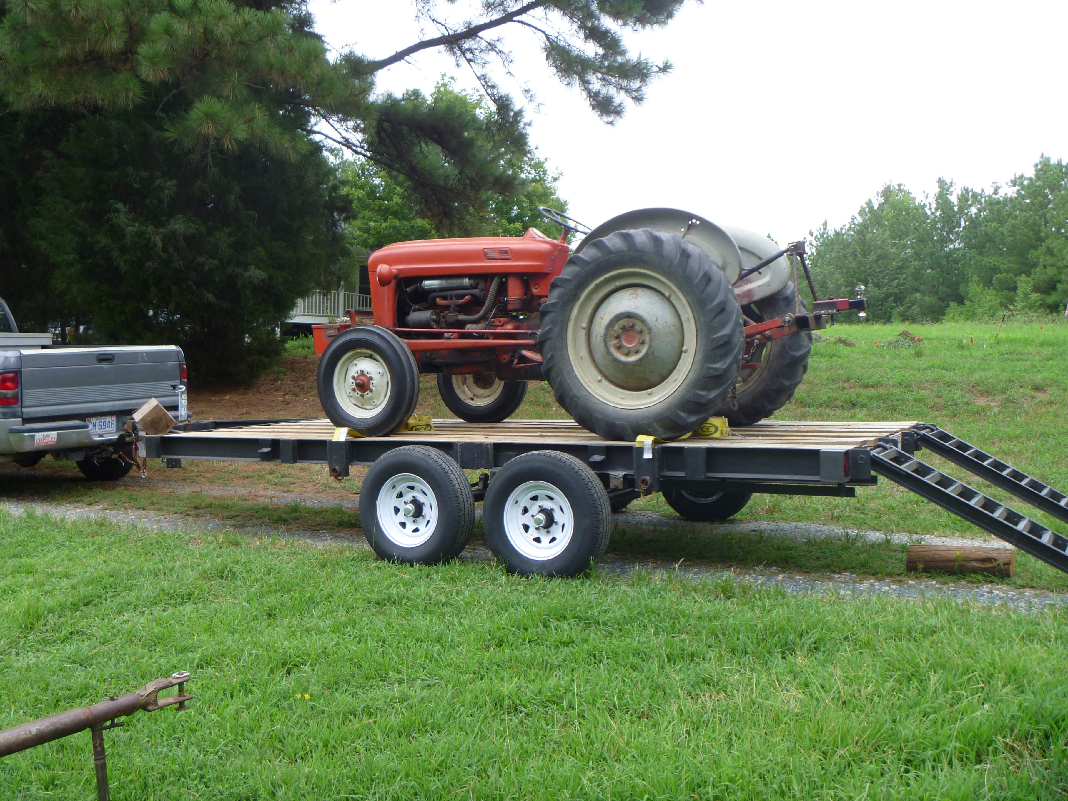

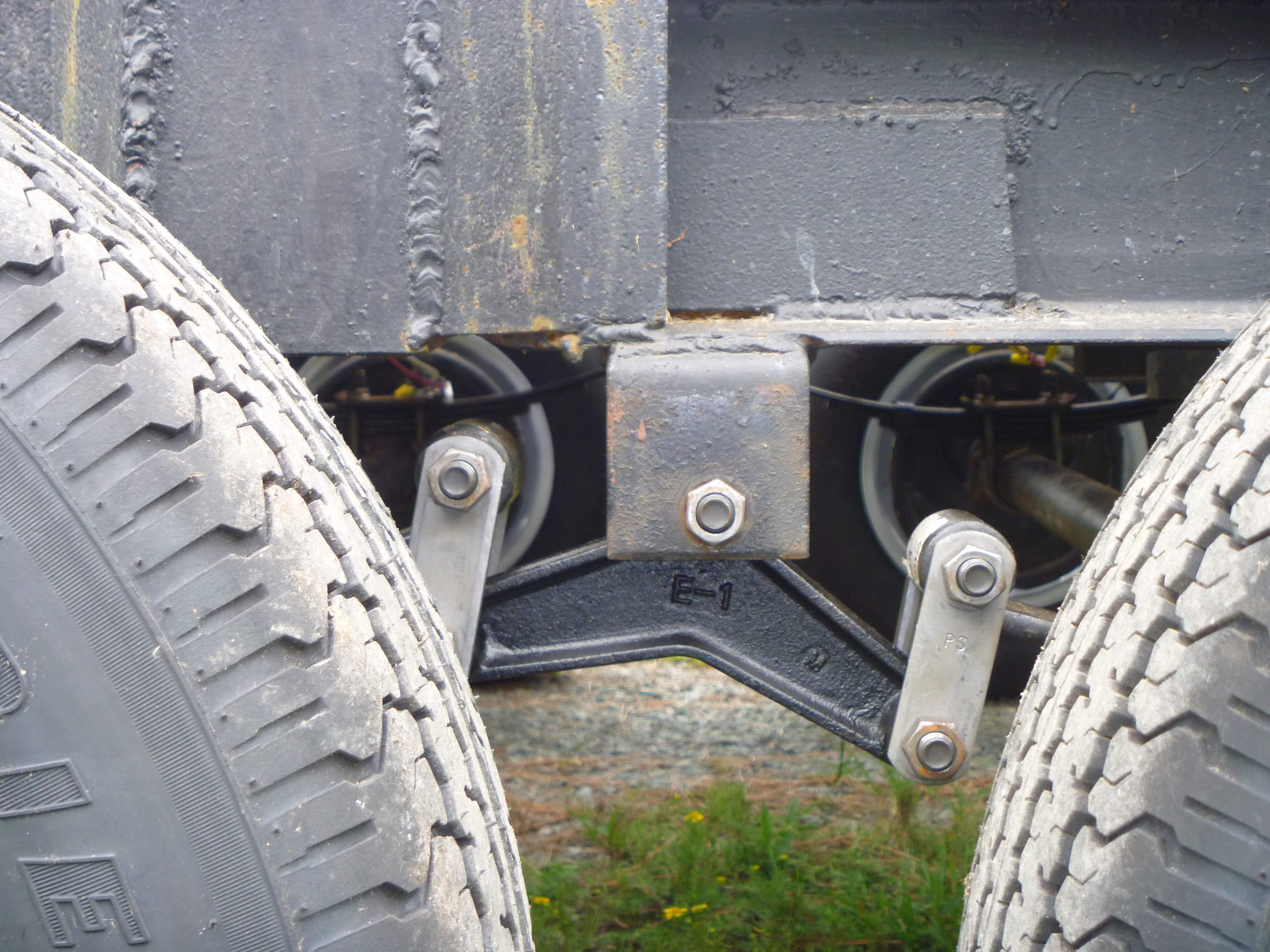

Well, I did buy that kit consisting of longer shackles and equalizers and it did the trick. :thumbsup:
Photos show a reasonable (I think) angle for the shackles with my 3000 lb tractor on the trailer. I think the conversion of MH axles/wheels to commercial is finally over and successfully at that.
