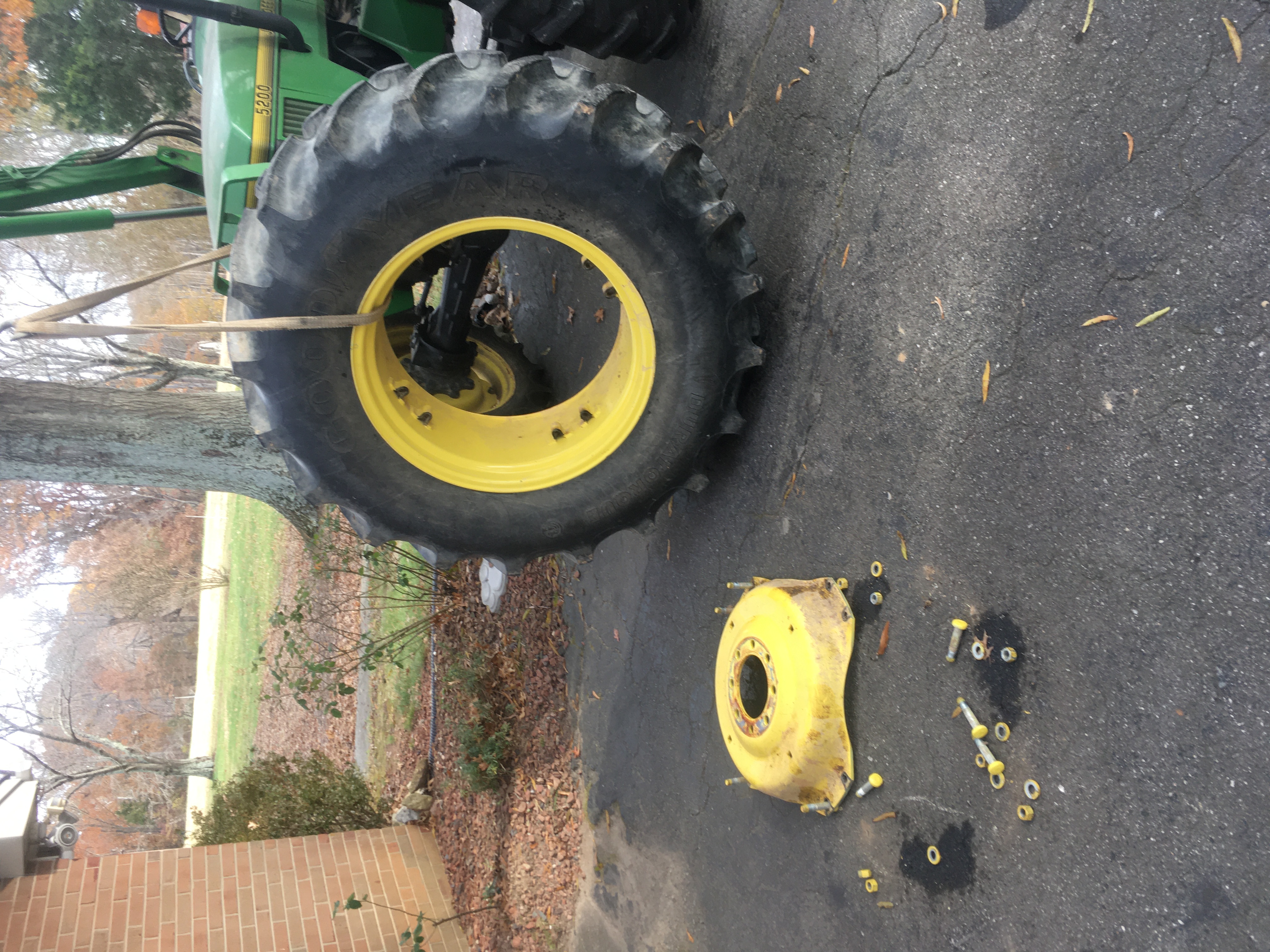

Depending on the wheels you have... Looks like the wheel is a two piece system. Remove the wheel from tractor. Dismount the center dish and remount to place the tire at your desired spacing. You might have to reverse the dish and swap tires side to side to maintain the correct tread direction. Wheels from the factory are usually set narrow to ease transportation.
Moved my rear tire center line from 60 inches to 68 inches. That 8 inch doesn't seem much difference but...I can vouch that the few inches difference makes a tremendous improvement in stability.
