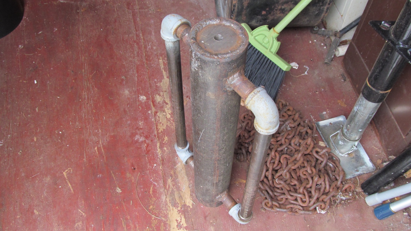

Tried my FEL but that was a failure.
I made a DIY 'post pounder' eg a 3-4" pipe with handles and a heavy slug of steel at the top end.
That works just fine 4 me.
One advantage is if the T bar goes in crooked you can persuade it back to vertical.
For handles I used Rbar for better grip.
PS, also available ready made in the less than $50.00 range.(LOL, but I like welding projects)

I made my own driver also. I haven't weighed it but it's at least 10 lb heavier than any store bought model I've seen. Drives em in with a lot less effort. Especially when it has a son-in-law holding it. :)
