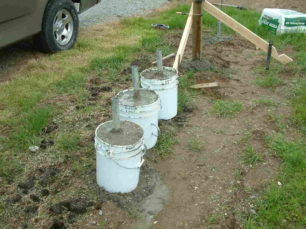

I have a 4-ft King Kutter BB that I use with my 21-hp B7510HST.
I'm landscaping about 3/4 acre around my new house. I need to scrape off the weeds/turf and get to bare ground without bringing up a lot of weed seeds. I removed the rear blade and beveled the bottoms of the two side plates so the BB will want to dig into the turf. The BB tilt is adjusted to make the front about 1/2" lower than the rear.
The key to making any BB work properly is weight. My BB only weighs about 245 lb, which is puny. So I have three 120-lb concrete weights (5-gal plastic paint containers filled with concrete) that I can load onto the BB.
