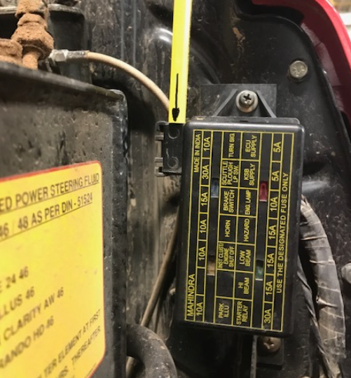

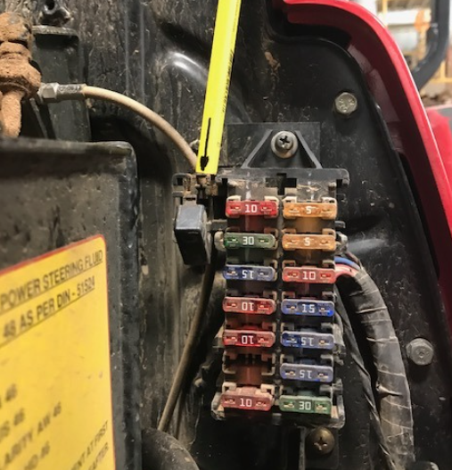

Service light and buzzer reset for Mahindra 8560 4WD tractor.
This procedure will reset your service light and annoying buzzer.
Open the hood and find the fuse panel on the firewall. It is in the upper right hand corner (when facing the rear of the tractor), just behind and to the right above the power steering reservoir. The reset terminal is next to the fuse cover, on the upper left side. Remove the fuse cover, then open the small cover and follow the instructions below.
Use a spare fuse (under the cover) or paper clip bent into a U shape to short the terminals.
1. Open the small terminal cover.
2. Put the key switch to the “on " position.
3. Wait a few seconds.
4. Bridge across the terminals for a moment using fuse or wire.
This will silence the service light and buzzer.
