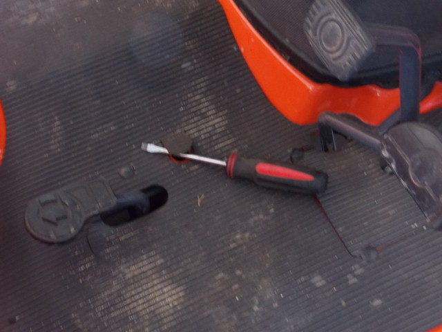

Good luck with your new tractor. On my BX-25 there is a lube point for the HST pedal that often gets overlooked. It's hidden under the floor mat. I don't know if you have this lube point on your tractor. However, if you do, they recommend that it gets a shot of grease every 50 hours.

Yes I have that grease nipple... zerk to American readers??? Will be sure not to overlook it :)
