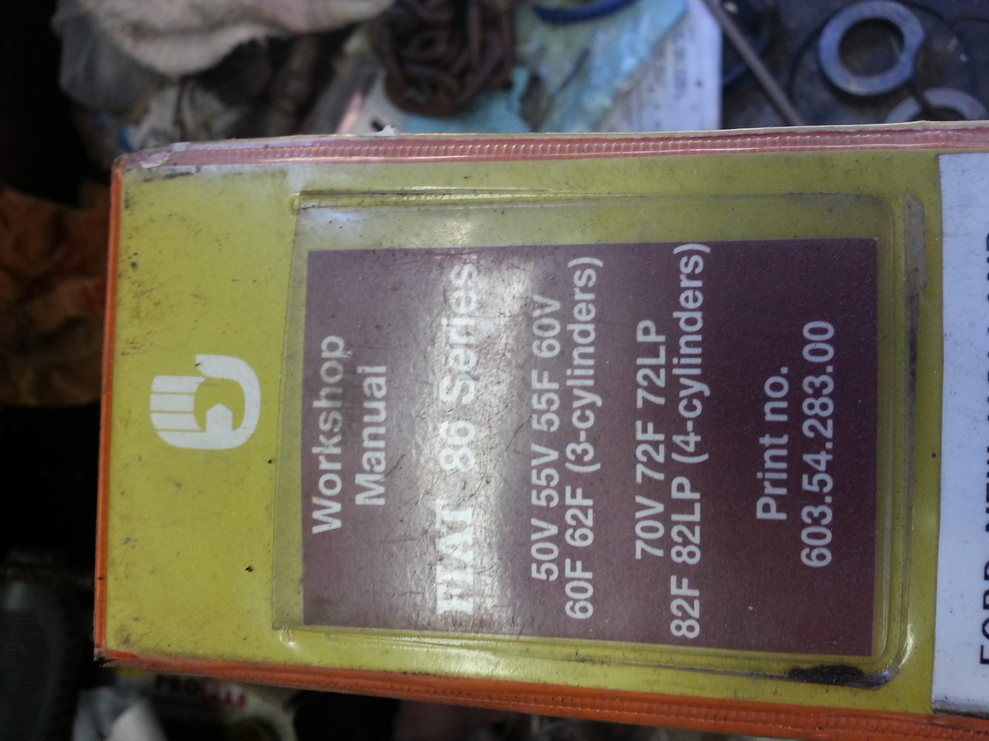

Gared, the 4430 was actually a FiatAgri or Hesston 80-66 and that was the service manual used for the 4430. Even when the 4430 was new, that was the only manual available. I have one and will research how you might aquire such. Meanwhile, Jensales has one under Hesston: http://www.jensales.com/Hesston-8066-Tractor-Quick-Reference-Manual-HES-QUICKREF_p_72831.html. As it's title indicates, it is an abbreviated version, but might be what you need.
I checked the manual I have and cannot find one online. If you need some info. Let me know. The picture is of the one I have that Ford New Holland originally supplied. 20130811_085324.jpg
