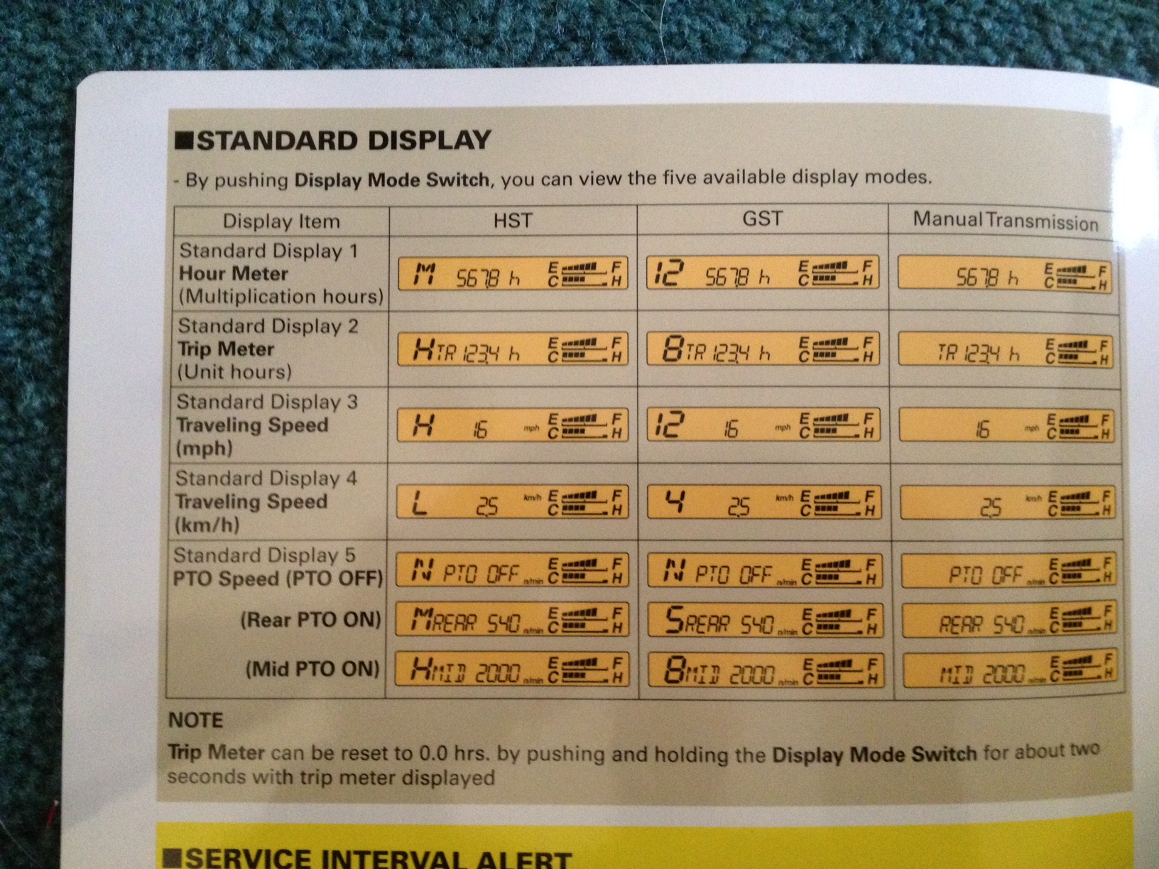

To reset the service indicator requres the menu to be in "Hour Meter" display. Push both the DIsplay Mode Switch and Travel Speed Switch.
In the event you didn't get the glossy document on the IntelliPanel.
Standard Display:
Service Interval Alert:
Good luck wit the new tractor. I really enjoy my L3130

I reviewed the workshop manual and couldn't find anything related to the display not resetting. As someone stated above the wrench is only for the Service Interval and does not indicate a sensor problem or other issue that would occur like in any modern car. This is a fairly dumb pannel. Given that, I would try the reset procedure a few more times making certain to be in the correct display mode. There is a trip mode that resets the hours to zero that it is easy to mistaken as the service reset. You're not the 1st to have trouble resetting the service interval.
