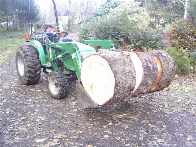

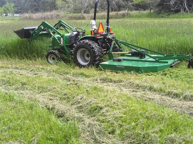

Hey, another 2740 owner.:cool: Yep, the service intervals you were given above are correct. Mine is almost 3 years old now, with only 201 hours on it, so I change oil and filter at around 50 hours or so, which is at least once a year. I lube the steering knuckles and loader every 10 hours or so, since lots of my use is in the rain and wet areas. It's been a great little machine so far, with absolutely no problems or issues. We have an excellent dealer here also. I found that all the filters I need are in stock or available overnight from the local NAPA store. Here's a couple of pics of the upper limits of its capability.....Dan.

Loaded rear tires? No, I thought about it, but quite often carry a lot of weight on the 3 pt., so usually hang something heavy on the back when I use the loader. Seems like the 2740 is pretty well balanced front to rear unless you get carried away with the loader...Dan.
