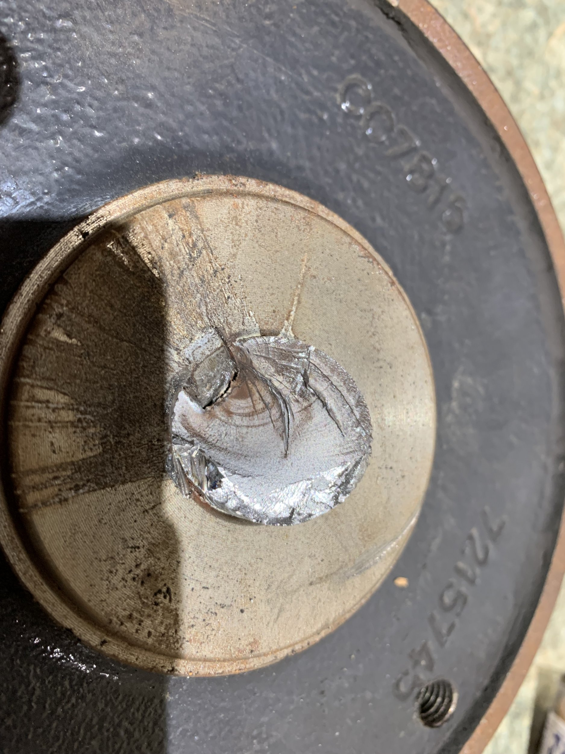

It was indeed easy to access, unfortunately when I removed the cover the belt was intact but the broken end of the hydraulic pump and the drive pulley was lying in the bottom of the housing. :cry:.
As I mentioned I heard a lound mechanical hammering noise right before the lights went out which I now believe was the pump locking up

that sure sounds expensive, I would have figured the belt would be squealing if the pump was locked up, for a pump to fail that quickly there is more of a issue than the pump, wen you say broken end of the pump you mean the shaft sheared?

Yes, I am certain very expensive. The belt is strong enough to kill the motor without slipping if you charge into a dirt pile so it holding up instead of the pump shaft doesn't surprise me.
I am no metalurgist but I am old enough with an industrial background to have viewed many twisted off shafts and this has a different color in part of the fracture that suggests it may have been fatiguing before the failure.

have to agree the failure is looking like it has been cracked/flawed for some time, my old series A would stall many times when grading and took too much bite, the 2019 model is beefier but has stalled and I would be pissed if stalling caused a shaft to shear.
you can likely replace just the shaft and seals way cheaper than full replacement but suspect a real pain getting it off
