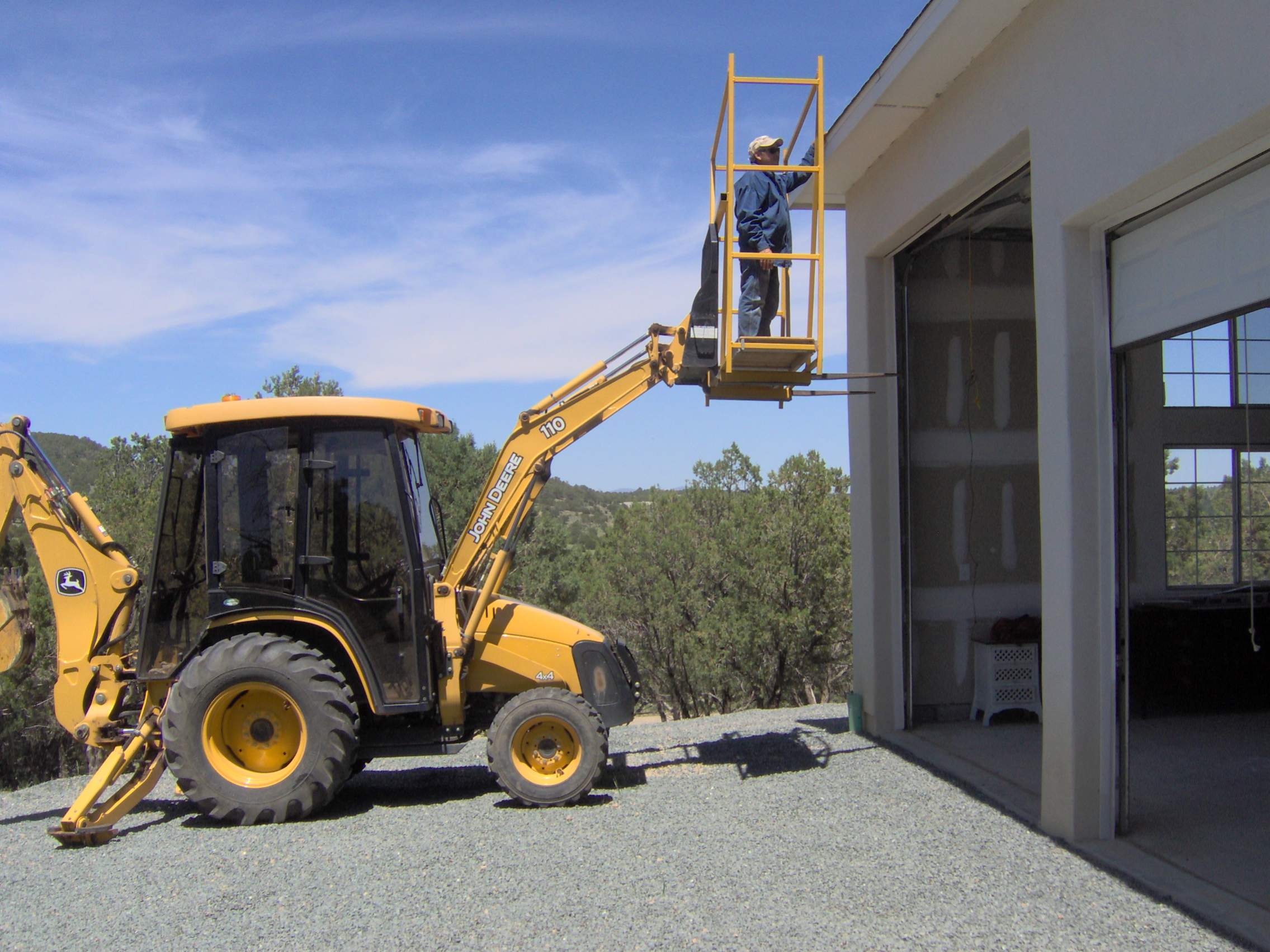

I bought my 110 with a Laurin cab in 2005, been a good machine so far.
