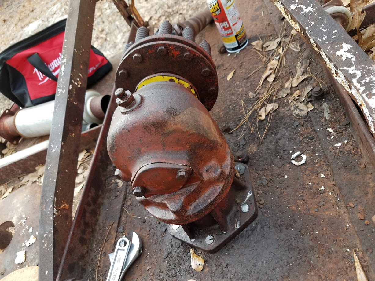

Here is the gearbox I'm working with, the parts diagram I'm finding don't have the plate on the rear.

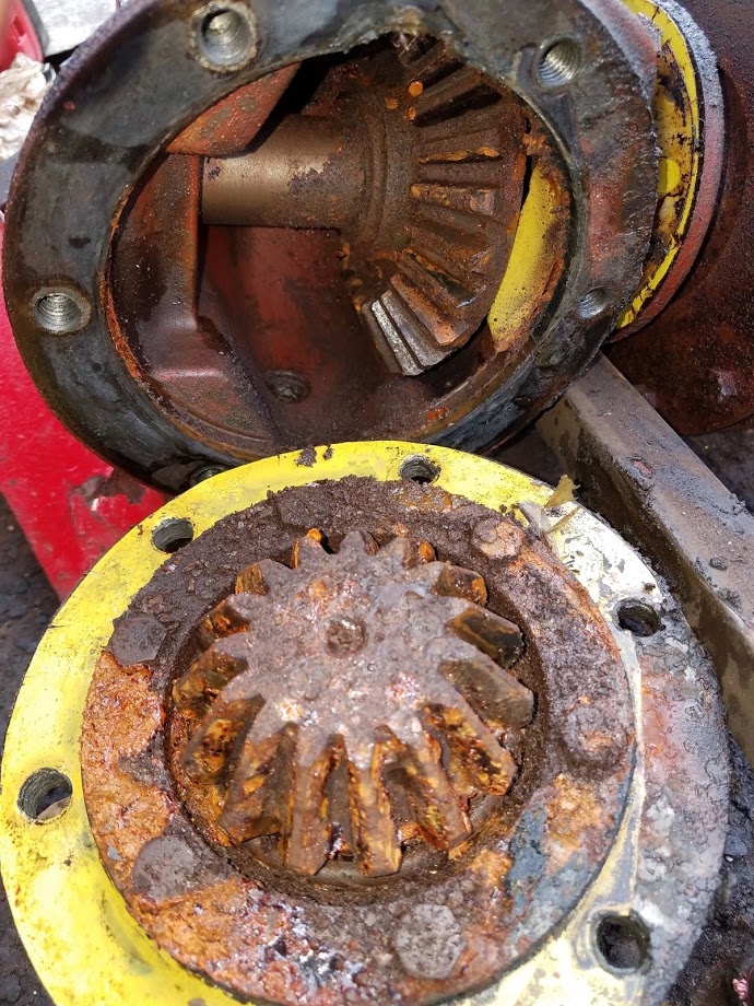

This is when I first popped the gearbox apart -

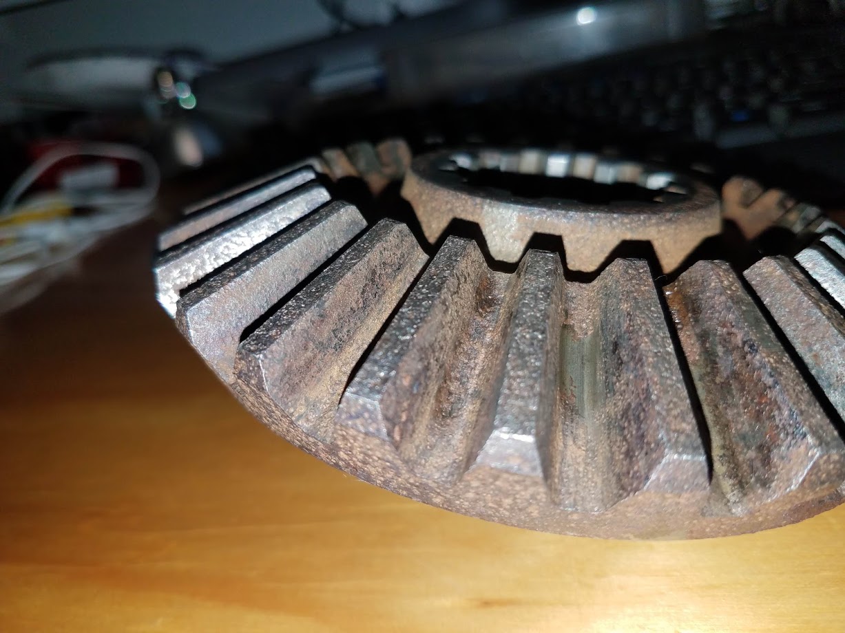

Gears cleaned up kinda -

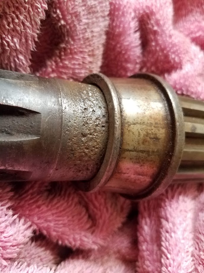

Shaft that needs TLC before oil seal even has a chance -

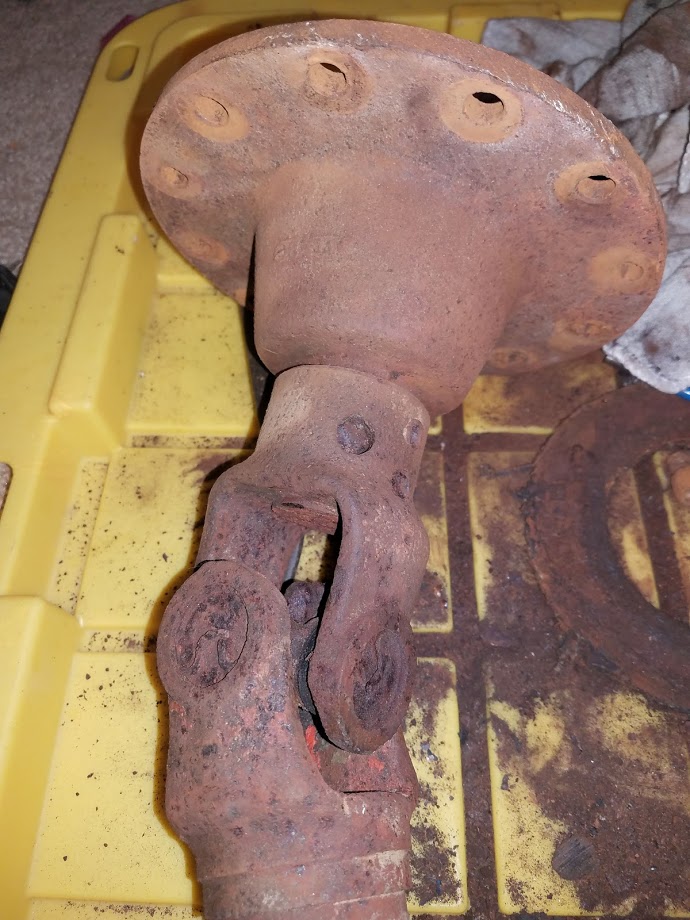

Another question - Does anyone have any idea how to get this yoke off this shaft? If there are set screws that would use an allen key, they are completely rounded off or corroded away to the point where they are just round inside.

Suggest a speedy sleeve on the input shaft once cleaned up
Not sure on the yoke, might just need a lot of heat

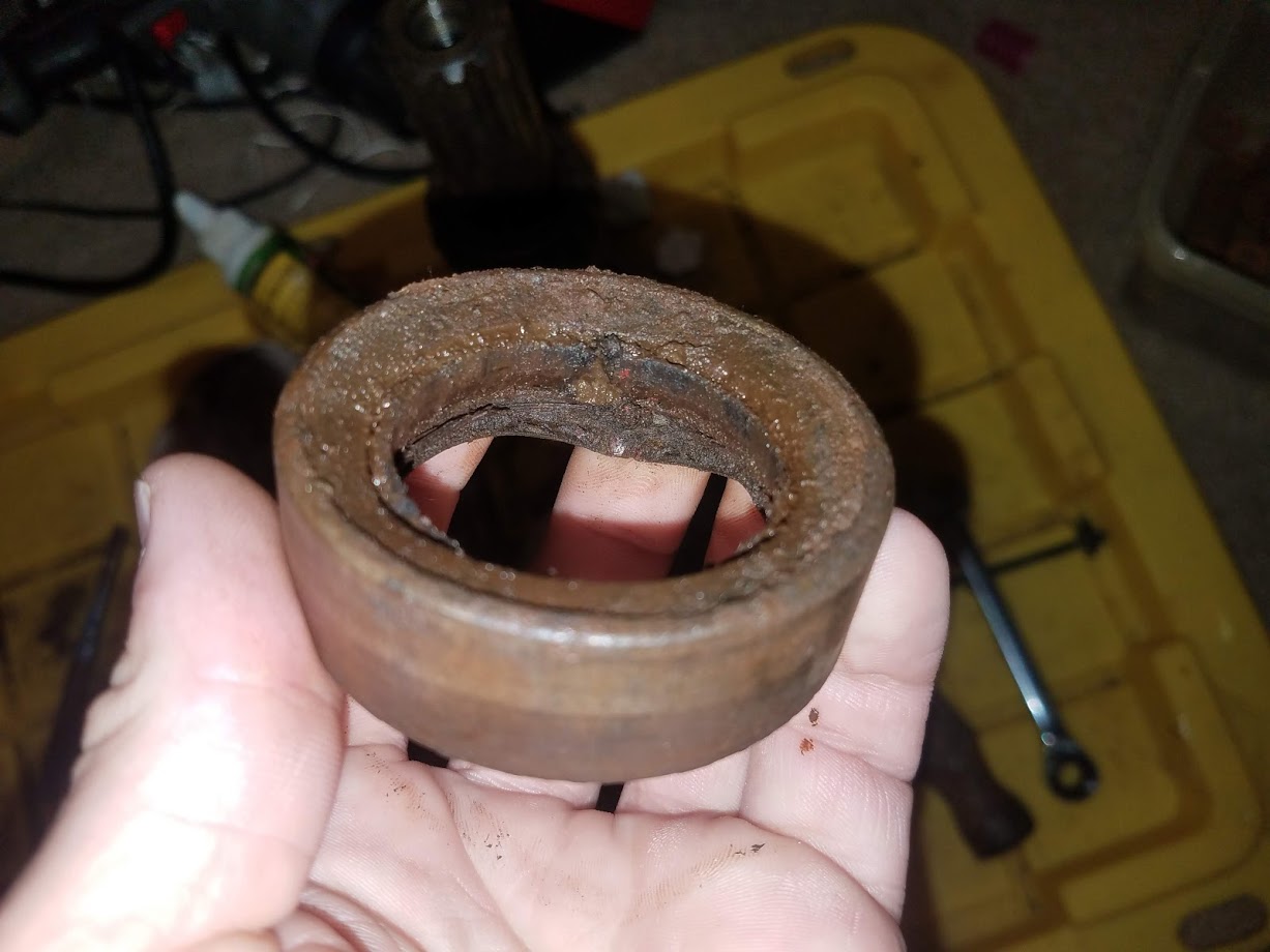

I would be ready to pull the trigger on the parts order but cannot for the life of me find this oil seal thing online. There are two oil seals I need, I'm focusing on one for the moment.
I can't find any oil seal with over 3/4" width that is even close to being for this shaft and outside diameter. I'm beginning to wonder if this particular item isn't considered an "oil seal" and is under some other part label.
OD is 2.437"
Shaft is 1.625"
Seal width is around .775"
Any help would be greatly appreciated.
   / Sentimental Long 502 Bush Hog restore? #4
Look for a local bearing and/or seal place (Bearings Inc and others). Most don't advertise so have to do some looking. They should have enough info to figure out a replacement.
