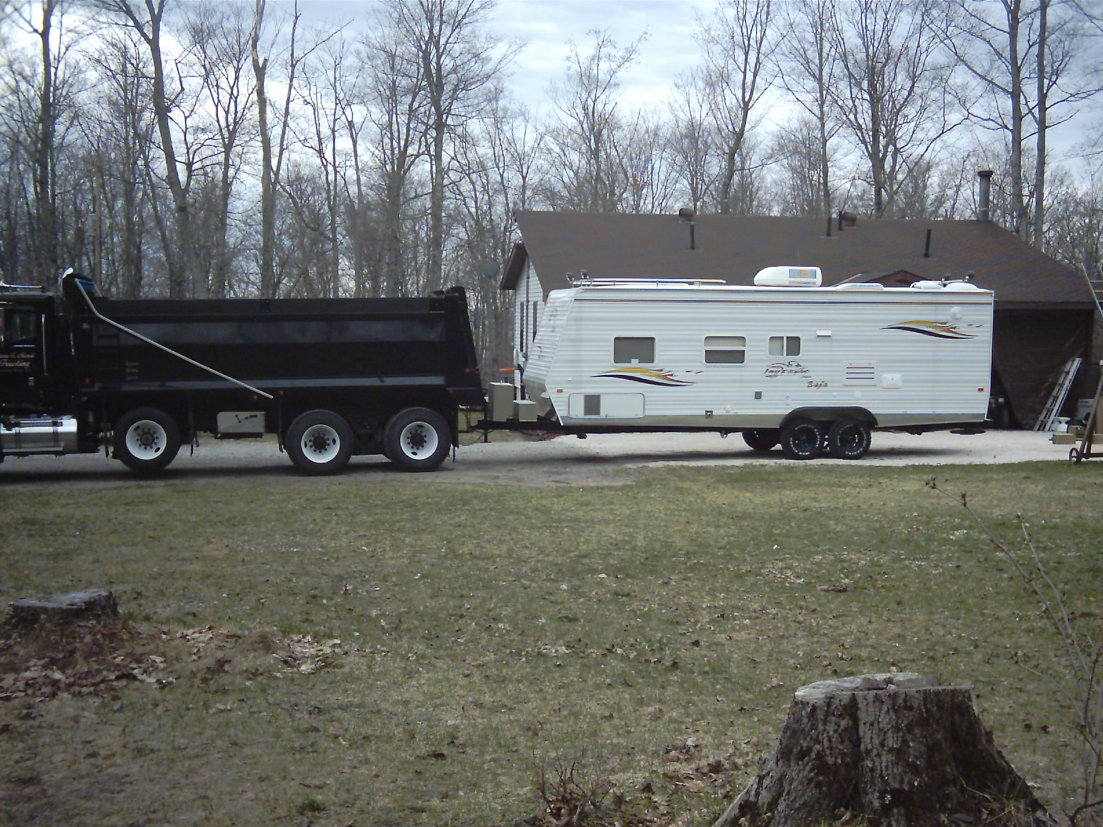

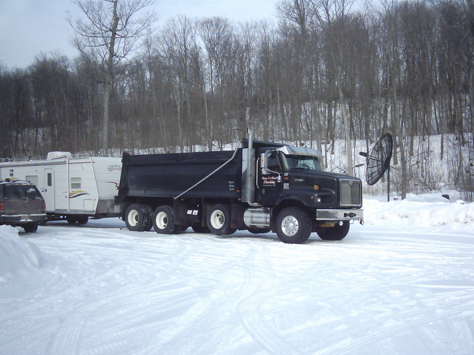

I did the same in 2005 to the Paystar in my avatar. I used to pull my travel trailer when I worked out of town. Had a local machine shop make me the bar that ball goes on to. Since I needed it extra long to clear my dump box I had them make it out of solid square tubing so that it didn't flex. Mine was flush on the pintle plate though, and gusseted on the inside as I have to back up flat to asphalt and shoulder spreaders.
