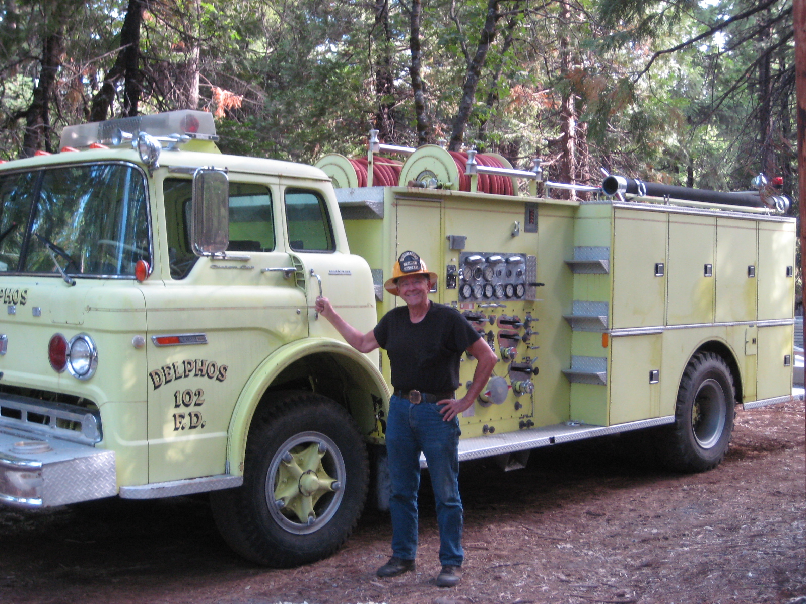

   / Semi rural living - Fire safety & water provision best practices #16
When I lived in the Santa Cruz mountains, I had 10,000 gallons of water and 4" hydrants in two locations that I could use, all gravity feed at 50 psi. You are not at the fire risk that we were with 6 months (give or take) of no rain at all and sitting in the middle of a mixed redwoods and hardwoods forest/woods. I could not even begin to get homeowners insurance.
Now I live in the Cascade Mountains of northern CA and we get 60 to 70" of precip a year, but still have four or five months of zero rain and sit in the middle of a pines/firs/cedar and oak forest with just a tad less fire danger than before. Some people never learn. I'm only a mile from a CalFire station that is manned year around but still, what I did is buy a running pumper with a sound 750 gallon water tank and 200' of 1" hose for $1500. I keep it full all fire season and keep Barricade handy to hose down the buildings in the event of a wildfire.
I will be adding two 2500 gallon poly water tanks to keep the pumper fed during a fire as well. Home Depot has good poly tanks for under a grand.
